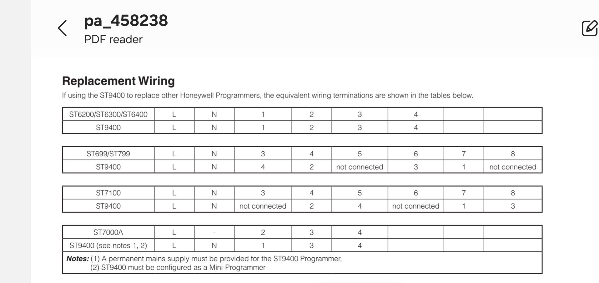

Replacing ST699 with ST9400C
As you have mentioned , I can try changing setting in 'installer mode', but before that how will I feed port 3 in ST9400C and should I still discard port 8 in ST699
EDIT:
Having looked at the ST9400c instructions, if part gravity / part pumped is the type of system you have. It appears that it may be possible to configure the ST9400c as a Mini-Programmer to make it suitable by changing the Installer Parameters to select it. However, the wring will need to be changed so the function of each of the cables you have will need to be identified. Here's the comment from the ST9400c instructions:
"3. It is recommended that gravity circulation hot water systems are fitted with a suitable hot water control valve as shown in the Sundial C-Plan system. For systems installed without this valve, ST9400can be configured as a Mini-Programmer. This is done within the Installer Mode (see page 3 for details). Refer to Honeywell for details of suitable wiring schematics."
Later I would configure ST9400C as Mini-Programmer

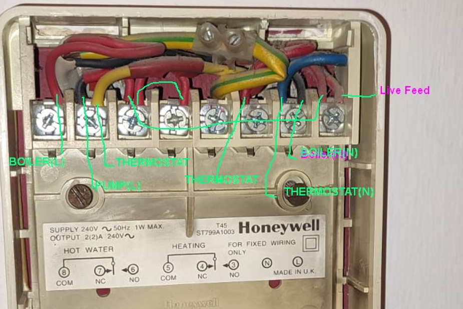

Hi, Since Last time my existing ST699 worked after cleaning terminals, now it's not working. I have attached complete wiring diagram. Can someone please confirm if it's correct.
Not the best diagram to follow

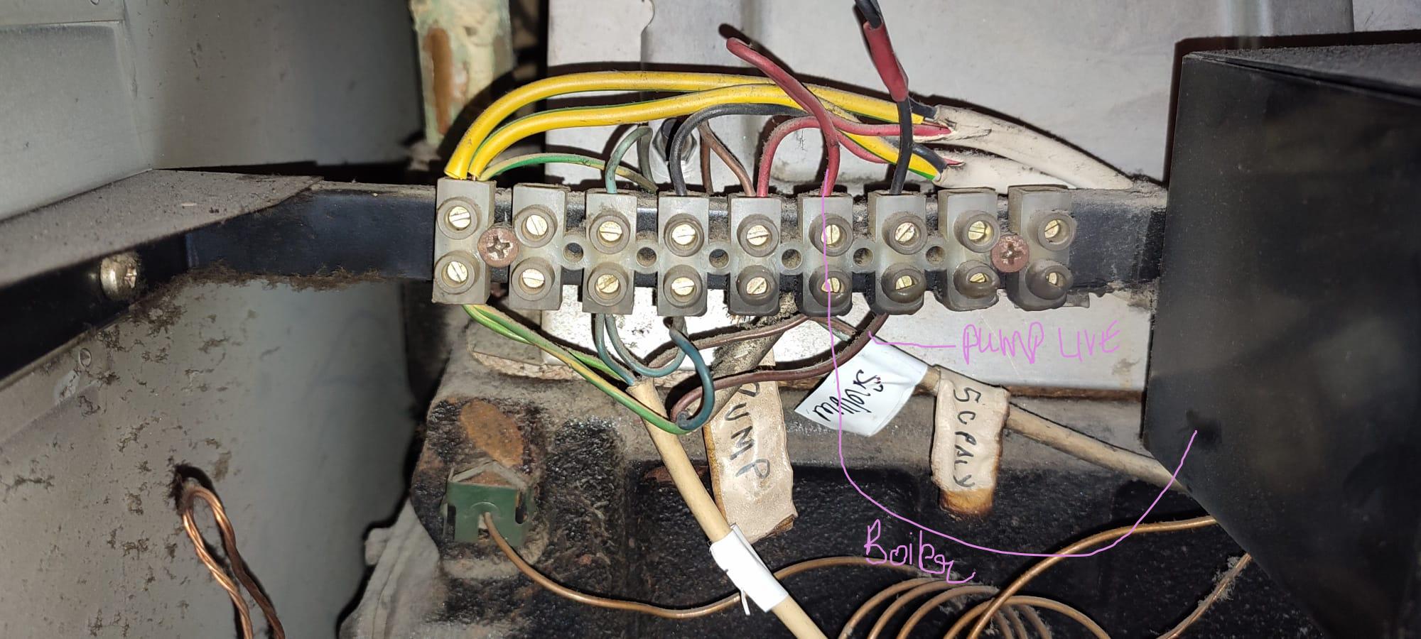

I have checked the wiring in Boiler and located back to the controller before marking in my previous post
I am not entirely sure then, because if you look at the wiring diagram on the ST699 8 clearly states Com and number 5 - which is linked to 6, which is NO for hot water. Unless 8 is a live from the boiler?

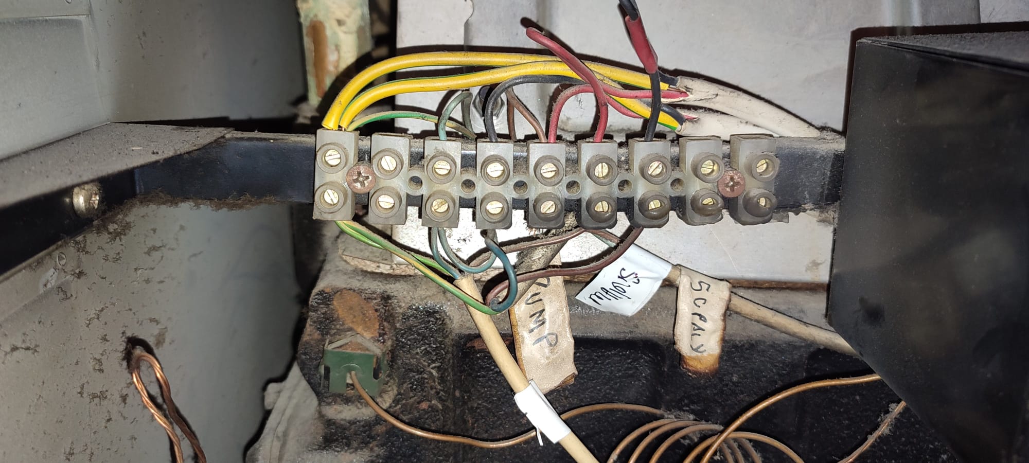

Yes, even that is puzzling me. rechecked the wiring in boiler
Yes, but at the boiler end, you have a LNE and brown (usually Live) going to that red (live) which goes to the St699. Maybe wire as per instructions, disconnect or place in a wago/terminal block and reconnect if not functioning properly?

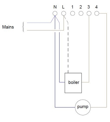

There should be 3 cables entering the programmer, but you need to confirm where they go. I have come across all sorts of bizarre wiring arrangements in the past. I would expect to see.
1. Mains Supply
2. Cable to Boiler
3. Cable to Pump
Once you have identified the cables
1. The mains supply is quite obvious N & L
2. The Live in the cable to the boiler goes to HW On (3)
3. The Live in the cable to the pump goes to CH On (4)
The earths and neutrals of all the cables are connected together respectively. (earths omitted for clarity below :) )
Some boilers require a permanent live (shown by the dashed line) if yours needs it, it will be connected already and shown in the boilers installation instructions.
I suspect the pump cable will contain a live wire that originally went to ST699 'Heating On' (Terminal 3) and the cable to the boiler will have a live wire connected to 'HW Com' (Terminal 8.) But check to make sure.

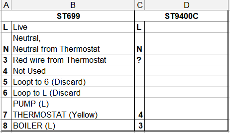

Hi Stem, Going back to this thread, I have identified all the cables as below and just need to confirm 2 points
Is PUMMP(L) & Yellow from Thermostat go in 4 (ST9400C)
Existing 3 (Red from Thermostat) - where does it go in ST9400C
