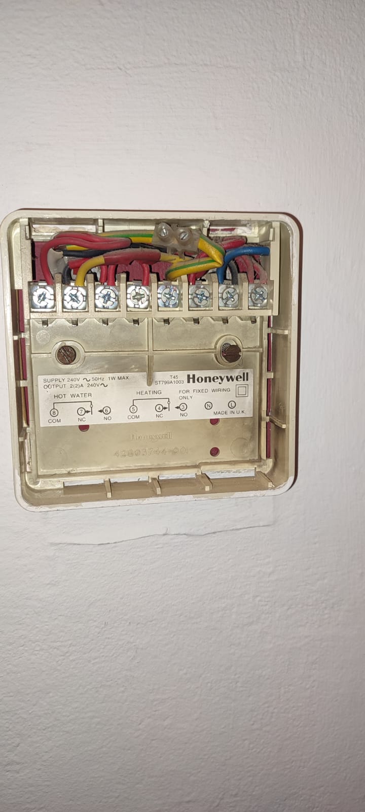

hi I have just replaced the honeywell st699 for a honeywell st9400c
I have followed the wiring diagrams but the heating comes on with the hot water even though I have programmed it not to.

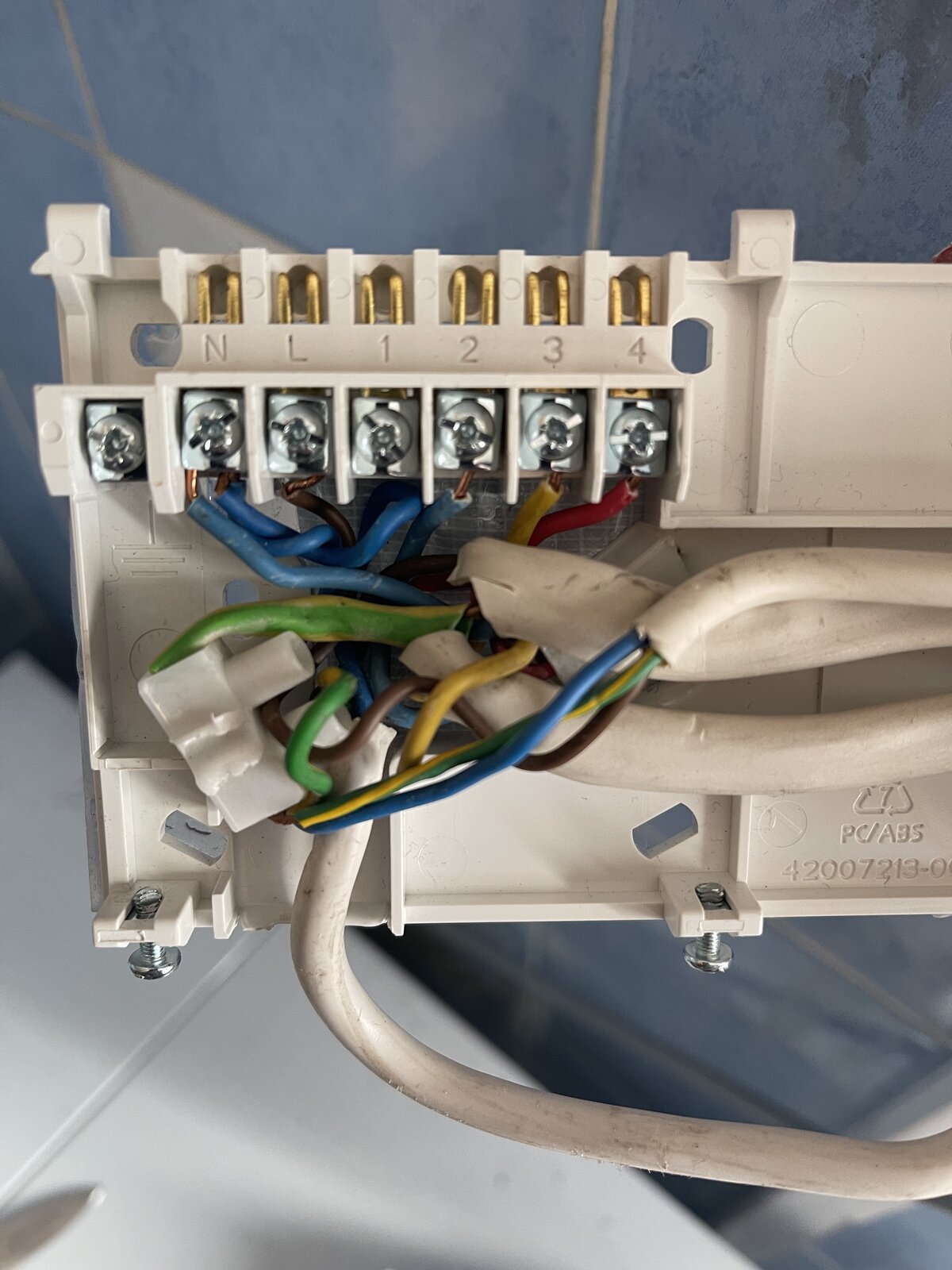

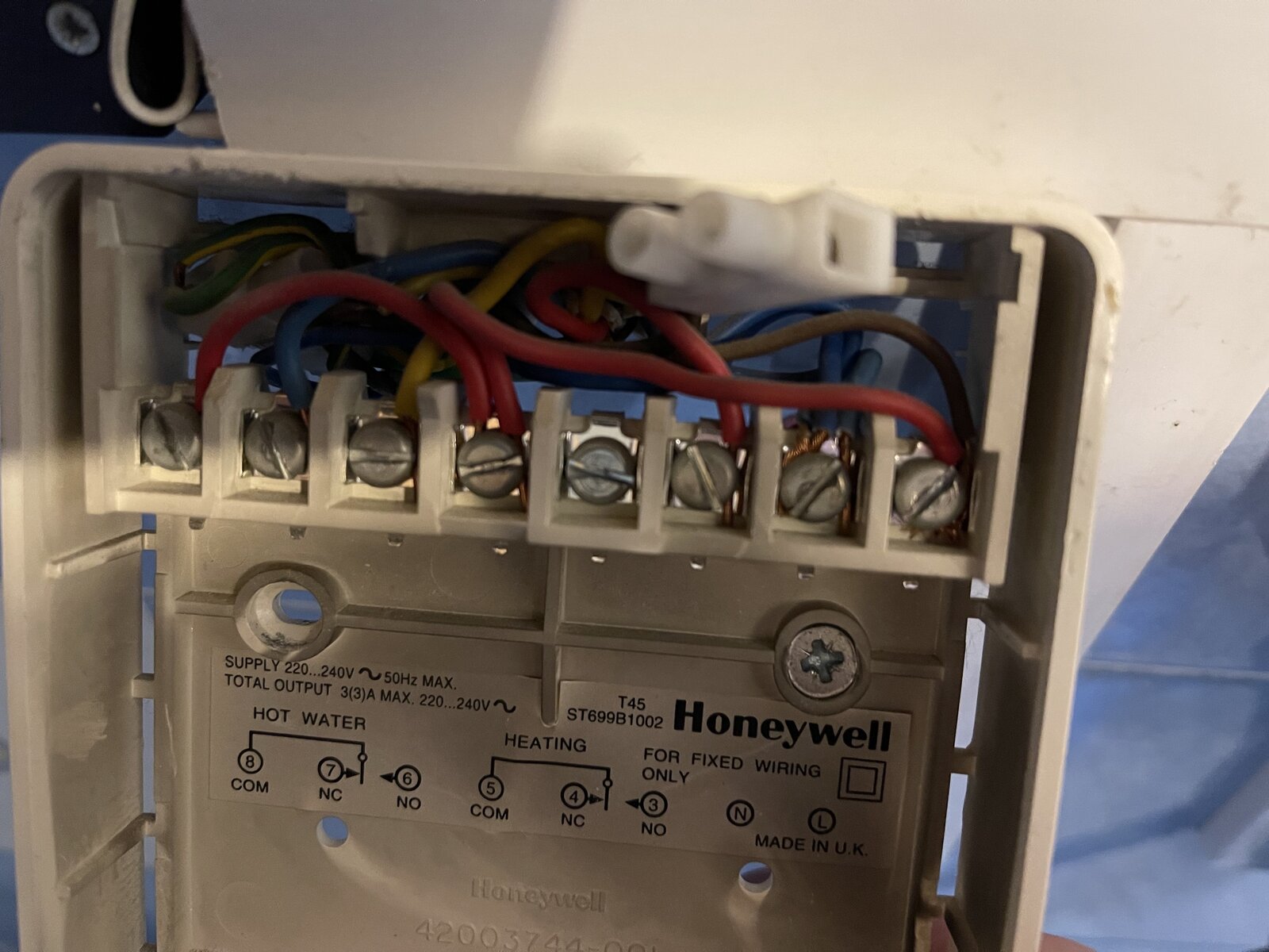

Hi, All I am replacing below ST699 (currently connected with Thermostat and Kingfisher Potterton Gravity boiler) with ST9400C . Need some help with Wiring Diagram.
Currently
There is a loop between 5 & 6 >> This need to be discarded ?
From L there is loop to 6 >> Should I use feed from L to connect to 3(in ST9400C) ?
While swapping:
ST699 - ST9400C
L - L
N - N
3 - 4
6 - 3
7 - 1
8 - What should I do with this ?
Any help would be much appreciated.
