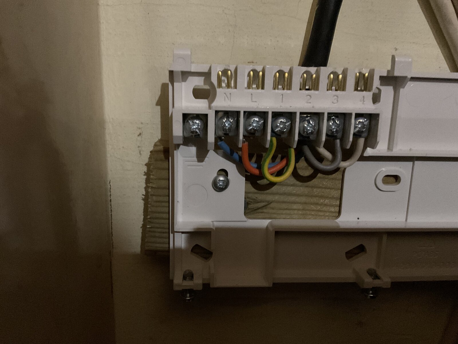

Hi, I decided to replace my old ST699 programmer with a ST9400c. I followed the attached diagram but I have no CH off wire. The CH now runs constantly even on the timer. Any ideas Please?

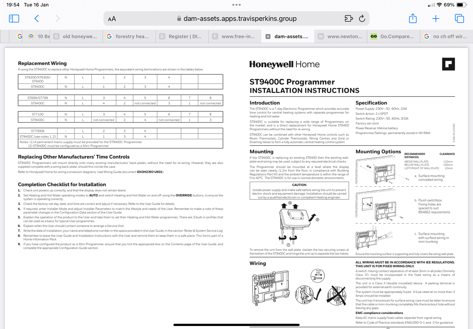

Sorry, here you go.

You don’t need a heating off, only hot water off, which is your incorrectly used green/yellow. It could be your 3 port valve has failed coincidentally. Are you able to wire the 699 back in to test?

Following the Honeywell replacement wiring diagram it shows the green/yellow wire from 7 to 1. Is there a reason why it should be in 2?
It shouldn't be in T2 as @CBW CH terminal 2 'CH Off' isn't used, it wasn't used on the ST699. Terminal 4 was vacant.
The connections also look correct to me:
Green / yellow wire used as HW Off [ST699-T7] =[ST9400c-T1]
Dark Grey wire used as HW On [ST699 -T6]=[ST9400c-T3]
Light Grey 2 wire used as CH On [ST699 -T3]=[ST9400c-T4]
Blue wire = N
Red wire = L

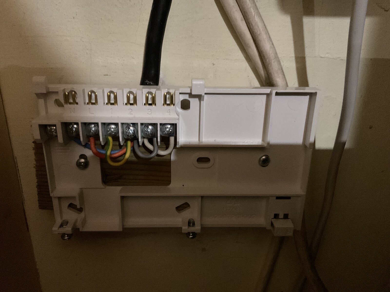

Ok, having taken off the faceplate to take a photo of the current wiring, it all seems to be working ok now.
Fingers crossed it stays that way, if not, I’ll be back!
Thank you for the help.
