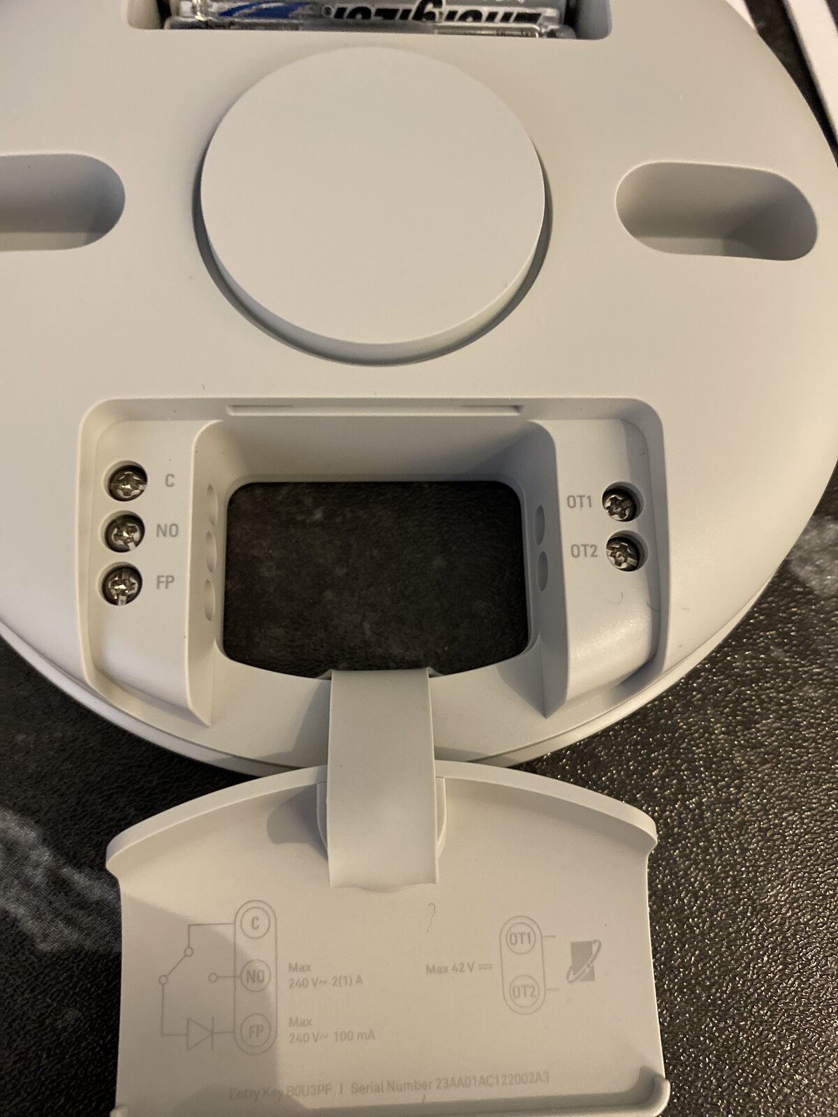

ey everyone I’d like to say first of all I hope everyone is staying safe !

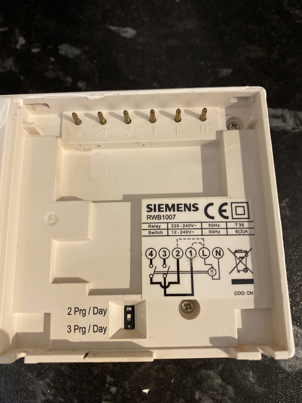

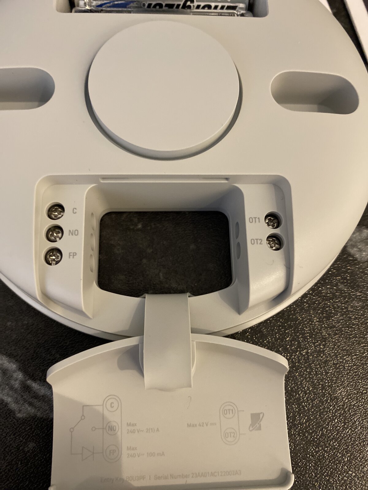

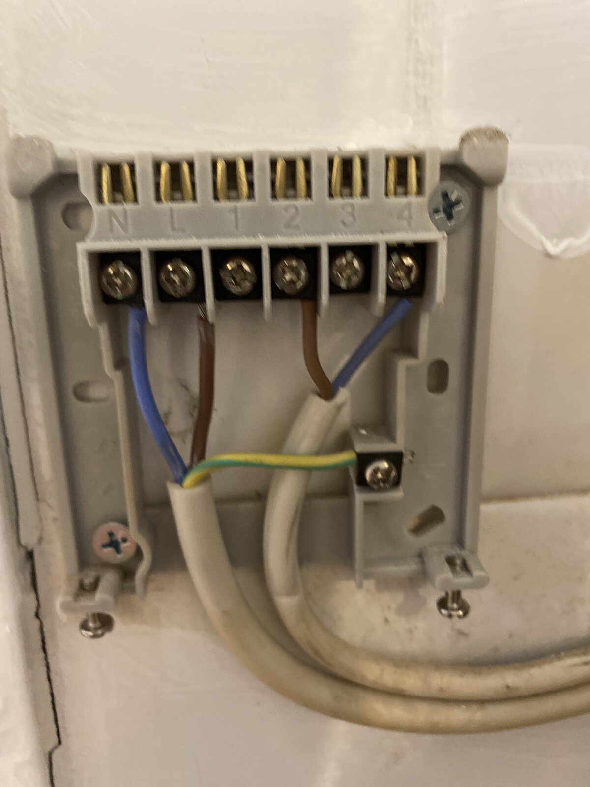

I’ve recently moved into a flat with a Siemens RWB1007 (to switch my heating on and off ) and my boiler is a Glow Worm I had to upgrade to a Nest Thermostat E and I’m trying to wire it up myself , I’ve basic knowledge of simple things and I was told this was easy but ... I’m struggling and to avoid hassle from the wife and kids I’m wondering if you could help me ?
I’m just wondering with the 5 wires behind the Siemens and the 5 spaces in the nest if I post some pictures of what I have can anyone help me wire this and if it’s not the easiest I’ll need to call for help
thank you again

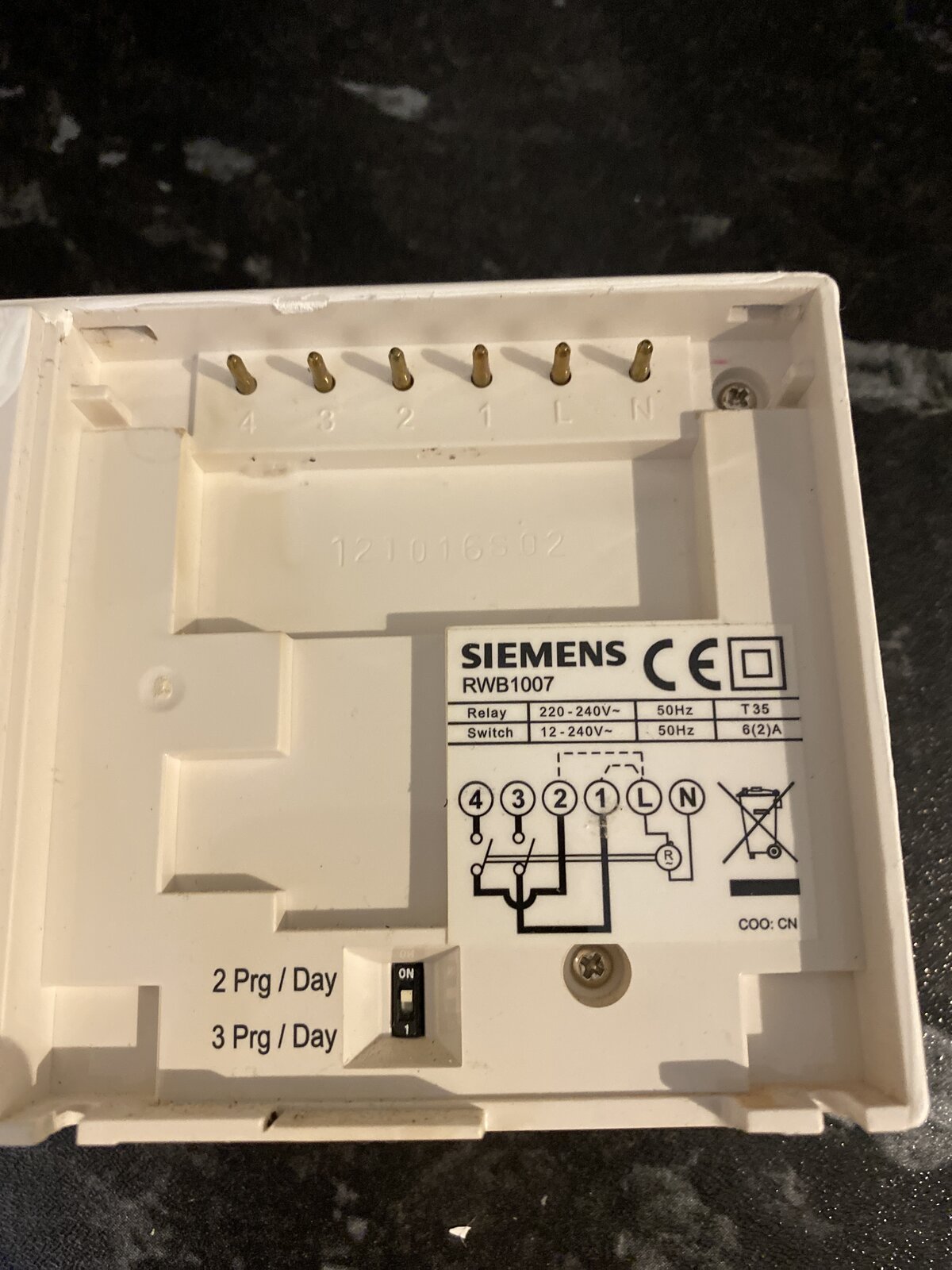

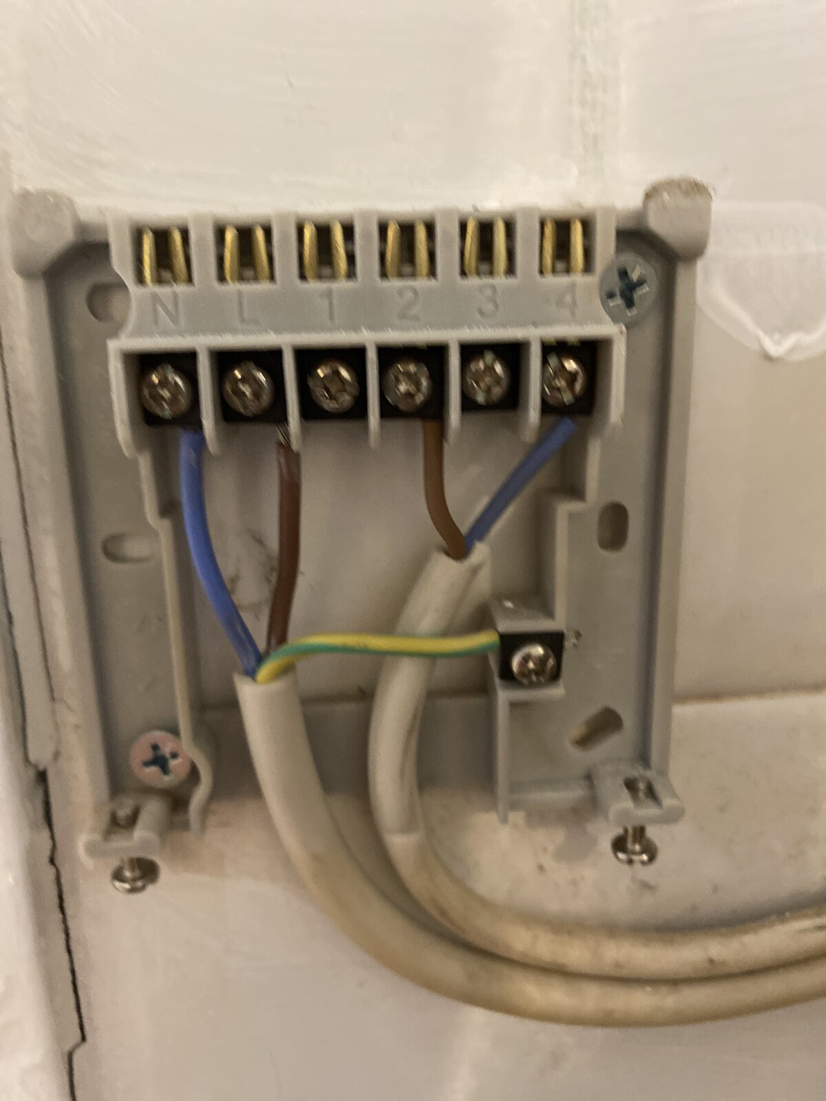

The Nest-e is battery powered so the N and L presently connected to the RWB1007 are not required. They should be insulated / isolated and tucked safely out of the way. Then the wires in the timeswitch terminals '2' and '4' go to the Nest-e 'C' and 'NO'.

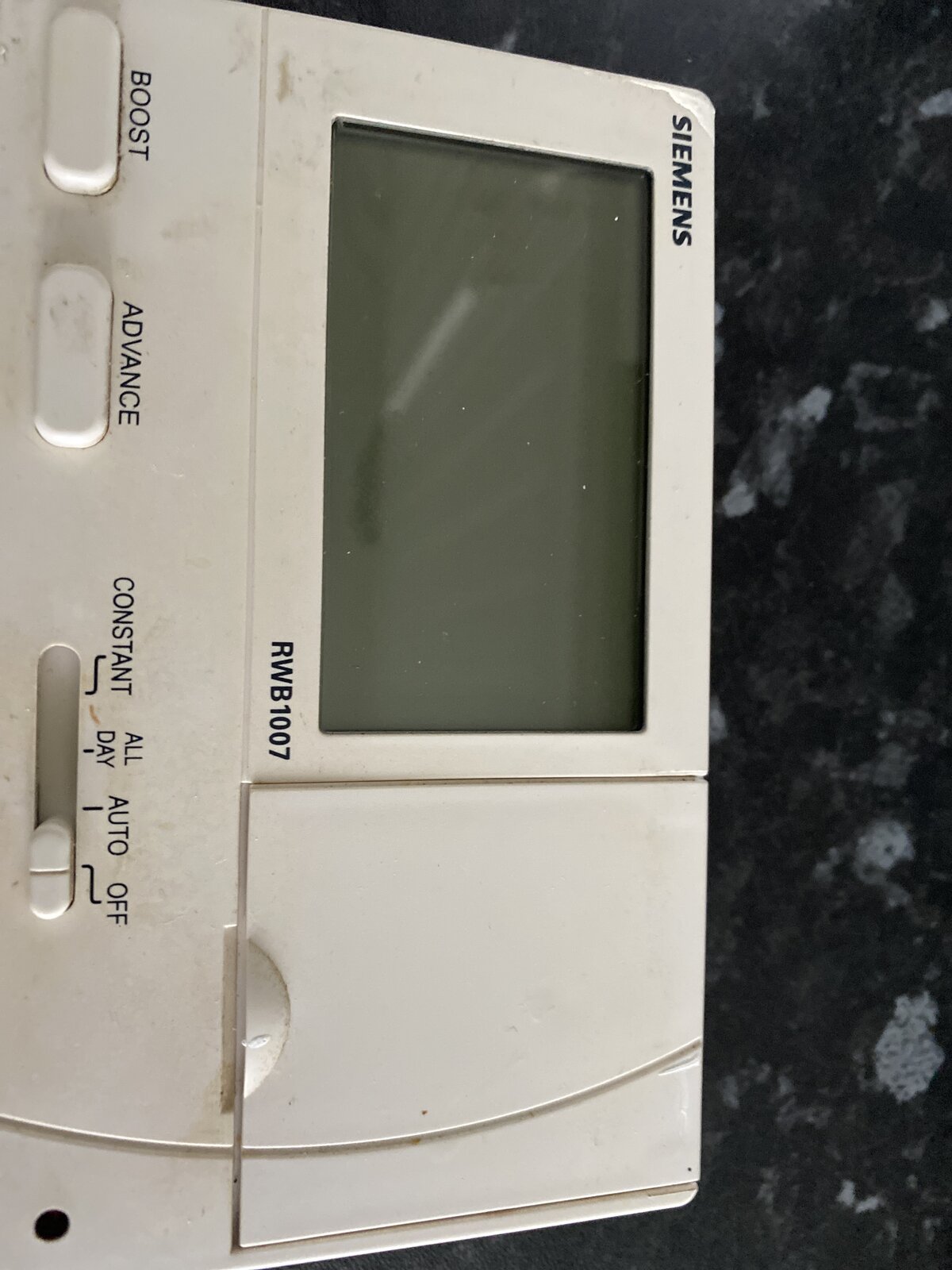

The RWB1007 is only a timeswitch, you don't mention any existing room thermostat, but if you have one it will either need to be left in place and set to maximum so that it doesn't interfere with the Nest, or removed and a small wiring modification made to complete the circuit. The old thermostat can't just be disconnected.....But if you haven't got an existing room thermostat then you can ignore this part.
Thank you :) I don’t have thermostat just the time switched on and off with boost and a clock on it the one with the 5 wires
That’s the one I’ve taken off to reveal those wires sorry

If the boiler has OpenTherm then you really want to use it, if the boiler does not have OpenTherm then just to two wires already shown. I can also modify post.
