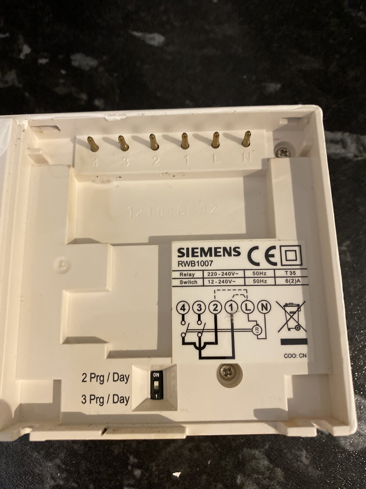

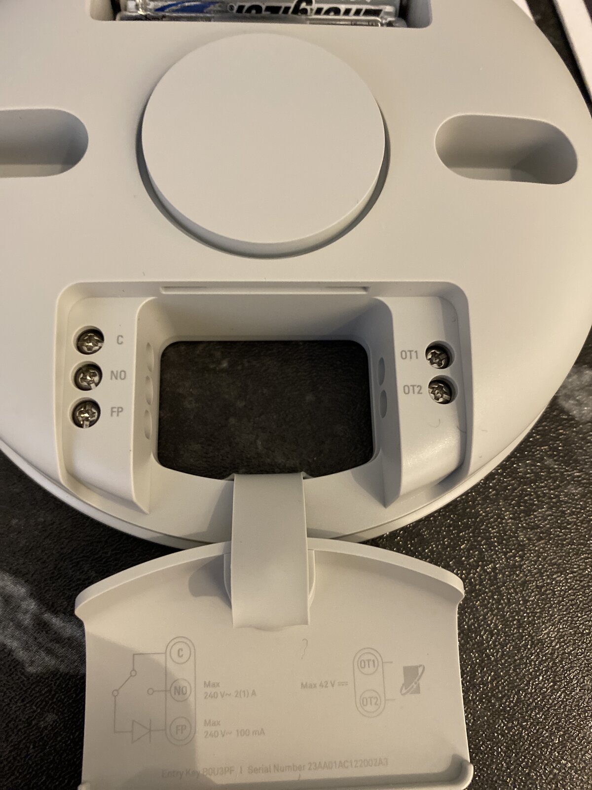

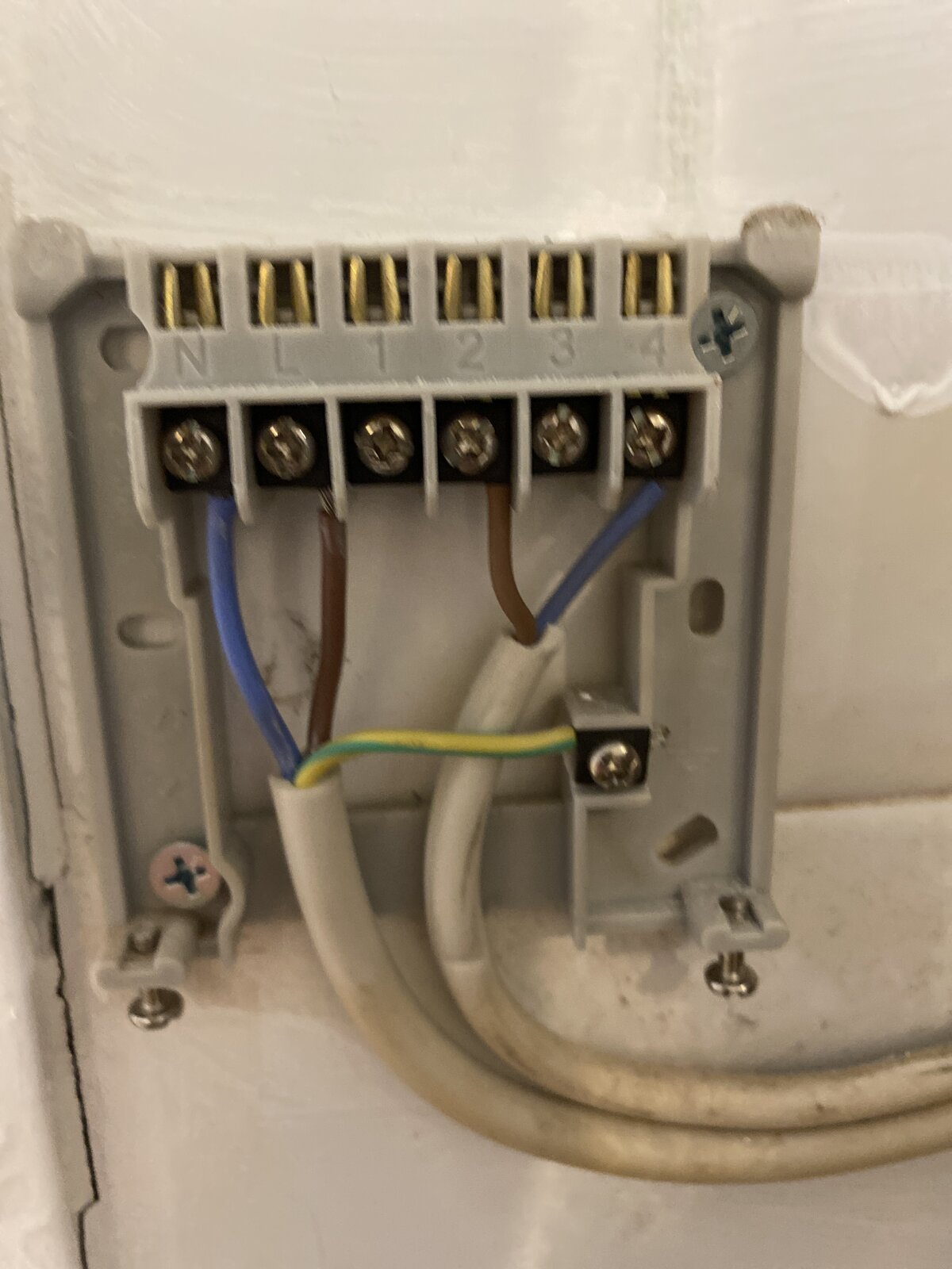

I’ve recently moved into a flat with a Siemens RWB1007 (to switch my heating on and off ) and my boiler is a Glow Worm I had to upgrade to a Nest Thermostat E and I’m trying to wire it up myself , I’ve basic knowledge of simple things and I was told this was easy but ... I’m struggling and to avoid hassle from the wife and kids I’m wondering if you could help me ?
I’m just wondering with the 5 wires behind the Siemens and the 5 spaces in the nest if I post some pictures of what I have can anyone help me wire this and if it’s not the easiest I’ll need to call for help

So 2 -> C
4 -> No
