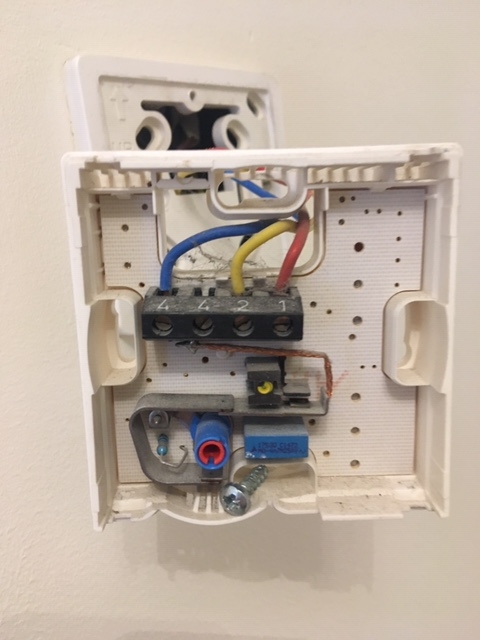

OK people 1st time post after trying to search and resolve my issue. Hopefully someone can point me in the right direction.
My set up is an S-plan system with a Potterton Suprima boiler located downstairs with CH and HW time control integrated within the boiler housing. Honeywell L641A1039l cylinder stat and a pair of Myson control valves located within the airing cupboard. The CH room stat is located downstairs in the hallway, sorry but I don't recall the make and model but picture to follow. The wiring centre is via a Honeywell Sundial junction box located in the airing cupboard. With this set up there are no problems with the system and all is working as it should be.
After installing the Nest Heatlink and Thermostat I'm having issues with controlling the heating system correctly. With the hot water disconnected within the Nest thermostat setup I can control the heating system without issue. With the hot water set to on/off within the Nest thermostat the heating system runs continuously e.g. thermostat set to 18 and showing room temp as 25 but system running with CH 2 way valve open and boiler running along with pump. Before I get to engrossed with the Nest system setup via the thermostat can people take a look at my wiring to see if there are any apparent errors.

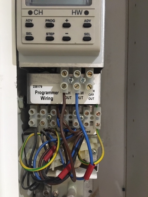

Original time control within boiler housing

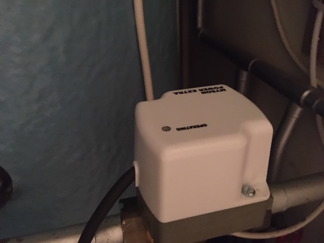

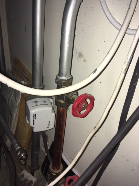

CH 2 way valve
HW 2 way valve
Room stat in hallway original wiring

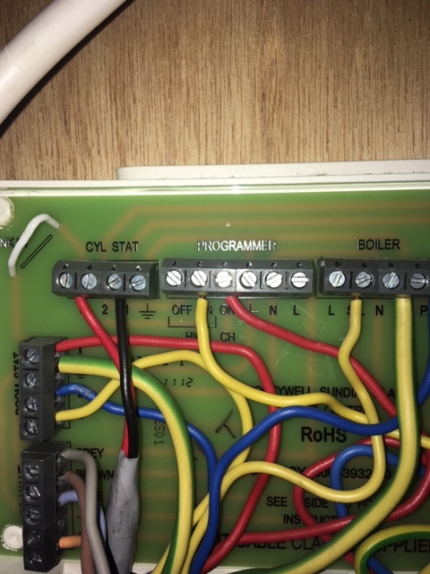

Honeywell Sundial wiring centre (original setup)

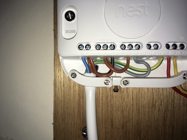

Nest Heatlink wiring

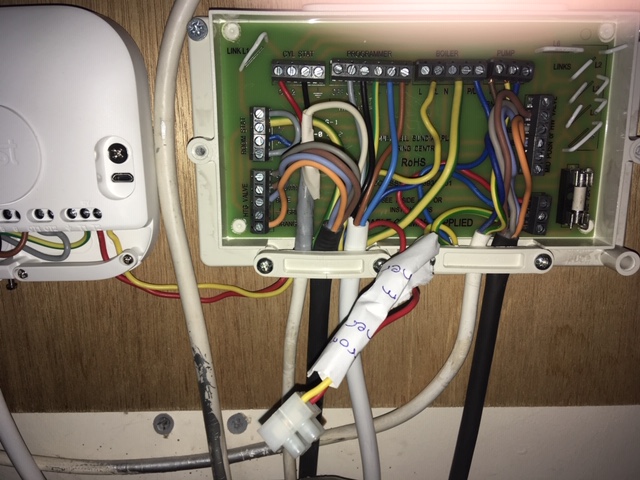

Honeywell Sundial wiring centre new setup

Original time control wiring at boiler left as is at boiler end and control turned off. The time control wiring at the Sundial wiring centre has been removed from the programmer terminal and made safe within a new terminal block and kept seperate.
Original room stat wiring red goes to T1 in heatlink, yellow goes to T2 in heatlink, blue is blocked off at room stat but left where it is in the Sundial wiring centre. Earth left in metal box behind room stat and as was in Sundial wiring centre. Terminal 1 and 3 for the room stat wiring linked together (grey wire) in new setup at the Sundial wiring centre.
The Nest heatlink is wired as follows
Blue N goes to Sundial programmer terminal N
Brown L links to 2 and 5 and goes to Sundial Programmer terminal L
Black 3 goes to Sundial Programmer terminal CH on
Grey 6 goes to Sundial Programmer terminal HW on

First of all well done with the installation of the Heat link wiring and terminations. I've seen "professional" installations that aren't as good as that. I'll excuse you the 12v supply for the thermostat as I assume that's still a work in progress.
However, Heat links are difficult to wire and I wonder if some of the connections are properly made. It's easy to connect the terminals to the PVC sleeve instead of the conductor, I like to see just a tiny bit of copper showing out of the terminal, and I can't see this with all of the terminals. They could be OK, but best to check.
I have assumed the N and L mains supply is OK, and the links between L-2-5 are also in order.

The wires from the programmer here are disconnected [there shouldn't be any connections remaining at these terminals] and instead....
The brown wire in 'CH OUT' goes to Nest Heat link 3 'Heating call for heat'
The blue wire in 'DWH OUT' goes to Nest Heat link 6 'Hot water call for heat'
Alternatively, if you want to simply remove the existing wires from the programmer and run new ones from the wiring centre to Nest, then the new wires would connect to the wiring centre terminals below as follows:
Programmer ON CH = Nest 3 Heating call for heat
Programmer ON HW = Nest 6 Hot water call for heat
Looking at your photos it seems that this is what you have done using the Grey and Black wires from the wiring centre HW ON and CH ON to terminals 6 and 3 at the Heat link.
Assuming that the room thermostat wires here....
....are connected to the wiring centre here:
Then I would remove the old thermostat cable completely and at the wiring centre and inset a link between terminals 1 and 3 where the red and yellow wires have just been removed from. This appears to have been done OK with the grey loop.
And that should be it. No other wiring changes should be made, everything else should be left exactly as it was.

Link 1 in the top left corner of the wiring centre needs to be cut.
I did have a slight concern about that link but that wiring centre was not causing any issues prior to fitting the Nest Heat Link? I would’ve thought my original system control was classed as a programmer. Is that the case? If so then it’s strange link 1 should be cut but all was working ok without it being cut?
Johnmdc is correct. Link 1 joins the heating and hot water outputs together for when there is only a single channel timer used to control both heating and hot water. So one on = both on. Normally I would have checked that, but as you do have a programmer and you said it was working OK before I didn't go looking for existing problems with the wiring centre.
If you had the heating and hot water set to similar 'on' times before, you wouldn't have noticed that it wasn't working properly. However as the programmer heating control circuit has been taken over by the Nest which as well as time control it also includes the thermostat control it has become more obvious.
Previously the programmer heating output would have remained 'on' constantly when the programmer was set to be 'on' now it won't be constant it will be being switched 'on' and 'off' by the thermostat as well now so what was a permanent output will be going on & off as dictated by the Nest thermostat.
Cut that link! Well done @Johnmdc for spotting it.

As well as Link 1 other links should be cut for S Plan. I can't see the photo clearly enough to determine if they are or not.
Ok so it looks like I best go and cut link 1. Now I have visions of me playing out bomb disposal on one of those films on tvo_O keep your ears open for the bang:mrgreen:
Eureka:D:D
Johnmcd you were 100% right. I've cut link 1 and now all is working as should.
