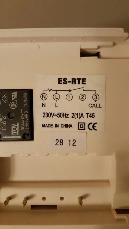

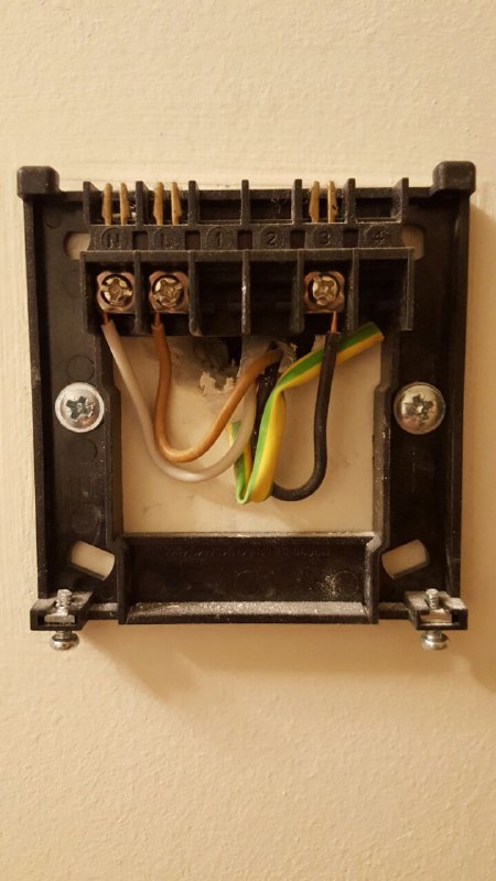

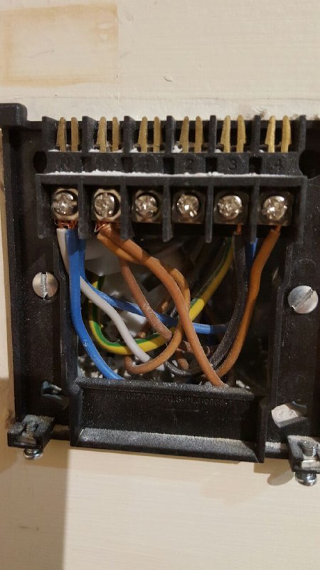

Hi,
Sorry to create yet another Nest thread, I've searched and seen there are quite a few, but none of them quite match my system and I don't really want to break anything!
I have a gas boiler in the kitchen along with a programmer (ESI ES 2-24/7) and a wired thermostat in the hallway. Upstairs in a cupboard there's a hot water tank. I'm pretty sure the system is Y-plan. There's a small junction box with 10 connectors in the cupboard with the hot water tank but none of the connectors appear to be labelled.
From what I've read I think I can just replace the programmer with the Nest HeatLink and the old wired thermostat can be replaced with the Nest thermostat as long as I use the 12v outputs on the HeatLink to power the new thermostat.
I've attached images of the backplates and wiring diagrams for my current programmer and thermostat. The basic HeatLink wiring info can be found here https://s3.amazonaws.com/support-assets.nest.com/images/Amber/a2-cables/a2-cables.jpg
I was going to:
1) Move the grey/brown wires that go between N and L on the programmer and the thermostat into T1 and T2 on the HeatLink to power the new thermostat.
2) Move the 2 wires from the programmer N to the HeatLink N
3) Move the 2 wires from the programmer L to the HeatLink L
4) Move the wire from the programmer CH ON (4) to the HeatLink CH call-for-heat (3)
5) Move the wire from the programmer HW ON (3) to the HeatLink HW call-for-heat (6)
Would this work? If not what's wrong that I need to do differently?
Many thanks for reading.
Matt
