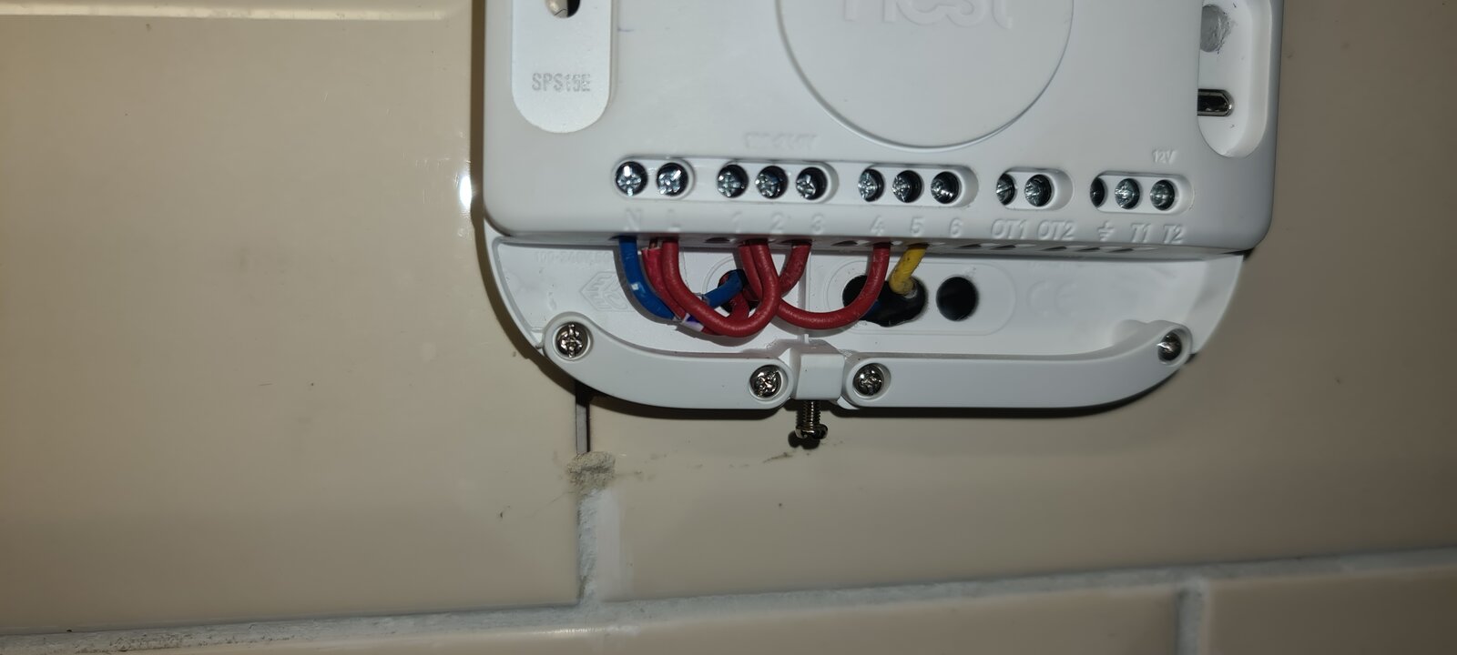

I was wondering if anyone could give some advice regarding my nest. It's been installed for around a year and a half and has been working spot on for all this time.
Today I realised the thermostat was not connected to the heat link, upon further investigation it turns out the heat link has no power going to it at all.
The thermostat is wired via a mains plug and stand so is separate power circuit.

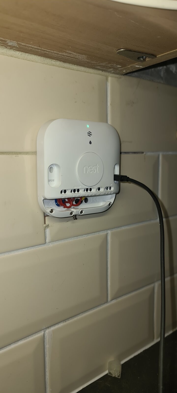

The strange thing is, when I plug a USB power cable into the front of the heat link, the lights come on and the thermostat can connect to it (however it does not control the boiler still when you set it to heat). The heat link replaced an old programmer and used the existing wiring.
Does anyone have any ideas what could be causing the issue? Wiring all looks OK and nothing in the house has changes recently. Not sure if there is a fuse located somewhere that could have blown?

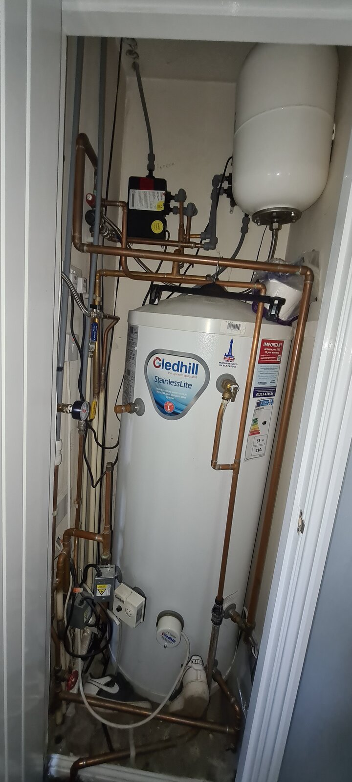

Slightly different to that as we had a loft conversion so we no longer have a tank, we have a cylinder and 2 shower pumps like this photo.

Well, it’ll be powered from somewhere, once found check the fuse, or anything else that might be connected to it.
That's what I would expect. If there isn't a mains power supply to the boiler and Heat link, then when you then supply power to the Heatlink via USB then the lights will come on, however as there still isn't any power to the boiler it won't work.
As Chris says you need to find out where the power to the heating system originates from. Usually there's a fused spur adjacent to the boiler, or the main wiring centre. Something like this:
