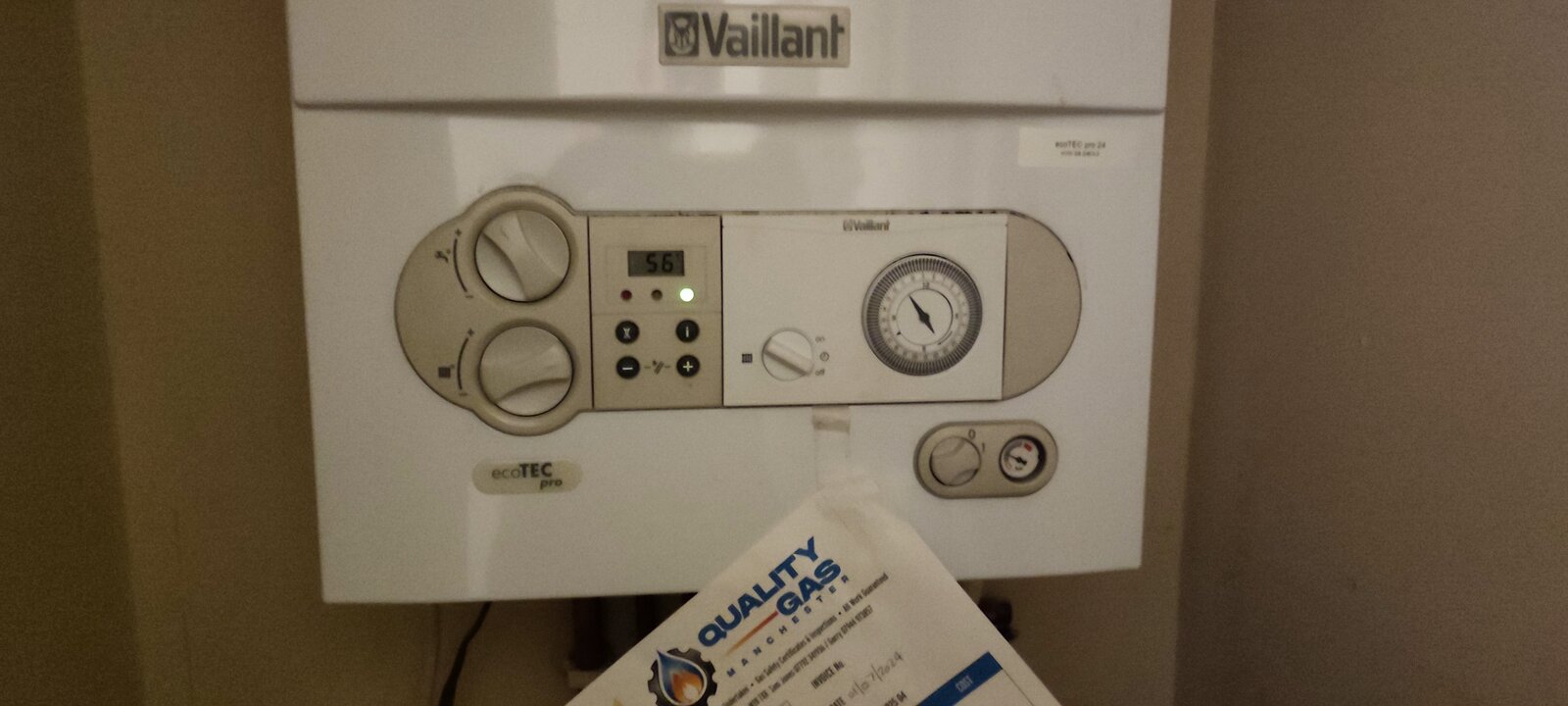

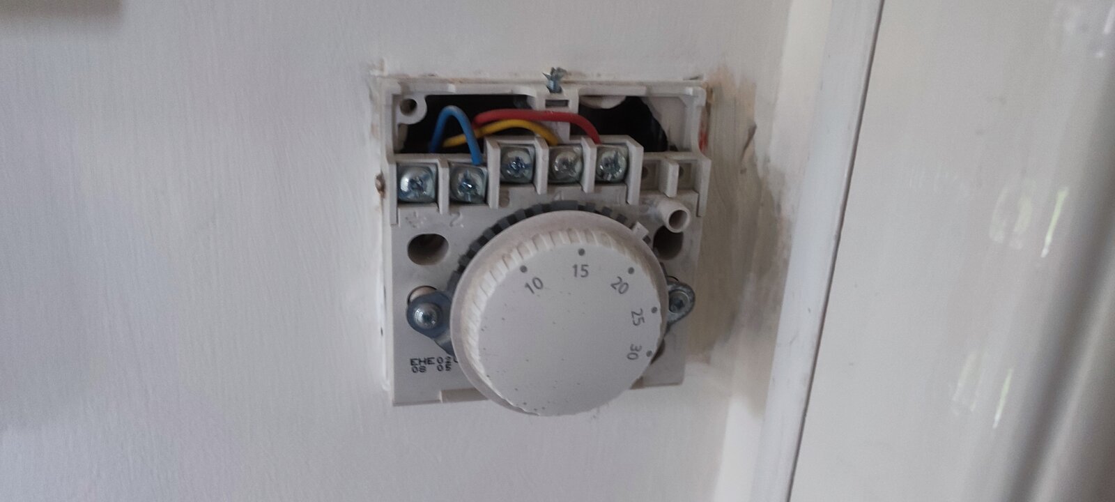

Hi,
I'm trying to install a nest heat link for my girlfriend but can't seem to get the boiler to turn off and wonder if someone can check if I've wired it correctly from the images attached.
Red wire - Common
Blue wire - NO
Yellow - Terminated with a wago
I then set the boiler to the 'ON' position.
The boiler then stays on and when I try to switch it off on the nest thermostat, it doesn't switch off.
I can hear the heat link click on an off when I change it on the nest thermostat, so that's working.
I read this evening somewhere on this forum that the Vaillant combi boiler needs to be set to the Timer and the clock tabs all switched on for 24 hrs on the clock, I haven't tried this yet, but surely the 'ON' position on the boiler would do the same thing right?? I'm not at her property now to test this.
Thanks in advance!!

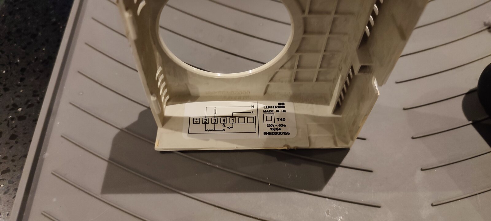

There are a few things that concern me here. In fact it's wrong on nearly every level.
1. Red is usually live, and Blue neutral. [which does correspond to terminals 1 and 2 at the old thermostat as per the nomenclature on its cover] If you have put them in COM and NO then if the Heatlink switches on then it would be connecting the live and neutral wires together. :eek:

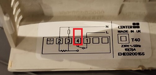

2. The photo you posted of the old thermostat has the yellow wire in terminal 4. Yet as you can see from the diagram below terminal 4 isn't used for anything, there's no external wire connected to it. [Yellow is usually in 3] So, in theory the old thermostat is wired in reverse [On would actually be Off, and Off would be On]
3. The yellow wire is usually the switched live, the one that is responsible for controlling the boiler, yet you have "terminated it with a Wago"
4. Is the old thermostat still wired in, or did you take the photograph before you fitted the Heatlink?
5. You don't say what model of Heatlink you are using. There are several versions. I assume by your use of the name Heatlink that it's part of a Google Nest, but then there are different versions of Nest. The Nest-e is battery powered, but the Nest 3rd Gen is mains powered, so more wiring is involved that just COM and NO.
These are basic fundamental wiring matters, and I suspect that you are out of your depth here and to avoid damaging the Heatlink / boiler / yourself, recommend that you get it installed professionally.
This is the second instance we've seen recently with these dial stats being wired the wrong way around.
In a way it sort of makes sense; it won't operate as a stat, but turning the dial up and the heating turns on, turn it down and it goes off - it could be argued that it's more intuitive!
As in many of these changing thermostat threads, we just have to hope that the neutral wire wasn't connected at the other end...

OP if it was wired such that the red is the thermostat live, and the yellow switched live, then they would be the wires for COM and NO.
