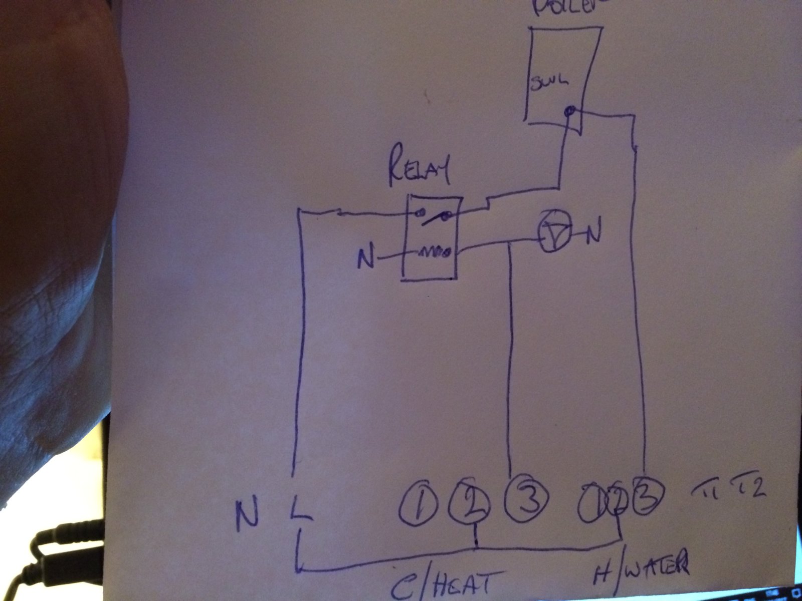

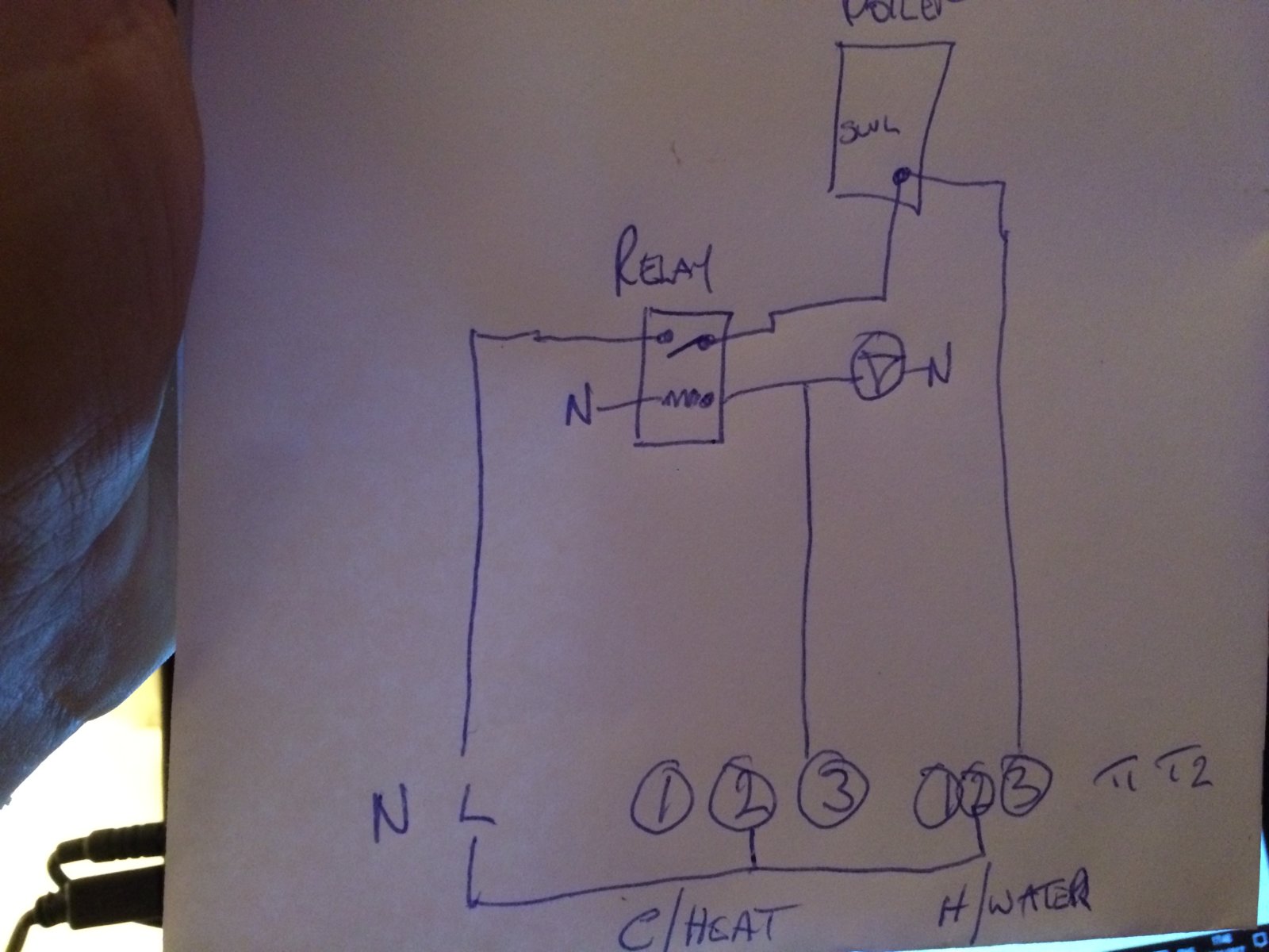

Just wondering if it is possible to have a nest on my heating system?
The hot water runs on gravity only. The heating is on a pump.
For the heating to work the water has to be live too.
There is no valve, on cylinder stat. I know the system is old. I’d just like to have it working with the nest till new year when it will all be replaced.
So I have a live wire for the heating and a live for the water (that also fires the boiler)
So when the heating live is switched, the water live needs to be switched too. How would I wire this on the heatlink on the nest?
You would need to put a relay to operate with the room stat to bring on boiler and pump.
So basically put a relay from the nest to switch both the pump live and water live when it asks for heating? This would then disconnect when heating isn’t asked for.
As below?

You can do it without a relay if you do the wiring to the nest slightly different.
Connect L and N as normal
Link L to 2 and 6 (instead of 5)
Connect pump to 3
Connect boiler to 5 (instead of 6)
Then also link 3 to 4
This way when you just set heating it will fire the boiler up as well as the pump.

Great, I’ll give it a try before using the relay.

Thanks Johnmcd. Obvious in the end but it did puzzle me how to achieve this.
