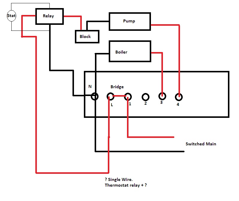

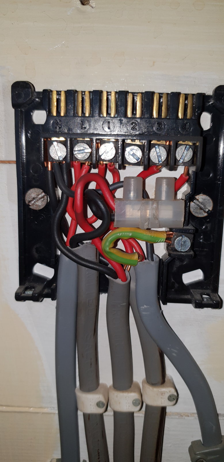

The timer itself is under the stairs and the wiring appears pretty standard (picture attached) but the connector block inside raised my eyebrow. The thermostat is in the hall (always good to relay the hall temperature to heat your living rooms eh) but I can't seem to locate where this terminates. It's a 2-wire thermostat so seems like a very simple unit, I was thinking it's likely connected to a relay?
Is it OK to just connect the wires at the thermostat end and plaster over it? I can only imagine that the wire terminates under the floor somewhere, although it may be behind my fire as it's a back boiler.
Could someone have a look at my current wiring and just check that it's simple enough to swap over using the Nest Link box?

Please excuse the archaic drawing, limited options so i had to stick with paint haha.
Does this seem correct? I'm making a few assumptions but I think they are pretty reasonable. I'm positive nothing is getting from the controller to the thermostat directly so I think there must be a relay in there to control the pump. I'm guessing the connector block in behind the controller is connecting up the relay switch positive with the negative being bridged off through the thermostat.
If my assumptions are correct would I be right in saying it's simple enough for me to completely ditch the block/relay/stat and just connect the pump directly to the neutral. That way the pump would run constant, without the thermostat controlling it, and thus the Nest would then take charge?
Again, assuming all of this is correct am I right in saying that the diagram I posted earlier would be spot on and I can simply wire it as follows:
Current N (Boiler Neutral) to N
Current N (Assumed Relay) Removed
Current N (Mains Neutral) to N
Current Block (Pump Neutral) to N
Current 1 (Mains Live) to L
Current 3 (Boiler Live) to HW5 (Common)
Current 4 (Pump Live) to Ch3 (C)
Bridge Live & CH Com
Bridge CH Com & HW6
Bridge CH3 and HW0
Earths as expected
My understanding is that when HW is on, 5 & 6 will connect switching on the boiler.
When CH is on, regardless of the HW position (thanks to the link between 3 & 4) the boiler will siwtch on.
