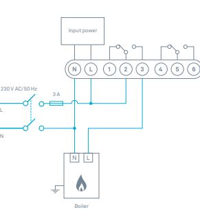

    Hi all,
    Does the Nest V3's live and neutral HAVE to be connected to the bolier PCB's L/N as in this diagram...
    ...or can it be connected to an alternative L/N supply? (EG a 13 amp plug socket)
    Many thanks.

    Doesn't have to come from boiler supply, although it's easier to just run 4core from the boiler to stat.

    Save trying to get a link wire across from live to 2 in nest,
    Live - L
    Neutral - N
    Live out - 2 (terminal on same plug a RT)
    RT- 3

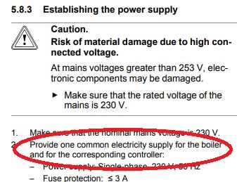

    The Heat Link should really be connected to the same 3A fused supply as the boiler, but the wires don't physically have to come from the boiler PCB terminals, but can come from directly from the fused spur itself.
    From the ecoTECH Pro manual:
    The Nest wiring diagrams also all show a common supply for the boiler and Heat Link
    If there are two power sources connected to the Heat Link, someone may isolate the power to the Heat Link and open it up and receiver an electric shock because there are still wires from the boiler that are 'live' connected to it.
    In rare instances for certain items of equipment where it is unavoidable to have more than one supply, a label should be affixed to provide an alert to the danger.

    When I actually came to install it I did indeed power it from the same fused spare as the boiler...I just replaced the Siemens heatlink with the nest, and ran a single wire from the nest to the boiler and removed the Siemens contro, wire from the boiler.
