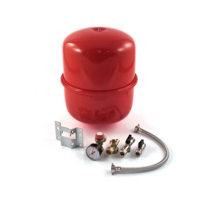

3. Out of interest, what pressure do you run the pressurised store at, and how is it pressurised?
#1 I spoke to Vaillant this week - they advised their REGULAR boilers cannot be connected to a pressurised thermal store. In fact they even refer to them as Open Vent boilers They advised the only boiler they make that can connect to Pressurised Thermal store is their System boiler.
#2 The REGULAR boilers have aluminium HEX only their SYSTEM boilers has SS Hex
#3 Thermal store is pressurised at 1bar, there is a standard filling loop attached to the Expansion chamber - pressurise with that. It's one of these : https://www.bes.co.uk/expansion-vessel-18-litres-20245/
