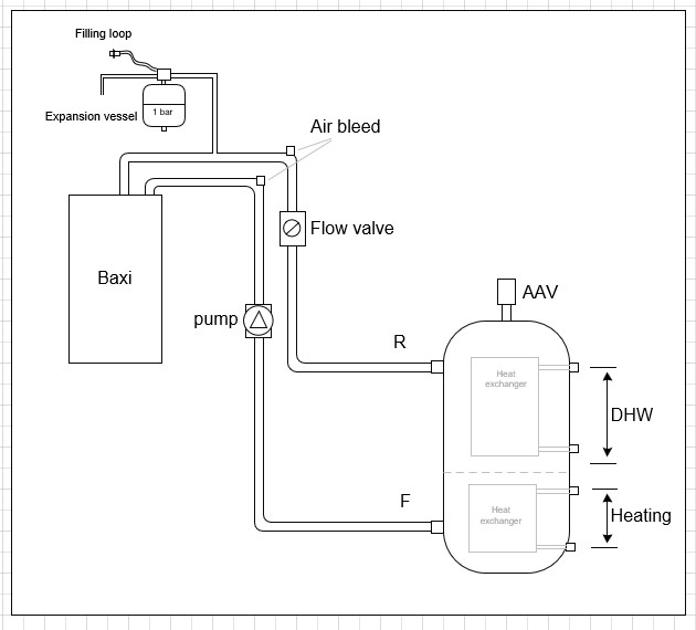

I am looking to replace 2 boilers in adjacent properties .... both currently have Baxi 100HE Heat only boilers.
They are connected to thermal stores (1.5bar)
Pressure vessel, thermostat, pumps and controls are taken care of separately, so the boilers are used simply ...... i.e. they get a call for heat via the 220V AC circuit goes live, they provide heat, modulate as necessary, until such time as 220V is dropped.

Worth noting that thermal stores ruin the efficiency of modern boilers as they run too hot, so if the store is old consider taking the opportunity to convert to an unvented cylinder. You can then set the whole thing up to run priority hot water which will have a positive effect on gas bills.
Intergas are definitely worth looking at and the ECO RF can be run open vent. Alpha ETECs are also good boilers and again can run priority hot water if desired.
I am not going to change the Thermal store while it is working fine. It is also a key part of the UFH heating design.
I can run it at whatever temp I want.
It is system designed to run at 65 Degrees (at 1/3rd up thermostat), so currently use that.

The simplified sketch shows set up

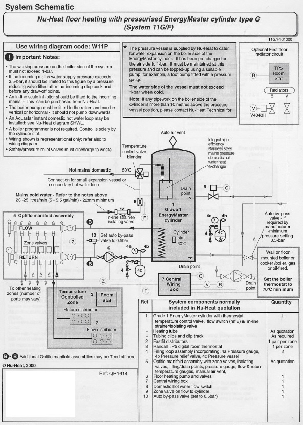

Found the original install schematic.
Had a few Heating Engineers now look at job ..... if Viessman will re-activate them as approved (they were until recently) that will get me 10 yr warrant and I will get the Viessman Vitodens 100-W fitted.
If they won't then it's likely to be a Bosch Worcester Greenstar 100-W heat only, pity such an expensive boiler yet does not have stainless steel heat exchanger. I do like the 10 yr guarantee .... clear & simple, much better than a warranty.
