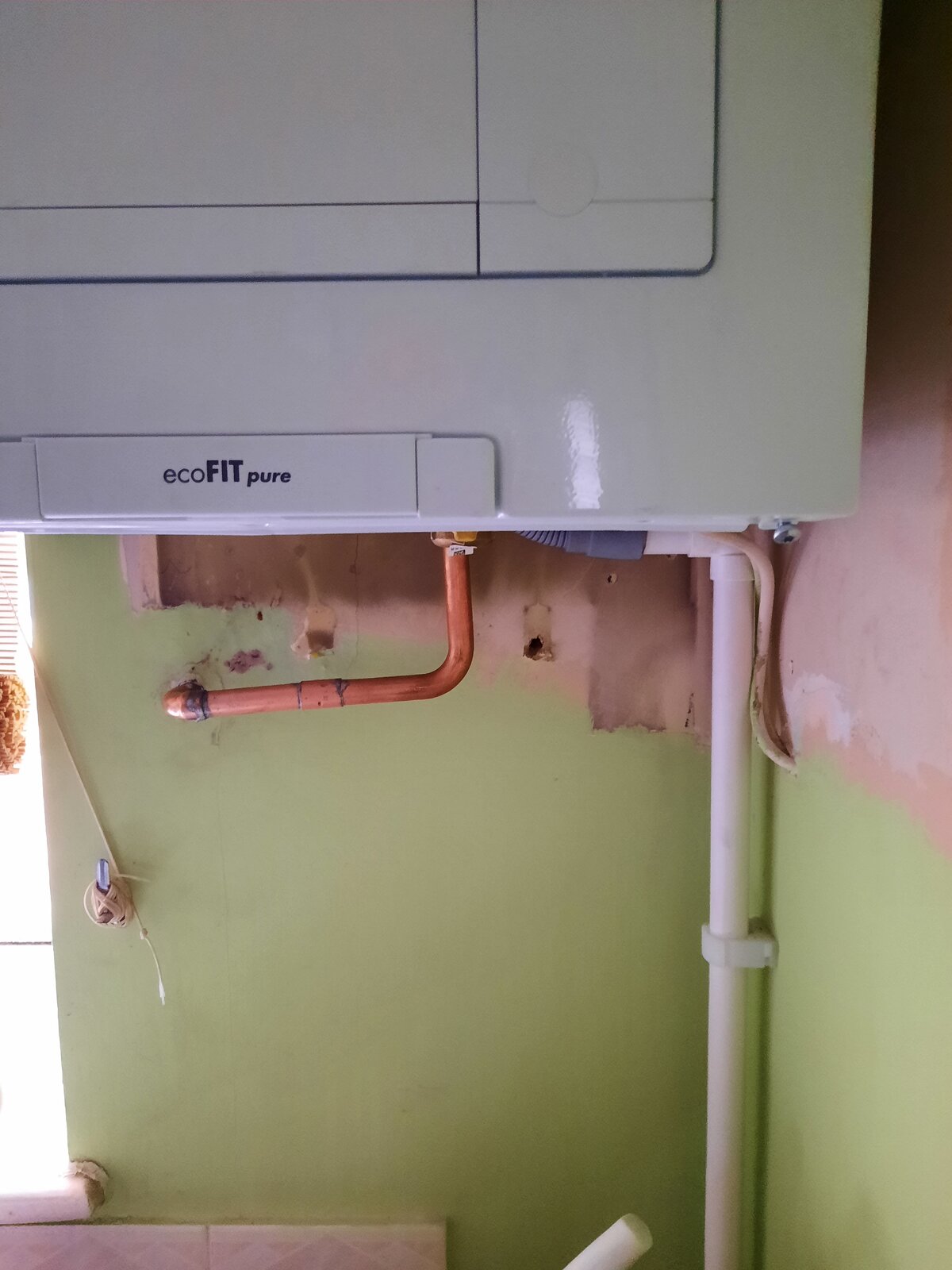

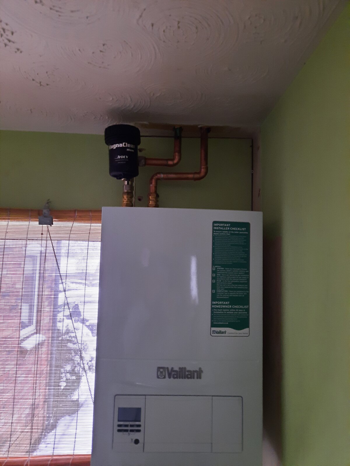

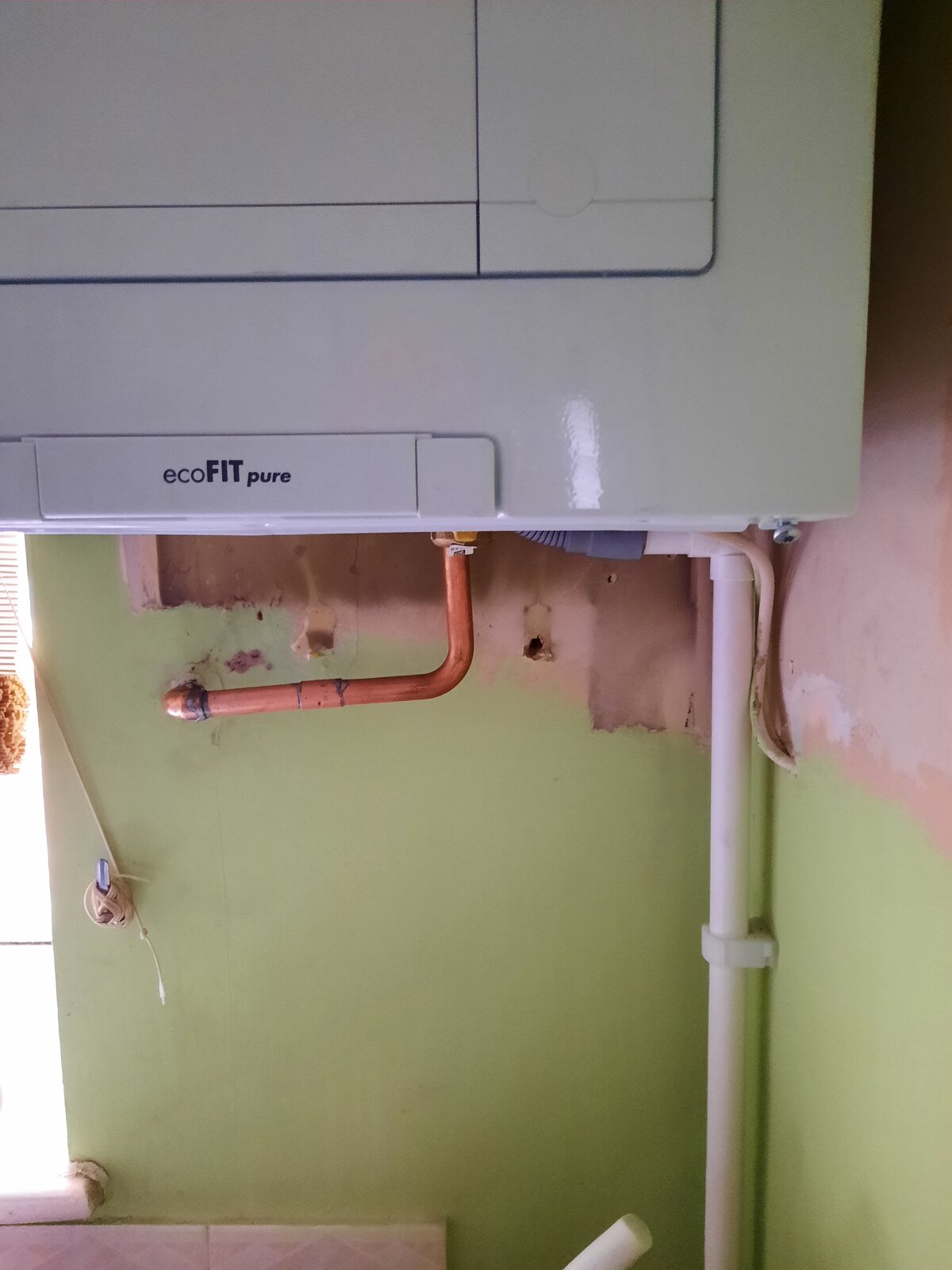

Really don't know why they didn't put the filter in the airing cupboard. I'm sure they could have made a neater job of the pipework too.
