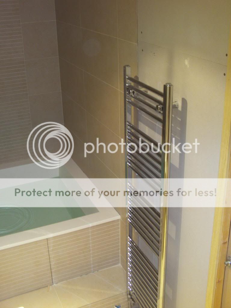

The last Raindance I fitted had a monster head and no combi would give it a decent performance.

this was for a customer with an odd shaped bathroom - so they had a very very expensive Japanese bath fitted that consumed a lot of water - deep square thing.
