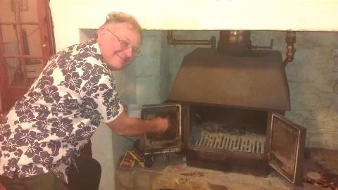

I think you need to check your maths!
This web site shows that even oak only gives 4.5 kWh per kg!
So 1.5 kg of oak would give a gross heat output of less 7 kWh ! But the practical stove efficiency could be as low as 50-70%.
So I would use Richard's word "twaddle" for anyone who pretended to run three rads and two showers for an "evening" !
Take care, great care!
And before you hide behind the sales brochures, that's me in the photo cleaning the sight glass on the wood stove in France. I installed it too a couple of years ago.
Tony
