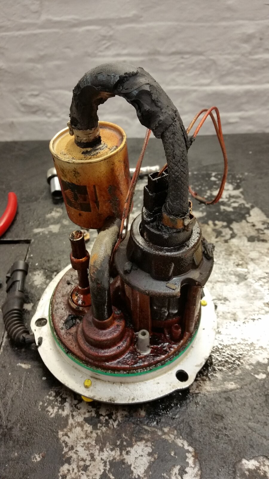

Never leave a petrol tank to evaporate and dry out on it's own. Either drain it or keep some liquid petrol in there (1/2 a tank).
This is what you'll deal with otherwise, not my bike but a job I had to sort out (fuel system was wrecked basically).
