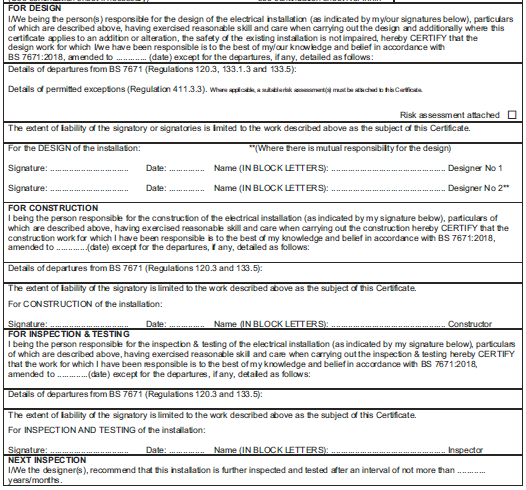

Yes! Just to update, as suggested I phoned planning a claimed innocence. They said they would accept an EICR. It was a bit of a challange, the first 2-3 sparky's I called wouldn't do an EICR on work they hadn't done, but i eventually found someone who peformed an EICR. Got cert and gave it to planning. Completion cert was then issued.

Yes! Just to update, as suggested I phoned planning a claimed innocence. They said they would accept an EICR. but i eventually found someone who peformed an EICR. Got cert and gave it to planning. Completion cert was then issued.

One thing we have been overlooking is that an EIC allows for different people to sign in relation to the three activities - design, construction and inspection/testing. Hence, give or take potential issues relating to 'inspection' of things (lie 'buried wiring') that ceases to be available for inspection, there would seem to be no reason why one person cannot undertake the design sand construction (and 'sign for them') and then for a different person to (perhaps 'subsequently') undertake (and 'sign for') the inspection/testing ...
