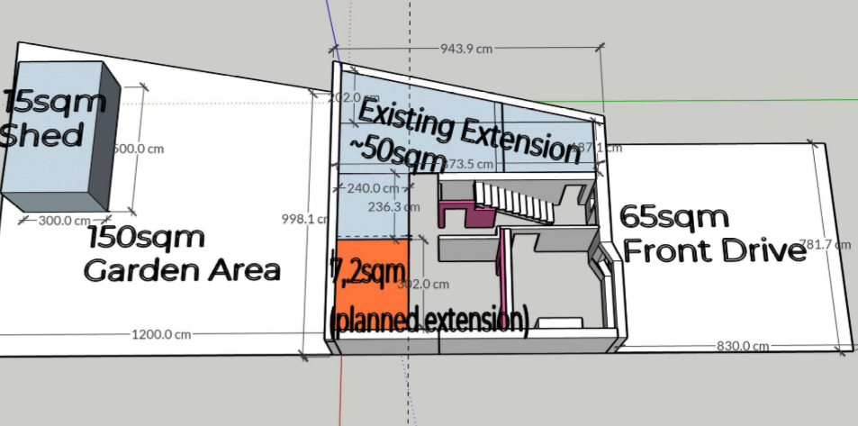

Hi fellow members,
We bought a house a year ago. It is a 1930s end of terrace property with quite a large two-storey extension that offered us 2 extra bedrooms and a massive kitchen at the rear of the property (see area marked in blue in the added image). We were told there was no planning permission obtained for the work when we bought the house. We were also told it was built around year 2000. Now we are at a point we would like to remodel and add an extra small extension (marked as orange), under permitted development as this new area is only 2.4 meters long and 3 meters wide. The council has told us over the phone that we would need to apply for LDC (lawful development certificate) for this project. So far so good. But then I approached a number of architects for a quote to apply for LDC on our behalf and I'm getting very mixed responses. Some say the LDC is enough, and others are saying that we have to apply for full planning permission application as the council will be looking at the entire addition to the property which exceeds 50% of the original width of the property and hasn't been approved previously. The ones who say LDC should be enough, say the council will ignore the old extension and it is better not add complications. Who is right?

Existing extensions are generally taken into account when calculating the total of allowance. The ldc will be for the existing unauthorised extension which cannot br enforced against as it was built more than four years ago. So its step 1.
Get an LDC for the existing development first, though technically it's not required as it was built more than 4 years ago it cannot be enforced against. Then apply for PP for the new extension but bear in mind if the whole development does not meet the criteria laid out in the Local Plan it's unlikely to be successful anyway.
Thanks for your replies. Not sure if I was clear. The new proposed extension (the orange area in my sketch) certainly falls under permitted development due to its small size. With that in mind are you suggesting the application will be simply LDC for the whole lot? (blue and orange)
I understand the 4 years rule, but can't shake off the worry of putting forward an application on the table that might remotely jeopardise the existing double storey extension (1/3 of the property). What is the actual risk of removal order by the council?
You won't get an LDC for the new bit as the whole of the addition to the original structure (unless pre 1946) is considered so it's PP or nothing. Approval of the existing bit doesn't actually come into the thinking.
There is no realistic chance of your being told to pull it down so far down the line but planners being planner might well deny you permission fo the extra bit. The only way to know for sure is to apply.

You were clear and we understand but the new orange extension is not PD. If the existing extension did not exist then then the orange bit would be PD.
But you wish to add to an existing extension (that would not be PD) ie the existing extension would require PP. Therefore anything you wish to add to the existing extension also requires PP.
So you can get an LDC for the existing extension for peace of mind if you wish, it should be straightforward. But in anycase you do need PP for the orange bit.
Hi guys, thank you for your thoughts. I have a real positive development to report to you. A proper rummage through the documents from our solicitors reveals that PP was granted in 2000 for side and rear double storey extensions as well as building regs sign off. Can't tell you what a relief. Our architect was initially was going to go for PP like you suggested, but now had changed it to PD on the basis of the documentation. Do you agree?
I think not. PD allowances are in relation to the building as first built (or as it was in 1948 if built earlier)

You will need PP for the reasons I and others have explained. It would appear that your "architect" does not know his job! Alternatively it might be "ok they've failed that we'll apply for planning, extra cost ....."

Thank you for all your replies. Just got a call from my architect who voluntarily changed his mind and said to be on the safe side we will go with household application. Is that the same as PP? Thank you
You need a household application (which is PP) because that is the correct thing to do, not to be on the safe side. Sounds like he's back tracking to me.
