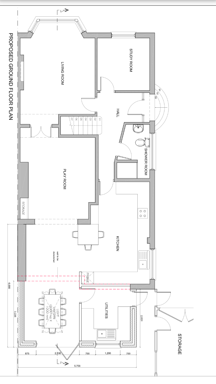

Background: We live in a London suburb, semi detached house with an existing 3m rear extension (3.3m at eaves, a flat roof, built ~8 years ago).
We originally applied via full planning for a loft, 1st floor rear/side extension, and ground floor extension (further 3m), which was refused.
We reapplied with a more conservatively drawn loft and 1st floor only, for which permission was granted, and separately went through the neighbour consultation scheme (NCS) for ground floor extension; and have been informed prior approval is not required.
A few questions re proposed rear extension under PD- we were advised to reduce the eaves height of the existing 3m rear extension's flat roof to match new bit of extension otherwise it would not be PD as it will be considered 1 6m extension.

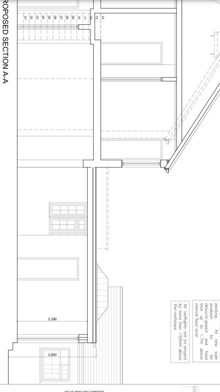

1) i am now reading RIDGE height can be up to 4 m as long as the eaves height is <3m. So could we have kept the existing 3.3height extension and done a pitched roof in the new part of the extension with a 3m eaves height, or would it not be allowed to have a section of flat roof higher than 3m? or alter the current flat roof entirely eg pitch the whole 6 m somehow. or any other sensible workarounds as I am not keen to reduce the height of the entire extension to 3m. i am mainly concerned that with a 6m flat roof the kitchen will feel quite low internally and not allow for enough light.

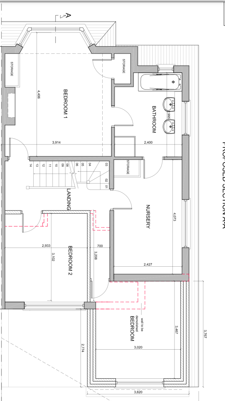

need some idea of what looks best for this larger extension externally / internally. note there is also first floor 3m extension planned spanning half the width (see plans) so not sure if this effects the ground floor extension roof design.
2) is there any particular order i need to do my build (eg ground floor under PD first, or 2story +loft extension granted under planning first, or either way?)
3) if we change the ground floor plan from what we submitted via NCS would we need to reapply to NCS/ or get a Lawful Development Certificate (LDC) with amended drawings , or just crack on with build as long as its PD?

Here are some plans for reference in case it helps to understand what we are doing ...
By the way for the kitchen extension , after some research we now plan for a fully open plan kitchen (unlike what is drawn) and keep the utilities in the garage where they are now (washer dryer). So we will build full rear width right up to our existing detached garage, thereby losing our side gate garden access, and insert a connecting internal fire rated door to attach the garage to the house. Again, i'm of the understanding that this is within my PD rights and therefore I can just go ahead and amend our plan without any further paperwork? (not planning to change the use of garage at all- just to introduce a new access point from inside the new kitchen).
could we have kept the existing 3m depth x 3.3height extension and added a pitched roof at the end of the extension to allow for a 3m eaves (bearing in mind this is a semi detached property so the extension is within 2m of the boundary wall). or would it not be allowed to have a 3m depth section of flat roof higher than 3m? so is it really necessary to reduce the height of the entire extension to 3m?
Unfortunately no you can't. The way the permitted development / NCS works is that everything you attach your new rear extension to must conform with permitted development rules. So your existing 3.3m eaves height extension TECHNICALLY, would not be able to be extended from whatsoever under the NCS because it exceeds the maximum eaves height of the regulations. - It is necessary to reduce (although a little silly) to meet the restrictions.
any sensible workarounds to this? i am mainly concerned that the kitchen will feel quite low internally and not allow for enough light.
You can go back in with a full planning application now that you have the fall back of the approval of the NCS, and see if the planning authority will look at a new full planning application pragmatically if you want to go through the cost / time.
