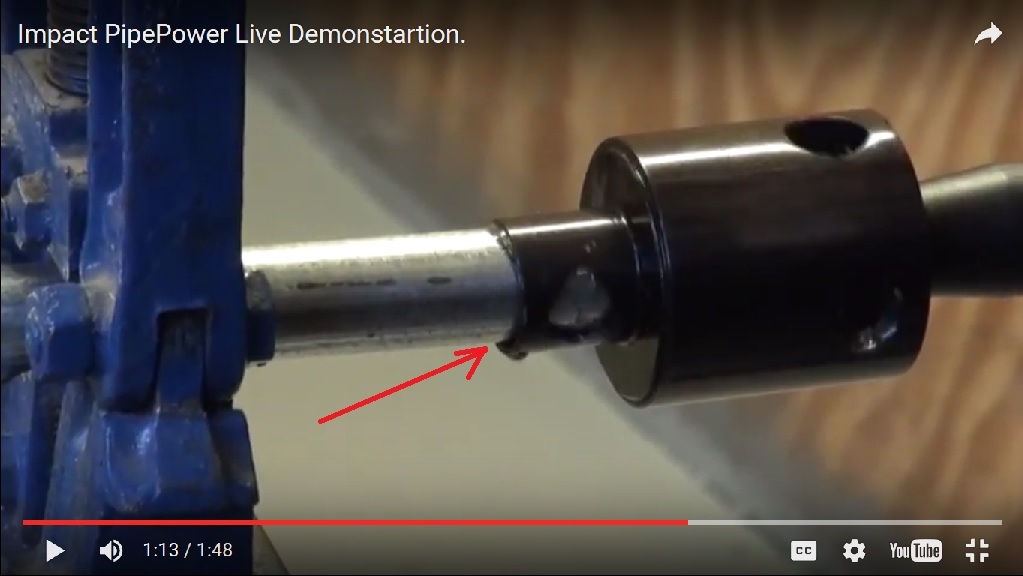

Is it me, or does the threaded section look bent, the conduit didn't look like that to begin with
Agree. When he engages the die, he is pushing upward with the drill, and slightly to the right a bit also (from his point of view). Hence the gap at the bottom and no gap at the top where the fluid has squidged out...
