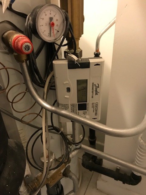

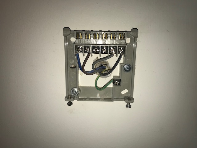

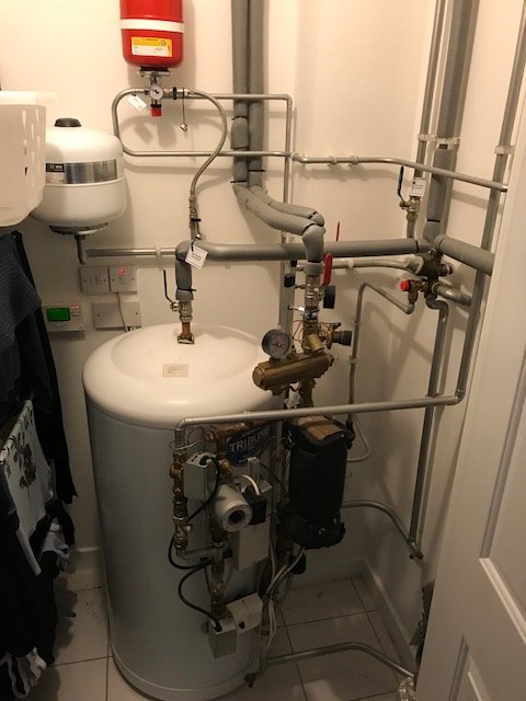

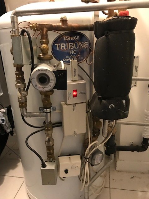

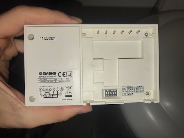

Hello,
Moved into a new flat about 6 months ago, and now that the weather is getting warmer and we want to turn our heating off we've discovered a little hitch - it seems like domestic hot water and central heating aren't programmable separately. Specifically, if either the programmer or the thermostat switch off, we lose domestic hot water (once our cylinder has cooled off). Note there is a central boiler for the whole block and we have a heat interface unit.
What is the best way to trouble shoot this?
Attached are pictures - including what I think is missing wiring for domestic hot water for the programmer.
Thanks!

The wiring looks to be able to give separate feeds, just check the dipswitch positions on the programmer. I can't make them out on your photo. It is also worth checking the operation of the two zone valves.
Looks like what's needed is all there, only 2 wires required on an S-Plan (3 - HW ON, 4 - CH ON), the dip switches on that programmer as just to alter the day programming mode and heating type. As @oilhead mentions I'd maybe be getting someone in to check the valves out.
