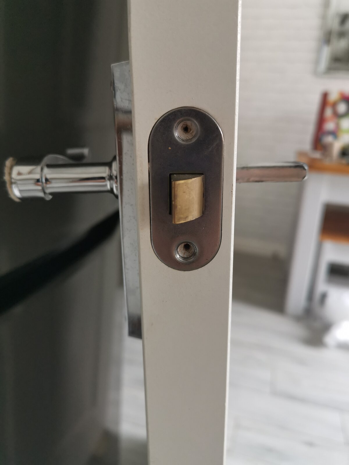

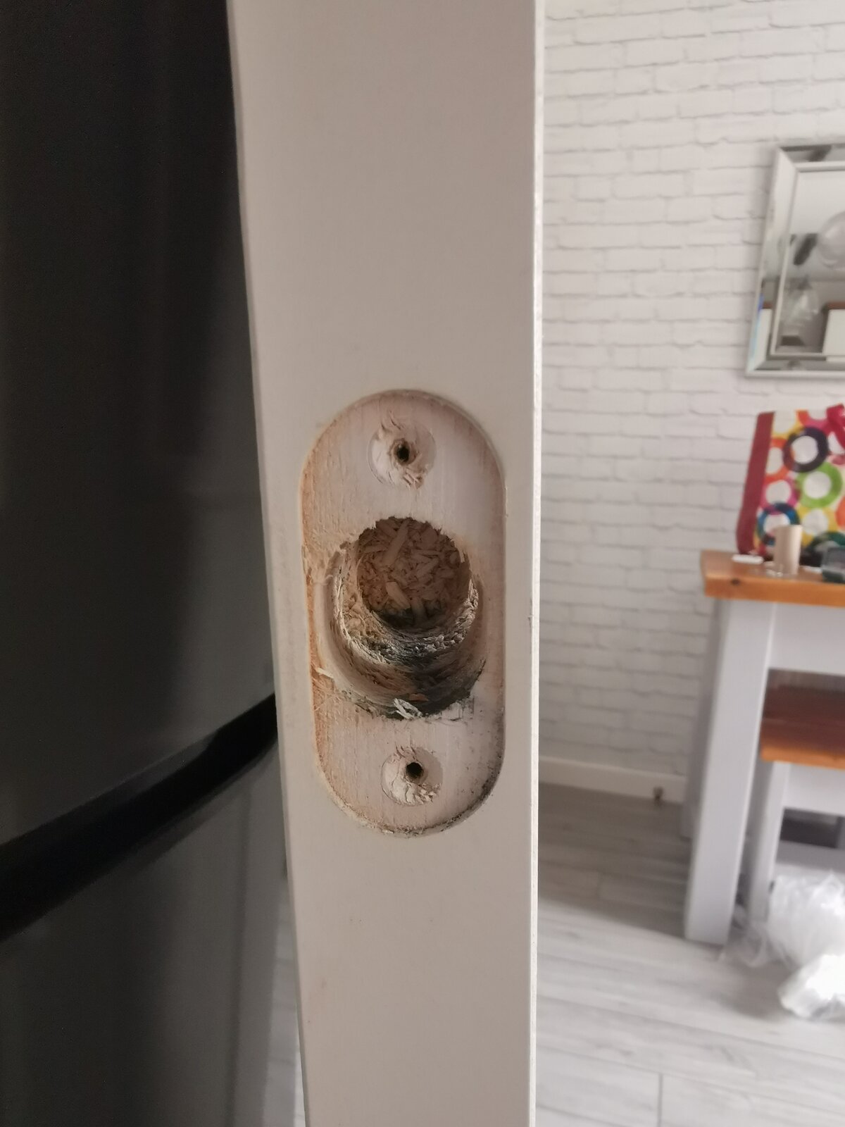

Just bought 2 new half glazed doors to let some light into the kitchen and hallway but noticed are current doors strike plate shape.

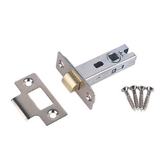

Is this going to be something I could do without a jig or would it be easier to just buy a new plate (rectangular shaped)
If you mean you were thinking of using your old latches in the new door then you'll need a router and a 25mm(I think) router bit, easier to change to rectangular latches
I see no point in a DIYer buying a router and learning to use it for this job.
Yes, a chisel will be easier and cheaper for you.
