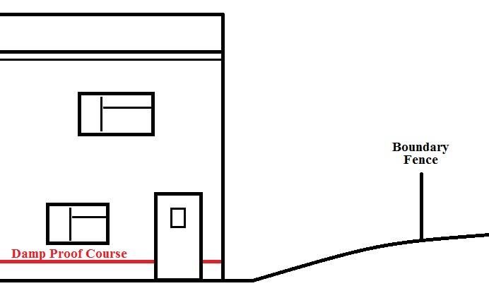

Semi detached property looking to build a new linked garage on the side.
Ground level directly outside house is standard 3 bricks beneath DPC but then slopes away from the house by about 2 feet over the width of the proposed garage.
The house itself is set back from the road by about 2m and is two or so feet lower than road level. I want to build my garage as close as possible to the height of the road to make the drive in front of it as flat as possible and to match the heights of my garden out back and the land to the right of the property.
Here's a quick sketch to explain:
My issue is that this will bridge my DPC resulting in moisture ingress to the house.
Are there any simple or commonly used methods to solve this problem?

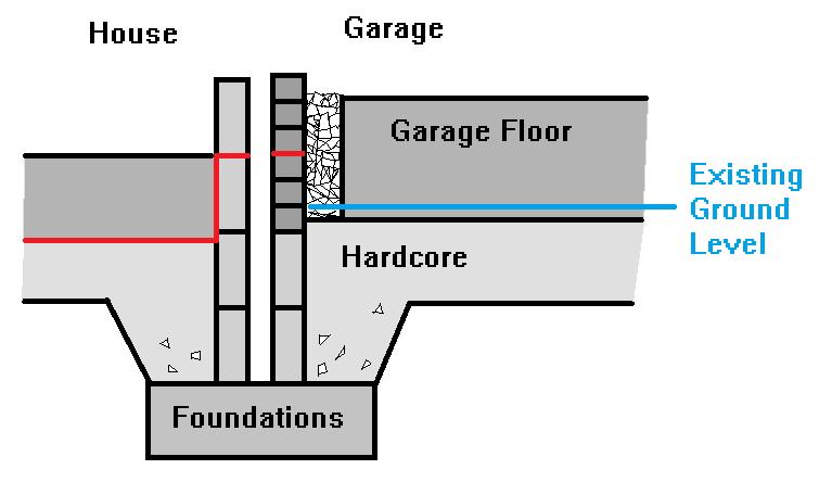

Hi again,
So I'm now thinking that by meeting the dpc on the new walls with the house wall and by introducing a layer of gravel into a gap between the concrete base and the house wall I should be able prevent or at least minimise moisture ingress.
What do you think?
Yes it does - it's 80s construction.
Here's a rough sketch of what I'm planning.
Not entirely sure I've drawn the internal floor correctly but you get the picture!
Do you think this will work?
Jeffy
As long as there isn't a door joining the house to the garage there's no problem. You don't need the gravel, run the concrete all the way to the walls.
theres no problem there as you have a cavity, all I would do is lap the polythene up the the side of your house ,tak on the brickwork with some roof batten and then cut of flush with top of concrete once it has set ,job done

No, I'm not planning to fit a door between the garage and the house.
trowlerman Thanks for the advice! Is this standard practice?
So on my drawings should I just show the vapour barrier lining up the inside of the wall?
Also if my DPC is higher in the single skin brick garage than on the house am I OK just to place some DPC vertically in the join?
