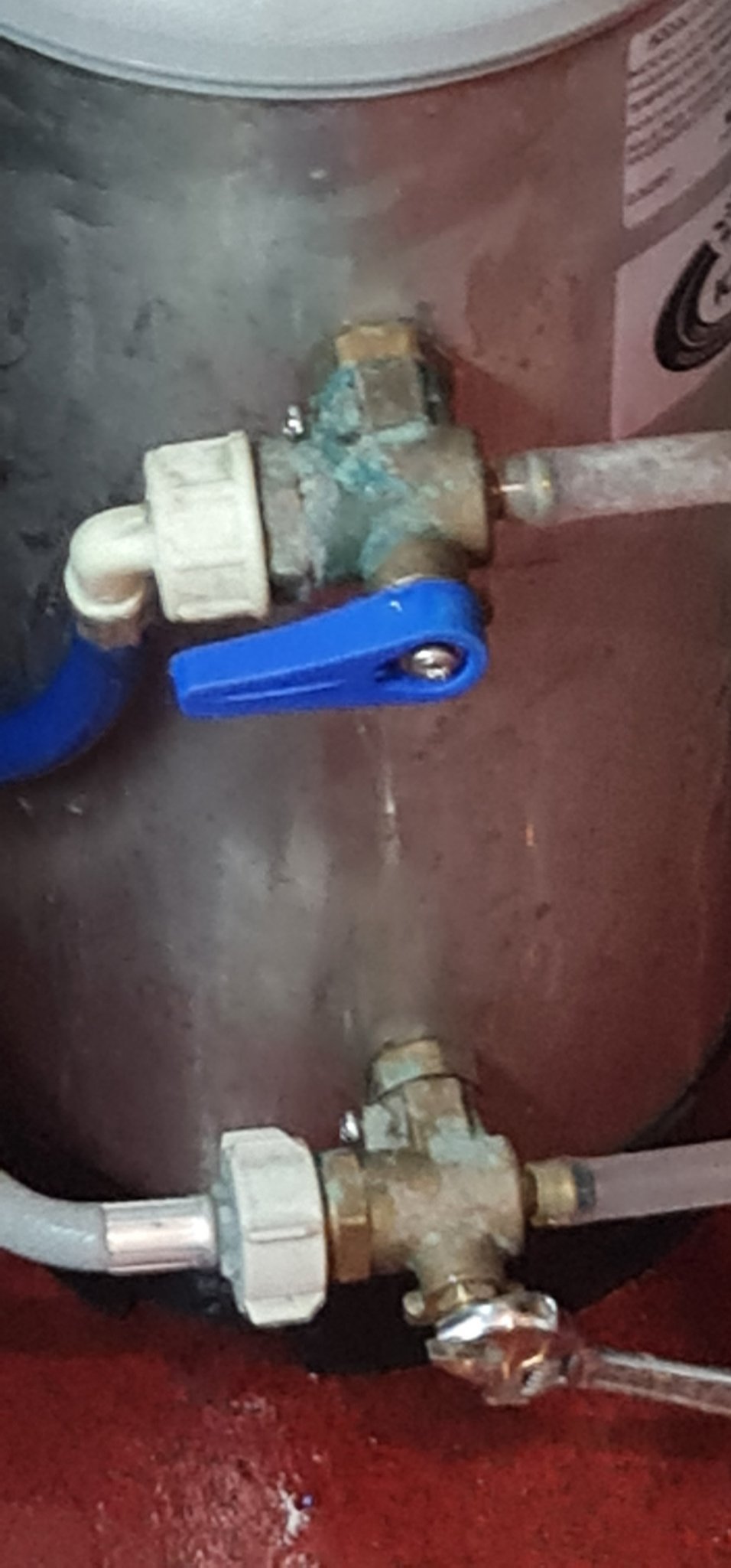

New nylon lever for valve

Hi all.
When nylon quarter turn valve levers wear down, would it be possible to replace them with something more reliable, eg a metal twist or lever arm? if not, can anyone recommend a supplier of the blue lever in the photo?
The photo is from the salt machine in my local pub, the lower lever just spins, so I had to use a small adjustable to open close it.
Thanks in advance.
Chances are it is partly sized which broke the handle It would be better to replace the valve if possible.
You could try finding a ring spanner that fits and securing it with the original screw and a washer.
