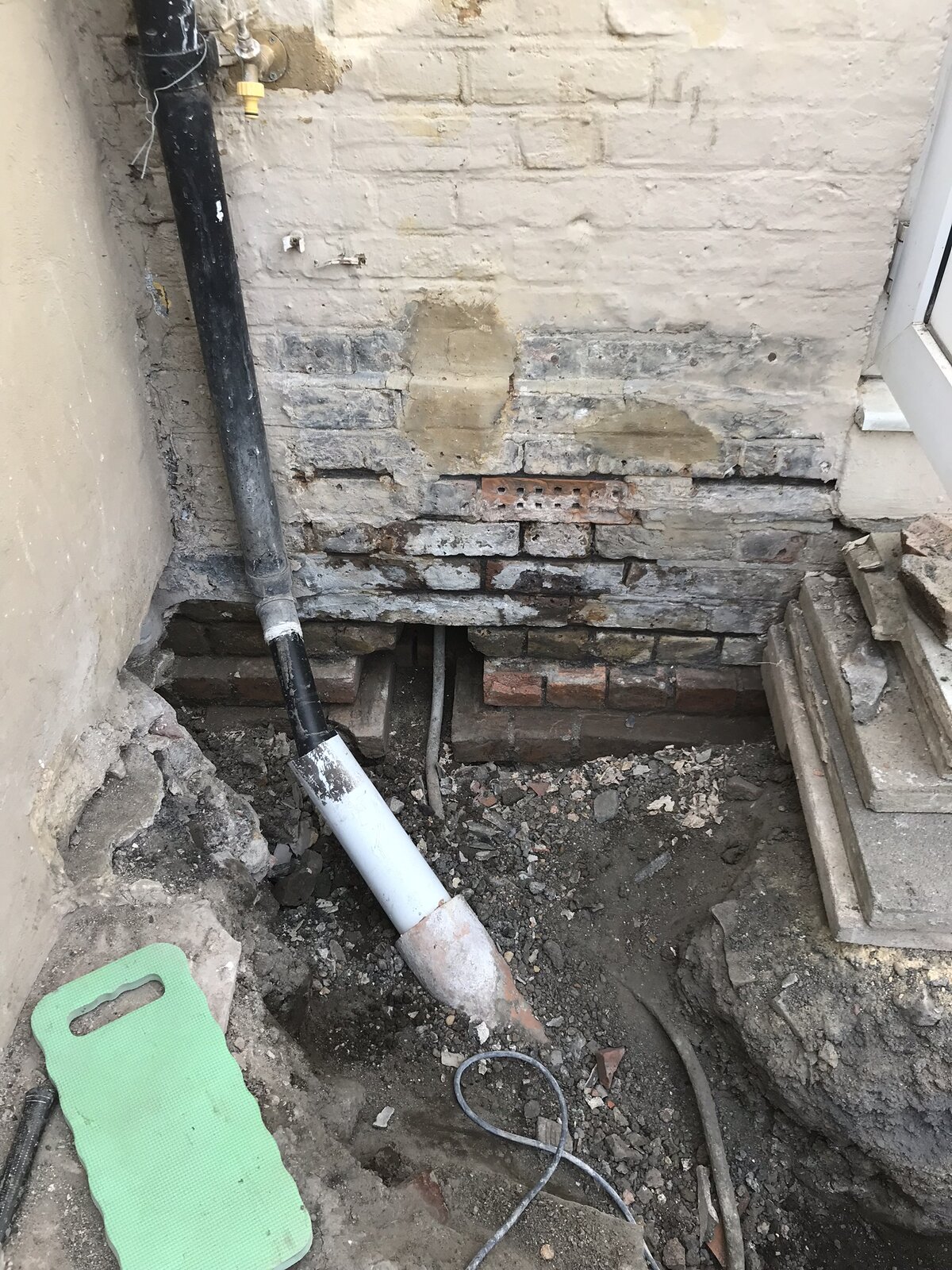

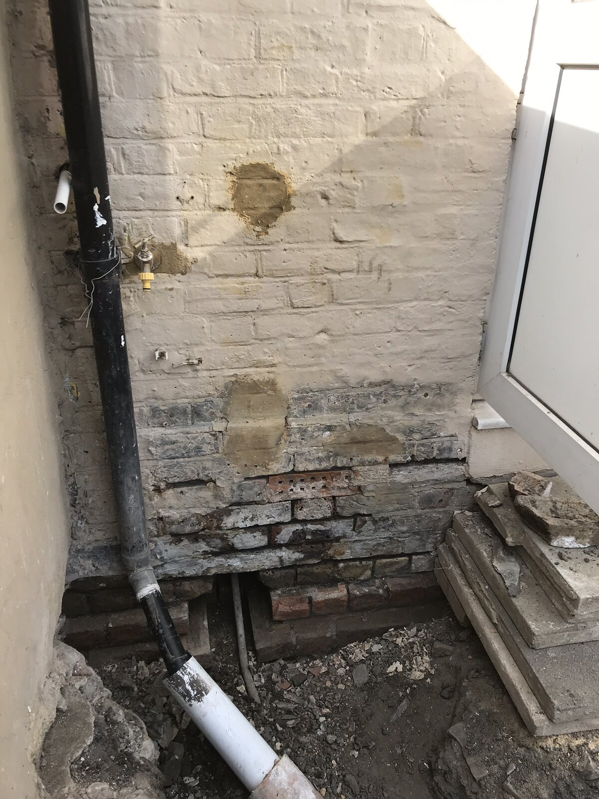

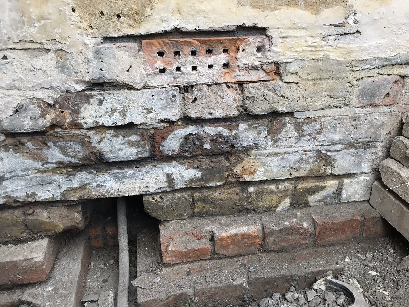

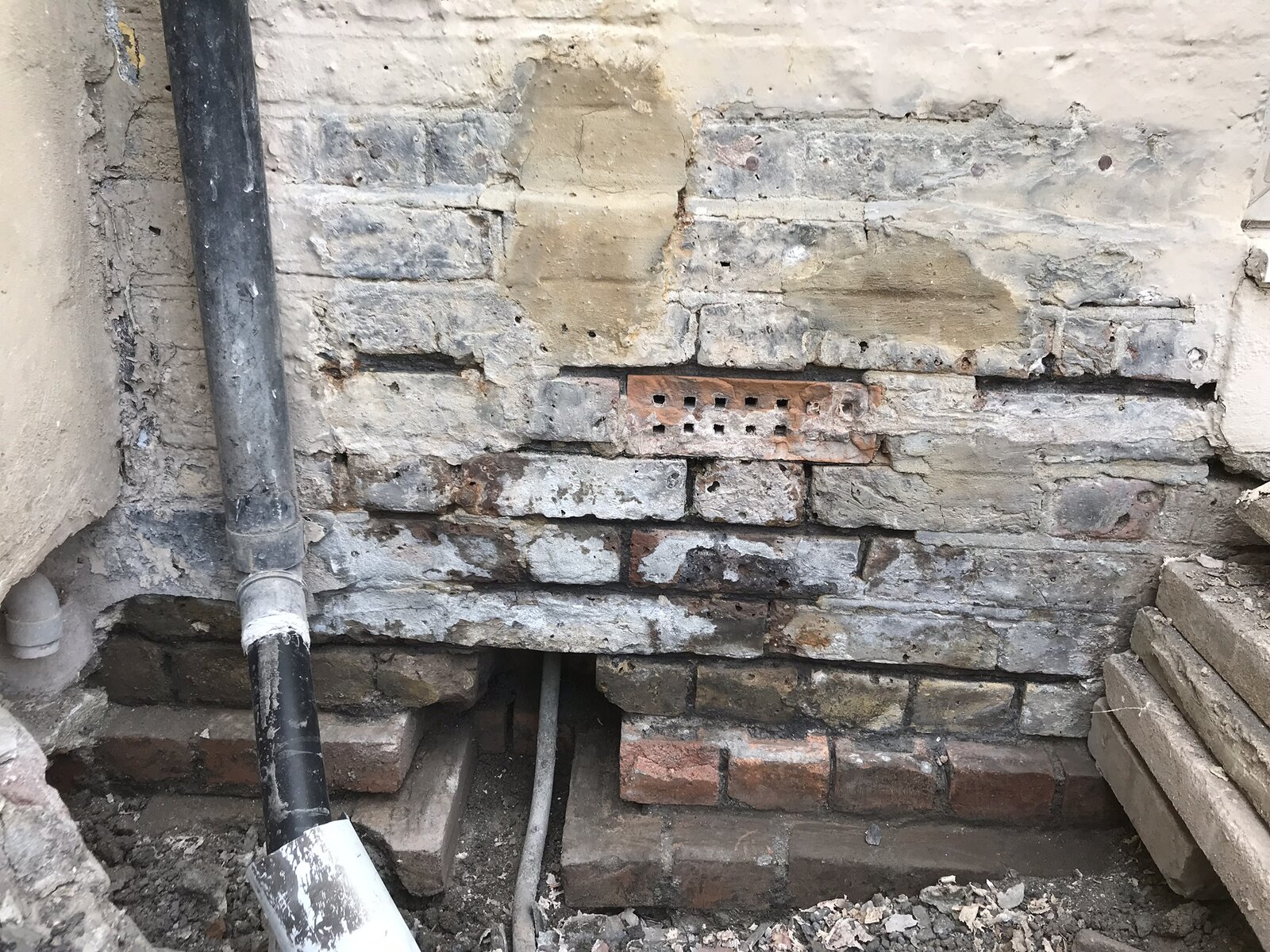

Today I stripped some of the paint and cleaned up the wall. I have limited time at the moment due to work so I go along when i can.
I also got the heat gun out to help dry some of those bricks. Tomorrow, I'm hoping to strip the plaster where the paint stops peeling. That's going to be a biggish job as I have to deal with the internal partition wall as well as the facing wall.
What i did notice however after cleaning the wall, at some point it looks like they had some damp proofing done, and I can also see a damp proof cause where the air brick is. Just a shame the damp people didn't fix the root cause as you previously mentioned in an earlier post.
Once i'm done I really need to know how to deal with the finishing i.e. render the outside, if so with what? I'll also be getting a plasterer in to patch up the area that i'll strip down, but again what should they do internally as i'll need to make sure they can do it?
Or do I need a specialist damp person to come in and have a look, though i suspect we'll be okay once the new gully goes in. Cheers
Ignore the temp gully fix.

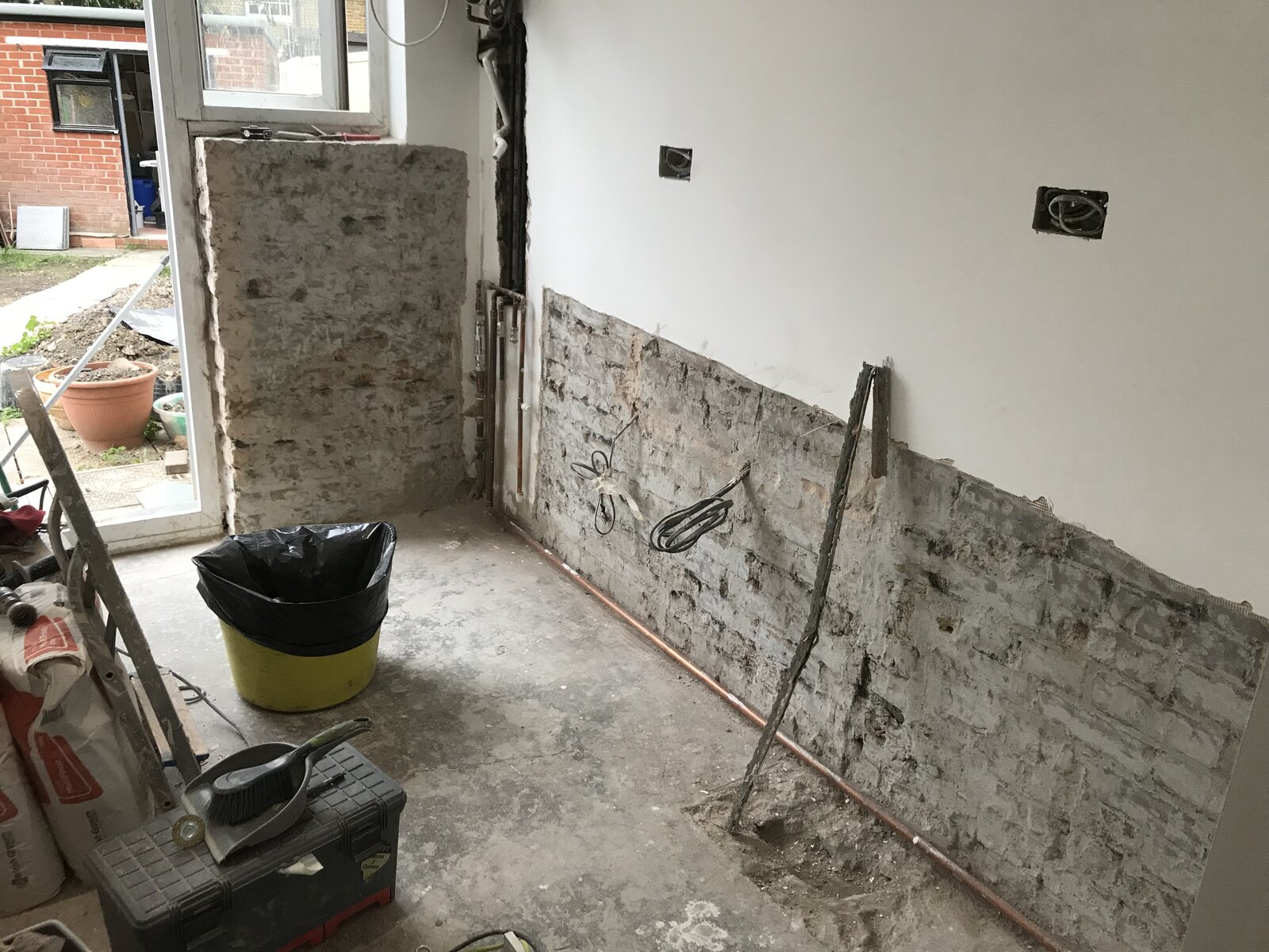

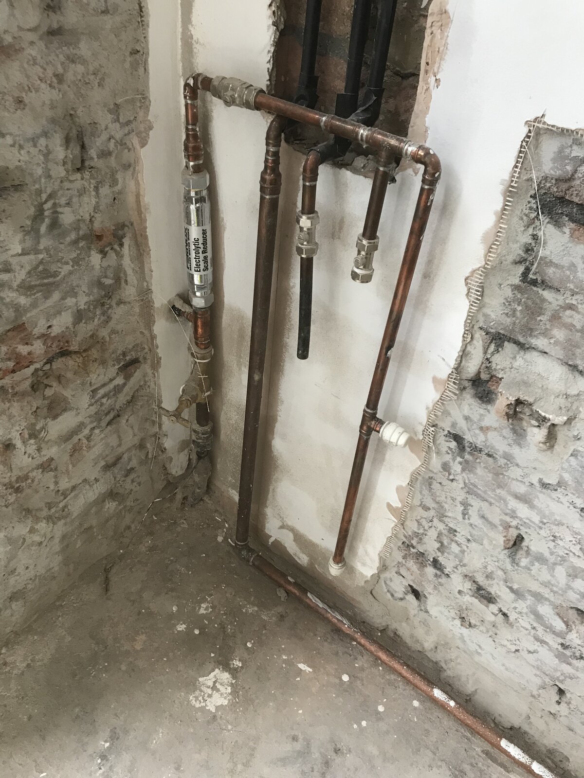

Internal kitchen Wall now stripped, I went over it with a wire brush drill attachment. I hope that’s enough height wise? There wasn’t any noticeable salt deposits or paint peeling At that height.
The walls appear to be dry which is good news.
A Plasterer is going to check it out, but he mentioned cement with some waterproofing solution silca or something on the phone. I recall ted456 mentioning not to cement it...
Near the pipe work it’s going to be difficult to remove the plaster in that section - will that suffice?
