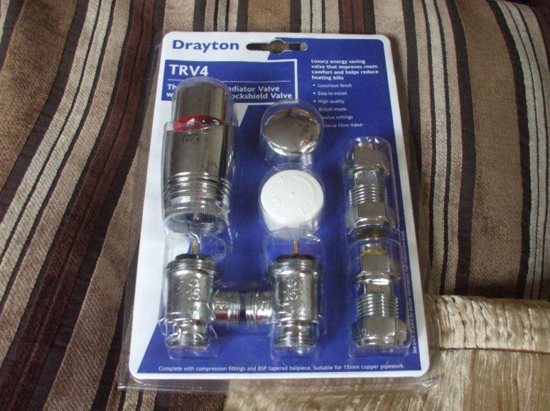

I'm in the process of relocating a radiator, and as I'm a relative newboe, just wanted to check a couple of things if you'd be so kind:
Firstly, i have bought a new TRV / lockshield valve pack (one of these to be precise): http://www.diy.com/diy/jsp/bq/nav.j...onsSpecificProductType=valves_and_accessories
In the pack though, both of the valve bodies are identical - is this right? i would have expected them to be different?

Well one should have a rounded top were the TRV head screws on (TRV should be in box seperate), and one should have a cap on held by a little cap on, and when you take the cap off it, it looks like this

That certainly means i was right to be suspicious - once the caps are off, both ends have the 'pins' that should out be on the TRV end. Though it seems that is how they're meant to come - you can see a bit better what's in the pack in the below picture:

WTF! The lockshield is just a TRV with a shiny decorators cap
Take that pack back and get a proper set with 1 TRV and 1 lockshield valve that can be correctly balanced.
Drayton is a reputable make, and I expect they know what they are doing [and can no doubt express themselves adequately without swearing].
Your new valves are OK. Plastic is OK. Make sure the pipes are fully inserted into the fittings.
It's a TRV4 P_P, yes the sets do come as two TRVs with one head and one posh dec cap, but balancing is not an issue as TRV4s have a balancing function incorporated into them, and have had for many years. You need a gadget to do it with, but it can be done and works well.

In hindsight I think I'd have been better off buying the lockshiels valve seperately and got a 'normal' one though!
