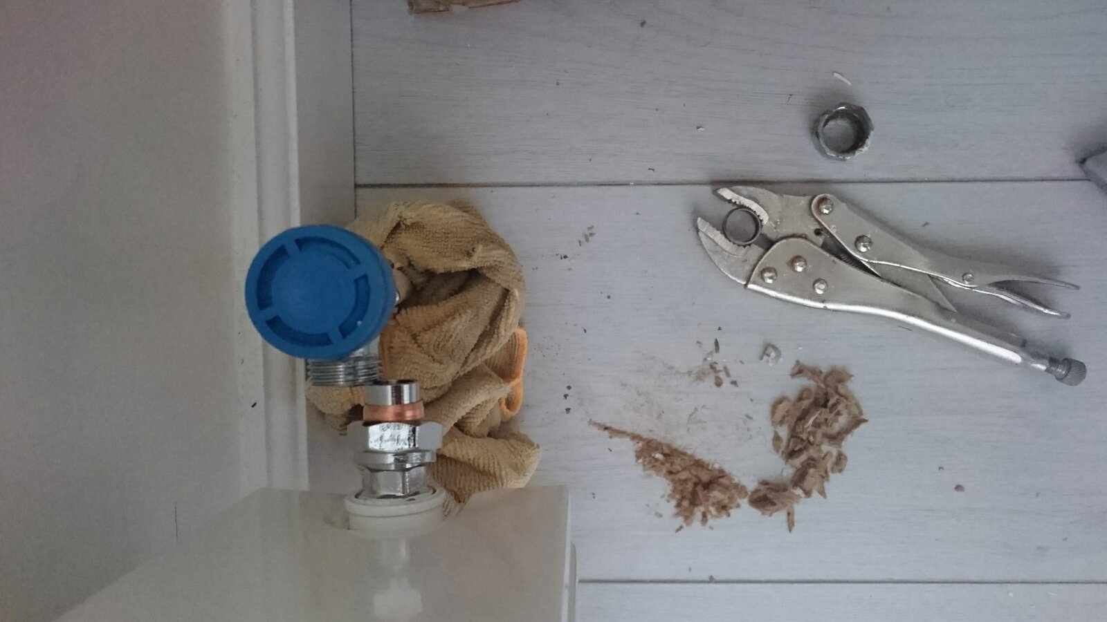

Hi all.
I have just replaced an upstairs single wall radiator with a double wall radiator (for more heat) but I did not consider the inlets.
I do not have access to the pipes as they come out of the floorboards and are then covered with laminate. There is a little give but not enough to comfortably reach the valves without constant stress.
My ideas:
1-cut into the wall so that the brackets are deeper so the radiator is closer to the wall (I'm not sure if there will be enough plaster to cut out)
2-Get a radiator valve with a bend in it so it comes out, shaped like this:

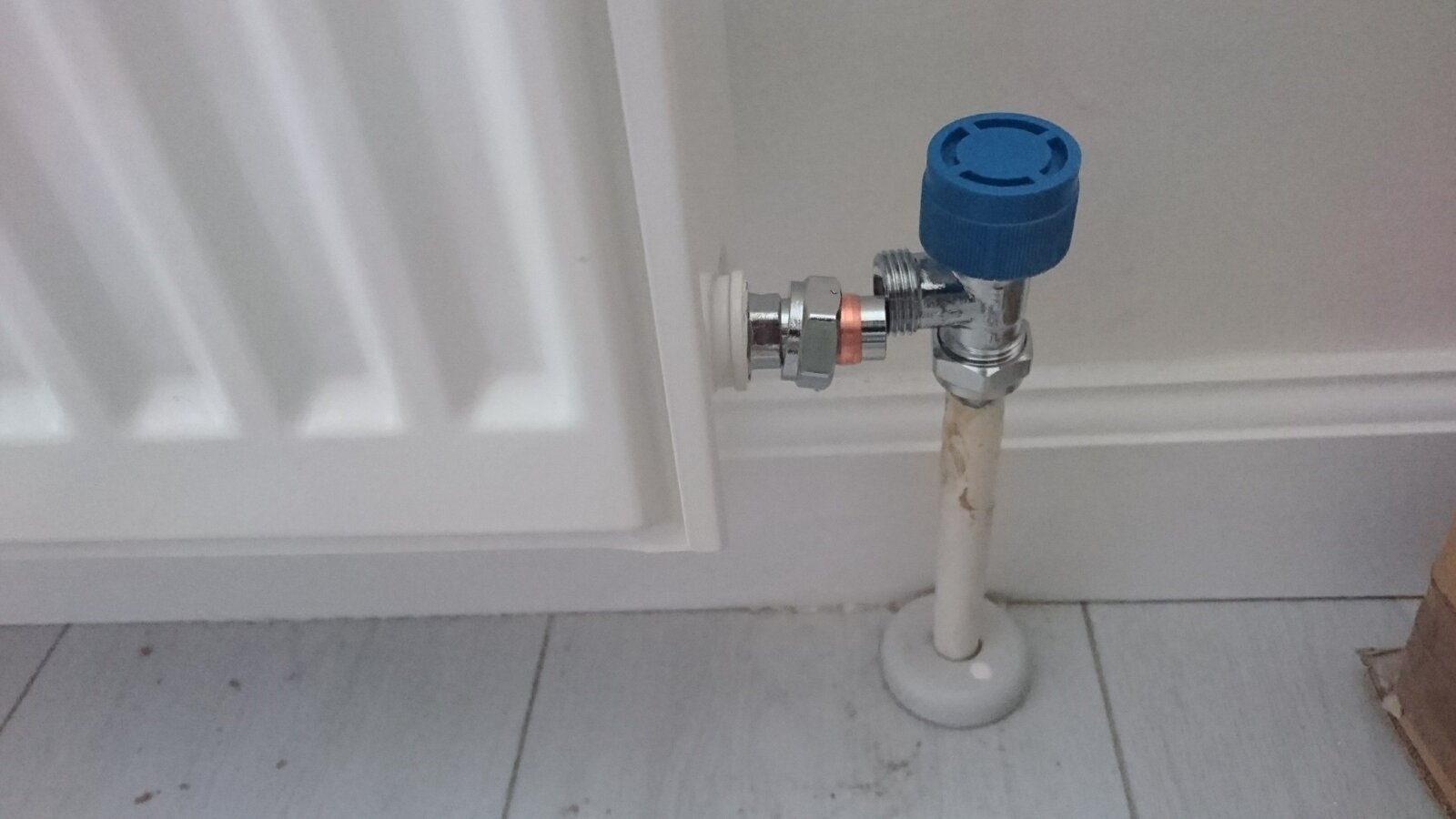

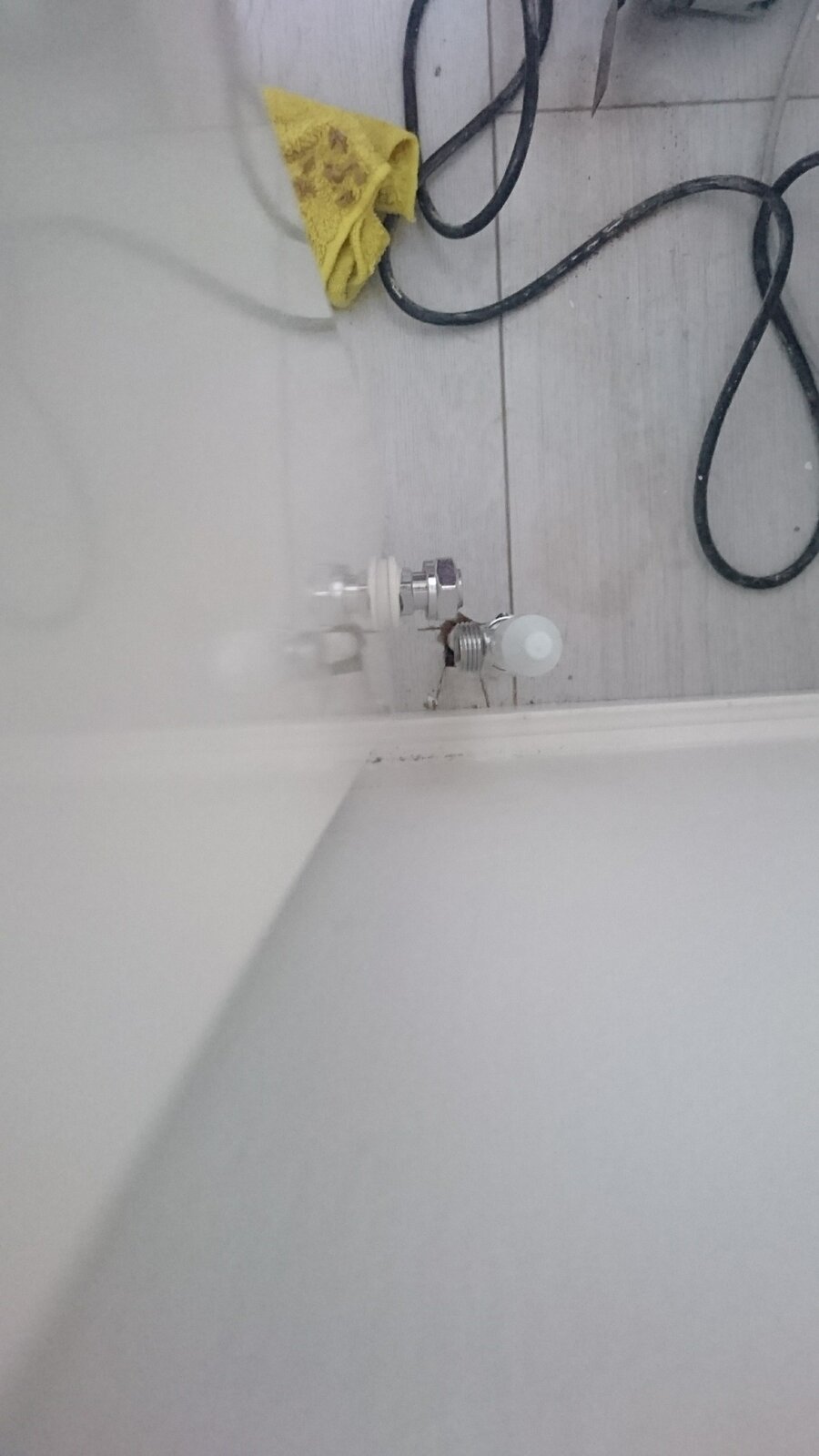

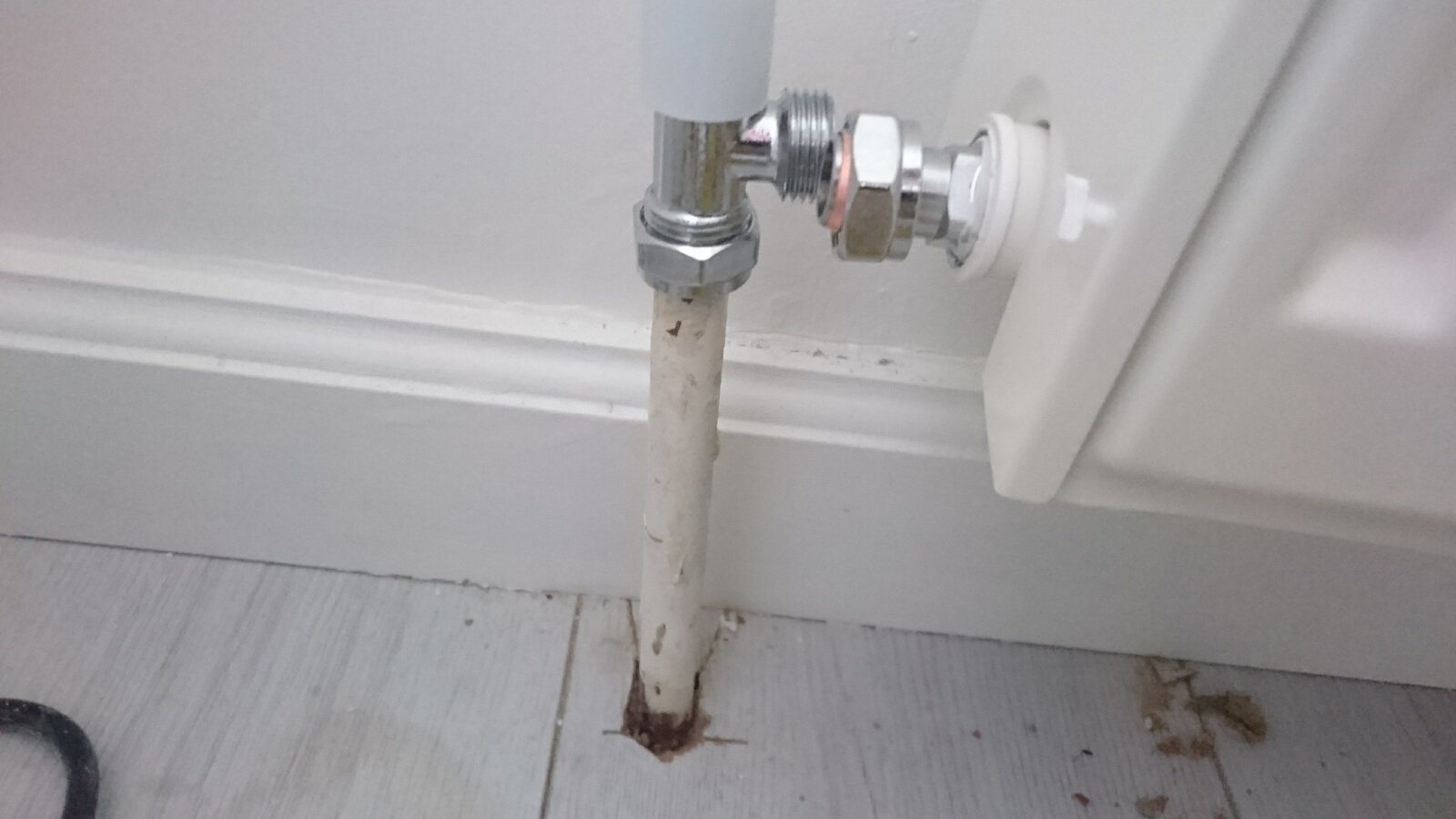

Pics attached. DSC_0419_noexif.JPG DSC_0418_noexif.JPG DSC_0417_noexif.JPG DSC_0420_noexif.JPG
How do I alter the pipe? Is it ok for me to just bend them using a pipe bender?
which way round did you fit the new brackets ? there are two ways, one takes the rad closer to the wall the other way round pushes the rad out slightly
Yeah, I did see that haha, I fitted it the short way. The other way will come out more.
Chip/drill a little bit out of the floor to give more movement on the pipes maybe? Give the pipes a tug and put a small bend in them?
if they wont bend, likely you will have to cut the pipe and install 2x 45 degree elbows on each pipe to get the pipes where you need them
or if you have a pipe bender, bend an s shape how you need it and cut the pipes and use a straight joiner to connect the newly bent s shape
you could use 2x 90's (if there is room) but might look a bit crap.

I've tried the first suggestion. I can't get any more because the movement is now blocked by the floorboards, and I don't want to attempt keyhole surgery in case I hit the pipe.
I'm happy to do the second suggestion if that is safe for the radiator pipe. Can you advise please?

if you bend the pipe it wont line up to the rad as bending the pipe effectively makes the pipe shorter so you will have to lower the rad.

Can I buy a pipe bender and bend it in-situ?

I haven't permanently drilled the bracket in. The bracket and its hangers are very forgiving, and the inlet pipe has some up/down movement so I am ok there too.
You won't get a pipe bender in there. You'll need 2 × 45° elbows on each pipe as sxturbo suggests
