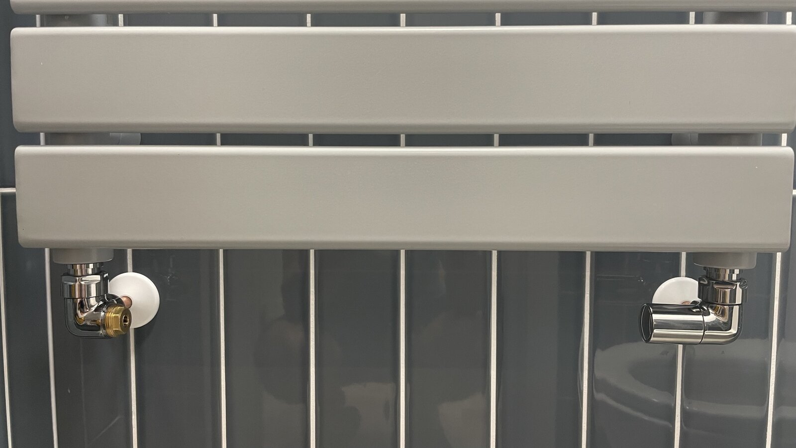

Hello, I just finished renovating my downstairs toilet and I just tried to turn on the heating.
There isn’t any noise of water circulation and the radiator doesn’t get hot.
I have individual Tado valves on all radiators (except this one) so I just have one of them calling for heat.
The obvious stuff: the boiler is on, the radiator whose Tado valves is calling for heat is getting hot.
I opened the lockshield fully using an allen key (counterclockwise) and also opened the other valve fully counterclockwise.
I don’t remember if I made sure I piped the flow on the right and the return on the left.
The instructions say it matters
Could they have a one way valve in one of them?

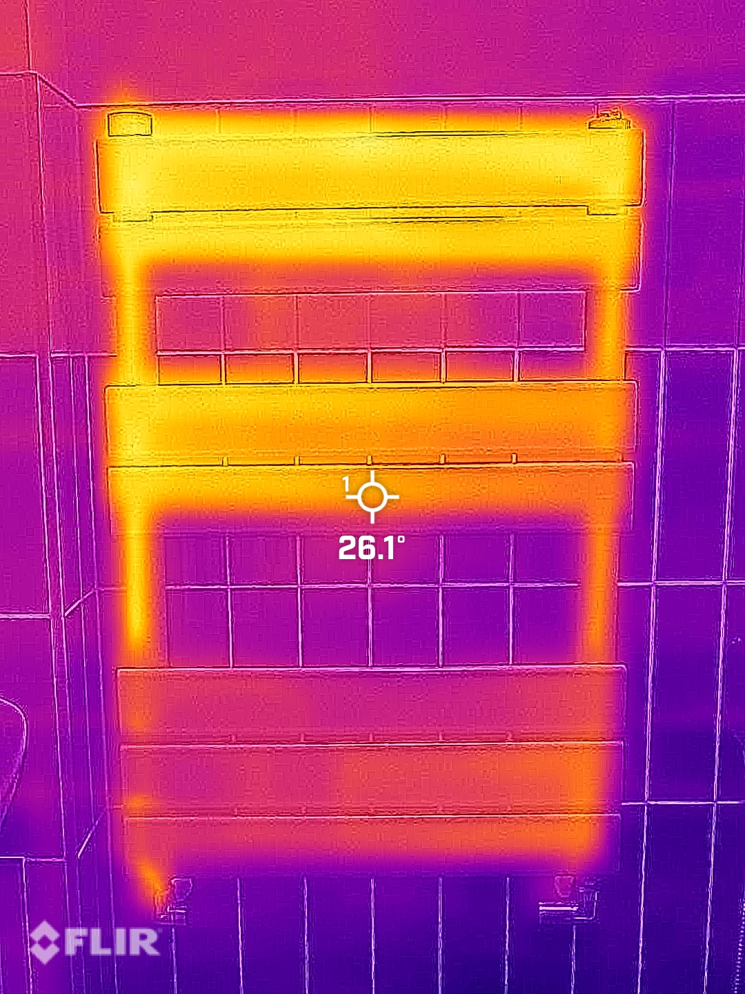

Ok, I’ve let some more water out and there is water flow now and it’s getting hot.
I thought airlocks were an urban legend.
