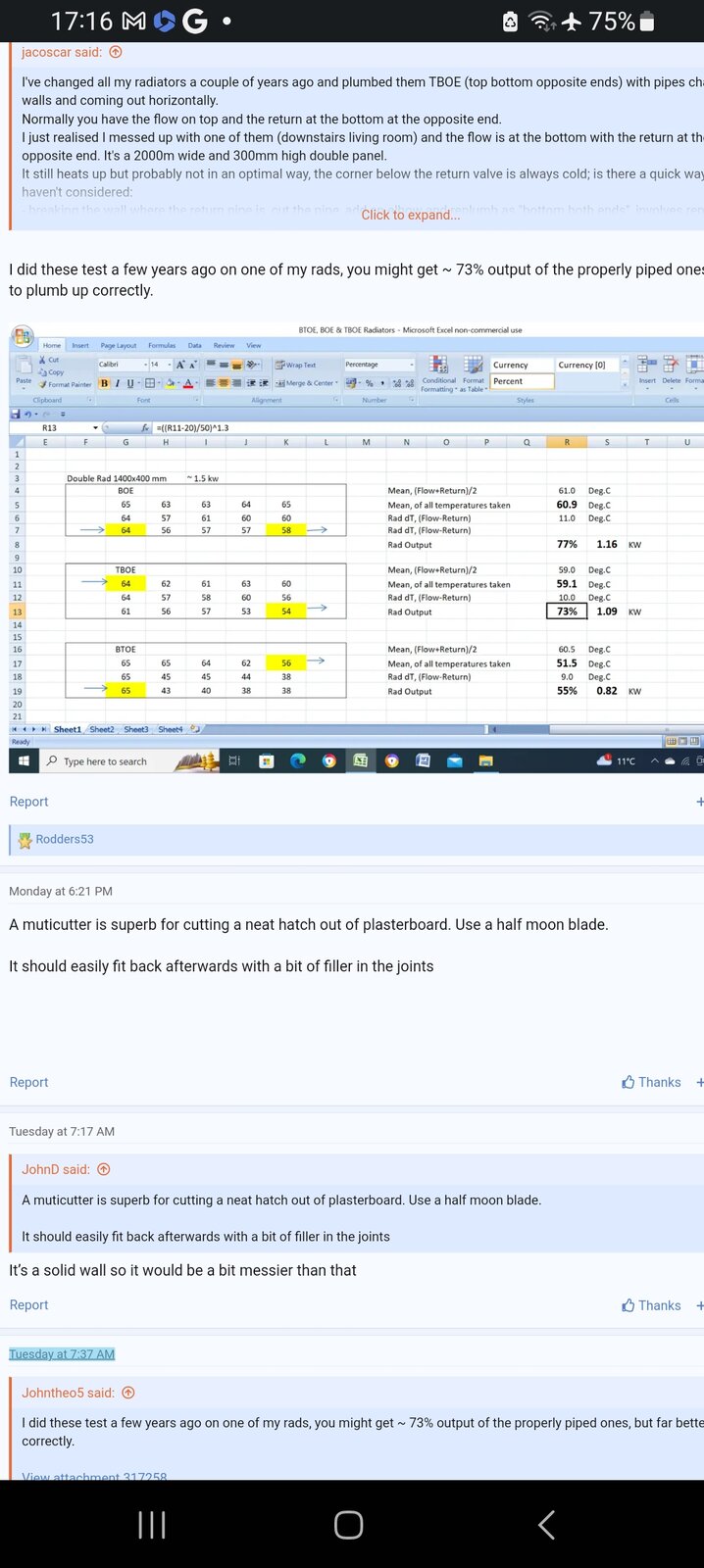

Your temperature gradient should be like mine below.
If your radiator was the same temperature at the inlet and outlet it wouldn't have given out any heat to the room!
The numbers in the diagrams are the rad temperatures taken with a IR gun, the top one where the pipes are connected in to the bottom of the rad (normal installation) should give a fair indication of the temperatures you can expect if set the boiler flow temperature to 65C.
