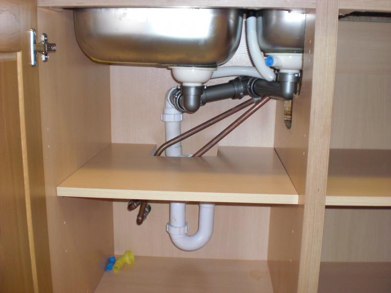

We have just fitted a new kitchen with a 1 1/2 Bowl Stainless Sink.
The old U Bend and waste outlet has been reused but the lad who installed it used a 1 1/2 bowl waste set from B&Q (Dark Grey).
I have connected a washing machine to the correct outlet on the B&Q section.
The problem is the whole thing is leaking and when the washing machine empties the waste bowl fills near to overflowing, all in all a pretty dire situation.
I have tried to tweak all the connections but after a while they leak I have even disconnected them and wrapped PTFE around the screw threads and also used Plumbmate silicon sealer, to no avail!!!!
The B&Q parts seem to be at fault, the plastic seems very hard and the black seals that they employ are pretty shoddy, there are no rubber seals where the washing machine waste is connected??
Anyone recommend a decent plumber - joking anyone recommend a replacement 1 1/2 waste set and tips on how to prevent leaks. As far as recall as long as the waste has rubber seals no other sealants should be required.

Firstly, I have never known a newly installed sink waste to leak, if its fitted properly. The rubber seals should be more than adequate for their purpose, something is seriously wrong if you need to use anything further to try and seal it. Its possible you may have a dodgy waste kit, if its salvagable still, take it back to B & Q and get another, fit it exactly according to instructions.
Secondly, if the water is backing up into the sink then that indicates a blockage in the pipework, however without looking at the setup its difficult to tell. If the waste is that badly installed then anything is possible, a picture would help here.
the waste kits from B&Q are a nightmare, i have always said it is usually the way someone fits it that causes a leak, but recently have had the pleasure to change 2 sinks, both from B&Q and the grey kits are mince, very weak loose fitting washers and i ended up taping the joints with gas ptfe tape to seal them, as previously said McAlpine waste connections never require anything and hand tight is always enough to seal them all.
Here is the picture, the only thing not showing is the W/Machine Waste. It comes in from the upper left runs behind everything and is connected to the end cap at the end of the run that comes out of the 1/2 bowl just after it connects to the pipe joining the 1 1/2 bowls together.

you can use the mcalpine 1 1/2 bowl kit but you'll need a few extra parts as well as your small bowl is right above the middle section of the cupboard.
As previously said ditch the B & Q junk & buy a bowl & a half McAlpine kit. Obviously it will need trimming to suit outlet height & centres as all sinks are different. Guaranteed trouble free once fitted. You won't need any extra parts, it's all there in the pack.

When assembling ANY waste connections, they won't seal unless the washered faces are EXACTLY true and square. don't try and 'spring' anything into place, that just pulls the joints out of alignment.
Taping the threads does nothing for the seals, it just makes the fittings more difficult to assemble and tighten.
Consider how the washing machine waste enters the manifold. There will be a pumped 'jet' of water from the machine. If it's pointing towards one of the other inlets, that's the way the water will flow, until there's enough water pushed up into the sink bowl to stop the inertia of the jet, and turn it around so it flows towards the outlet.

I had to get these as the sink I'd ordered wasn't sent with the traps and waste pipework I also ordered. It was delivered last thing on a Saturday before the merchant closed and I was putting the sink in on the Sunday.
I was left with no choice other than to go to B&Q. I finally got it all in with no leaks. A tip with the B&Q stuff is not to over-tighten the fittings as they seem to "pop" out of the thread if you do. I know over-tightening is a big no-no with any compression fitting, but these things need about 3/4 of the tightnening a "normal" fitting would!
