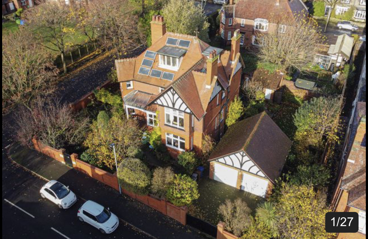

Yeah I don’t really want to use one but if we cannot get a toilet in thos main bathroom here then our only other option is totally moving the bathroom to another room on the right wall for the stack.
The downside of that is it will mess up all the house config really.
So have attached a photo which the main stack is about halway down on the right side wall just behind the garage. The main bathroom is currently just above the right side of the porch area on the front of the house where we woukd want the new toilet.

Thanks for the pic makes more sense ! Personally sticking a soil pipe along the outside wil not do anything positive for the look of your house ! It looks like there’s a path that goes down the side ? Concrete ?
Anyway if it was just a path my tuppenc worth would be to dig a trench lay a new soil pipe under ground connecting to the present one and put it where you want it .
Yes a pain having to dig a 45cm trench but a macerator will cost you £500 , they make a awful noise, get blocked and then you need a sparky to wire it in then you can look at installing it… I bet it will work out around the same (ish) to do the job right !

Yes there is a path that goes between the garage and side of the house and it is slabs so easy to take up.
I understand the concept of digging a trench on that side path to connect to the existing one but lost a bit on how that new soil pipe would then route to where the new toilet would be in the main bathroom?.
Cost and labour wise I am not as worried as like you say a macerator toilet would be a cost and not very good and our alternative of creating a new main bathroom in a room by the existing stack would mean all new plumbing for a bathroom so imagine all that will cost a bit so would save there

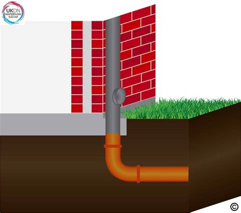

When you have it located in the trench you then bring a soil stack up from the the ground , Yes off through the wall

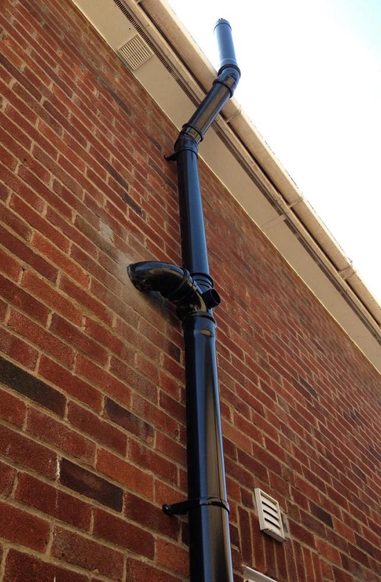

You don't have to take the soil pipe above the roof as long as you lol air valve on around 1.5 metres above highest water inlet
