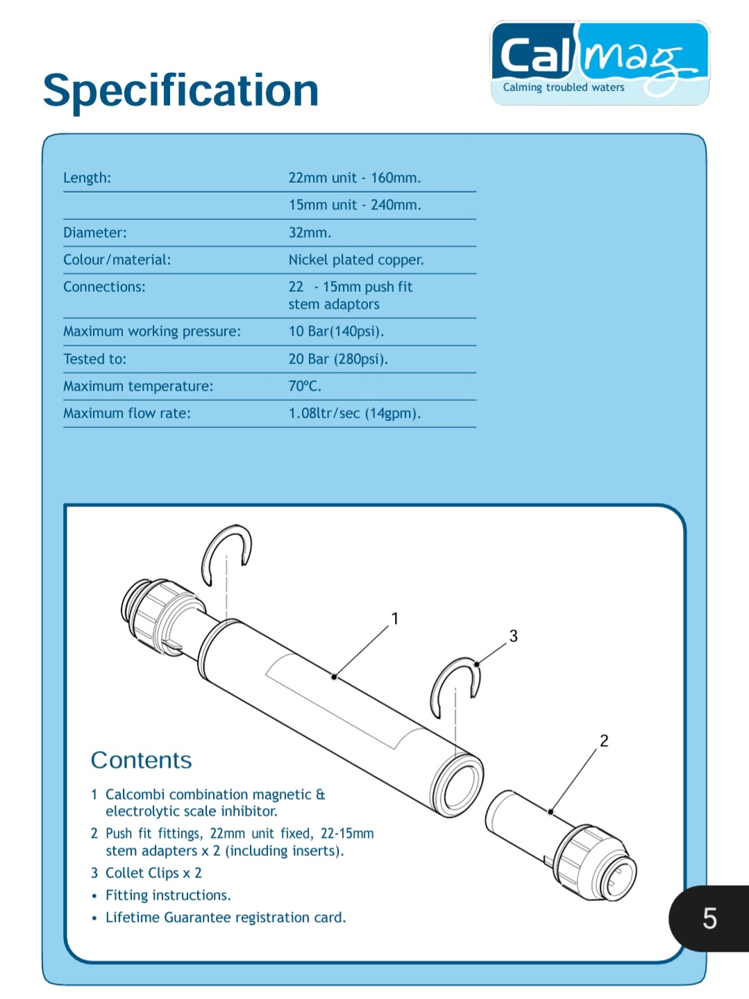

The CW inlet to the boiler has a "Cal Mag" inline scale inhibitor between the isolation valve and boiler.
Only difference between original and new CW water supply to the boiler is the magnetic descaler
Although most of the CalMag filters I can find have a maximum flow rate of 1l/s...

Its connected:
Mains ---> Main stop cock ---> boiler isolation valve ---> Cal mag scale inhibitor ---> boiler
As it seems to be the only difference in the setup, it may not take much effort to bypass it, just to rule it out as the issue?
Yes thats what I saw also - 1.08l/sec = ~65l/min so that is much higher than the supply.
Thanks - if no luck with Vaillant engineer then will try removing to see if it makes a difference.
Not sure if these are snake oil, but afaik its part of the compliance kit for the 10 yr warranty
