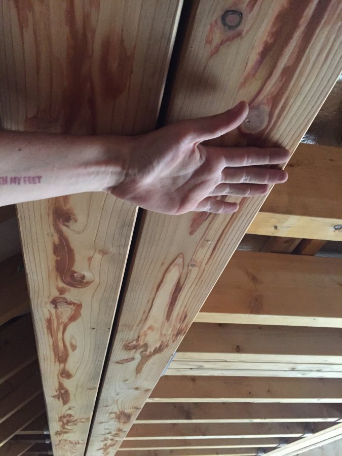

Exactly - the way I see it, too. In my house, there are multiple holes and notches all over the place, many in positions which would now be non-compliant - to add yet more, in the name of 'compliance' would, IMO, be crazy (even though it wouldn't matter much in most cases here, since many of them are enormous - many 9" x 3" or even 12" x 3" - they don't build house like wot they used to :-) )
Kind Regards, John
How d'ya like them timbers?!
