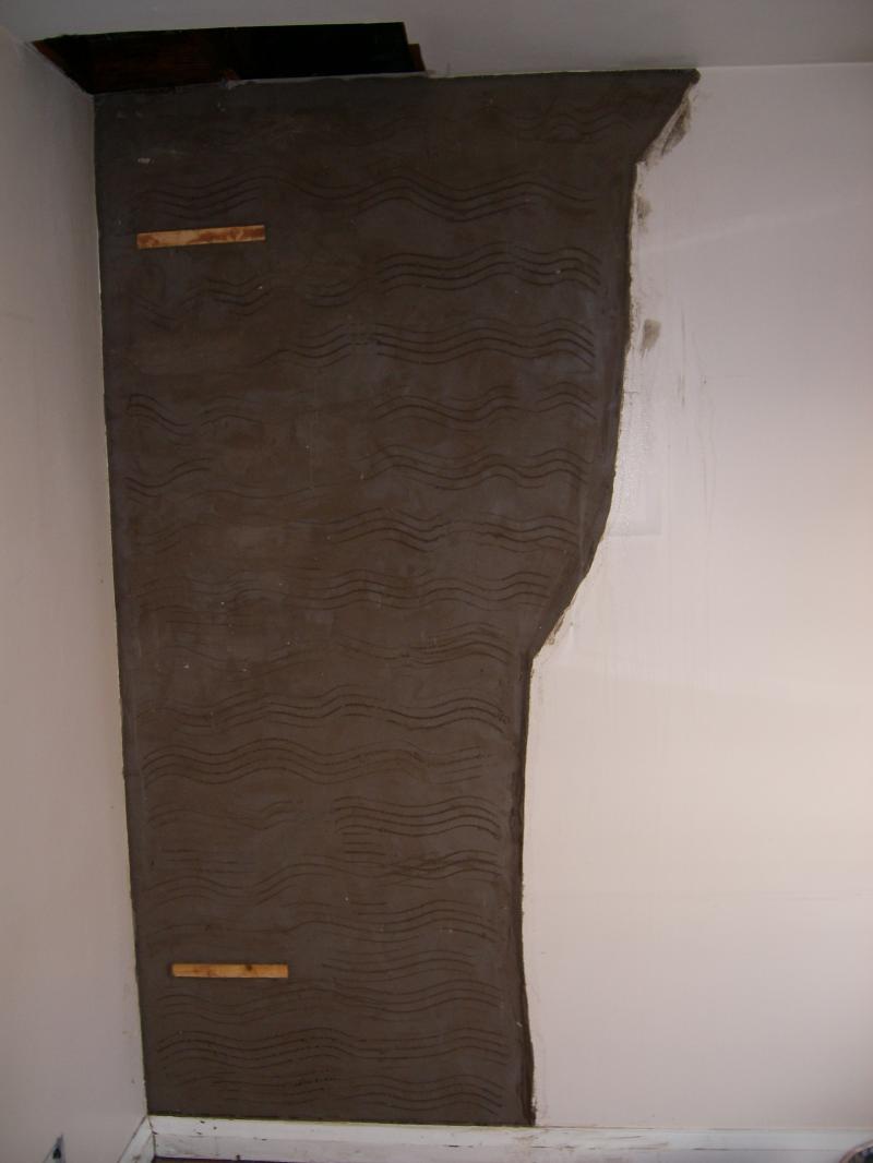

Well, I'd been a bit delayed but finally got round to doing my first scratch coat.
I tried the mixer in a flexi-bucket, but mix was too big.
So resorted to the polythene, that I had on reserve on your advice. :wink:
Worked a treat!!!
Many thanks Roy & guys.
A picture of the results, for a DIY I'm pleased :D
I wasn't sure if you normally run the screed between the dots to full thickness, when you do the scratch coat?
I didn't want it to slump, so erred on the side of caution and will do it in two.
Would like to know what the pros do tho.
