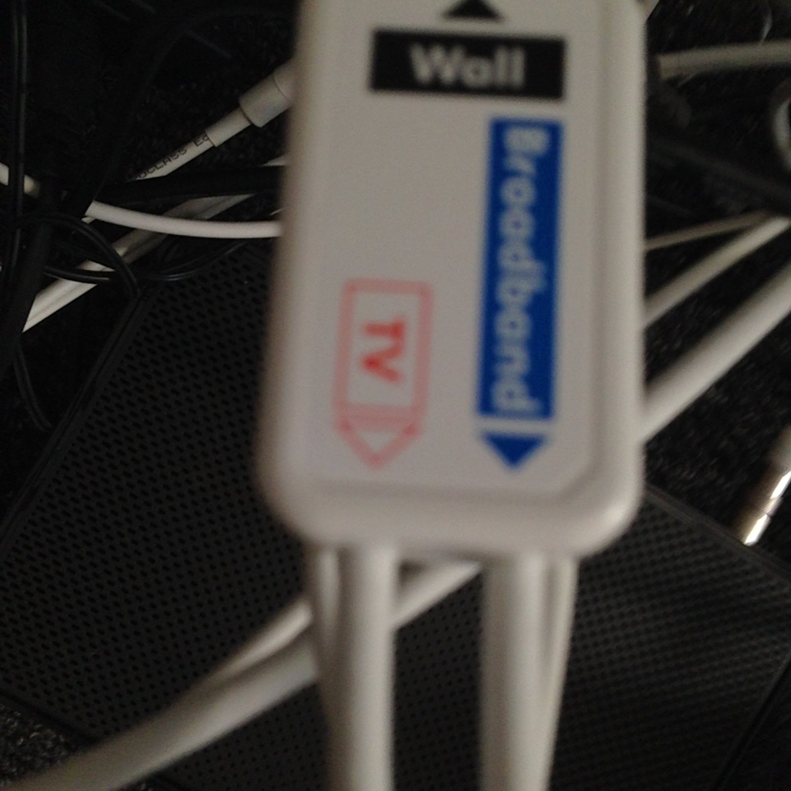

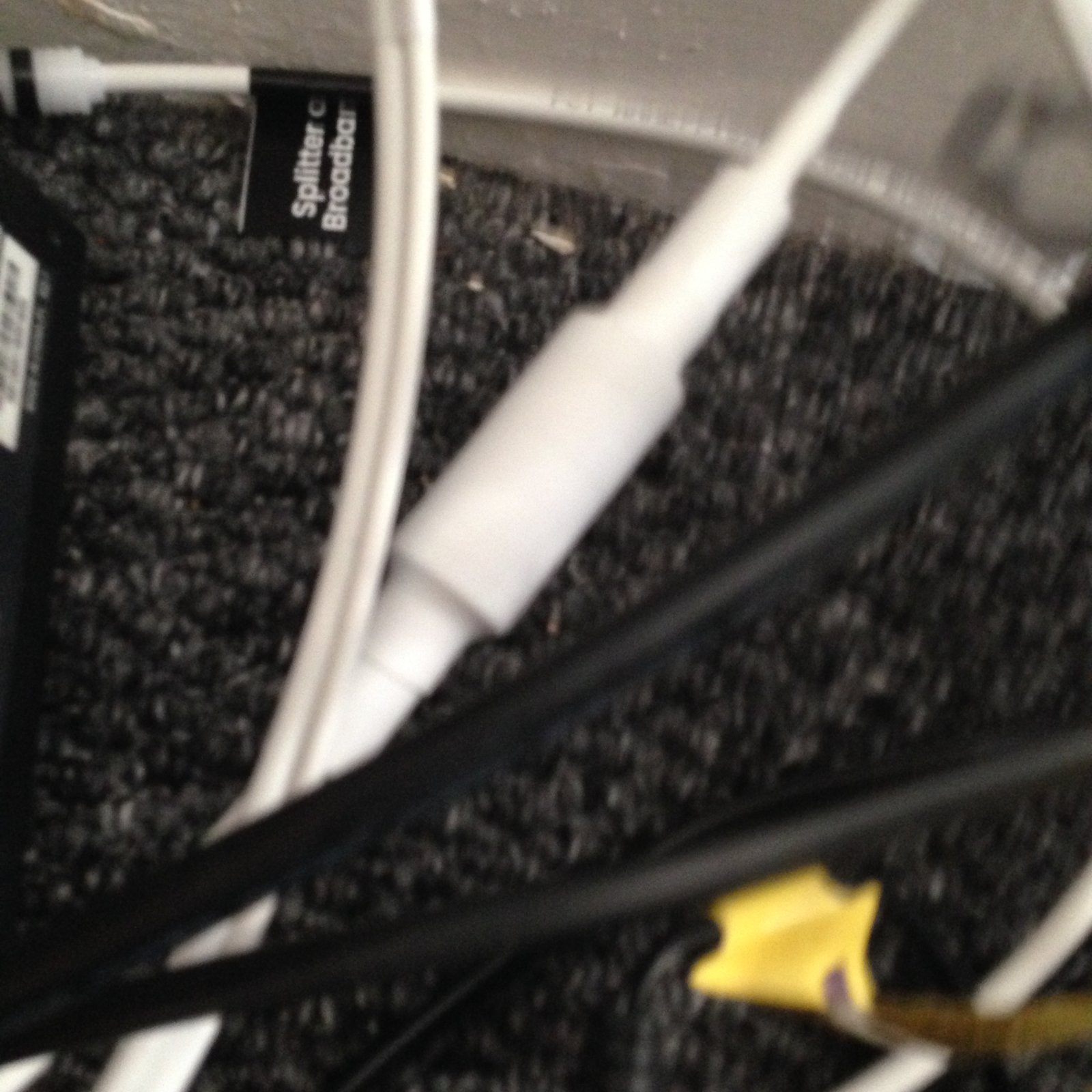

trying to help a lady at work
She has a virgin feed that terminates ona wallplate.
A lead then seems to go between here and a plug into a multiway breakout lead
I hope to shift it by about 4 metres so want to get a 5 m type F lead (I think)
Am I correct?
I am relying on her measurements as the idea is to buy then one visit to fit if I can
Only issue is that I don't know if it's male-male or male female.
Gonna try to add pix

Virgin is usually coax cable up to the splitter. The connections are the satellite type F connectors. The wall plate and plier will have the F sockets ( looks like a threaded bolt - same as socket on rear of Sky box). The cable will have the male plugs with the nut; again same as Sky sat cables.
What you'll need then is just a long male-to-male cable. Don't bother with extending the existing cable. Just replace as a single length from socket to splitter.
Be careful when looking for cable. Virgin uses a triple shielded coax cable rather than the double shielded used as TV/sat coax. The cheap sat extension kits from ebay are poor quality for double shielded cable. They're not up to it for this job.
Look for Webro HD100 cable. That's as- good-as or better-than Virgin spec.
The reason the cable is so important is three-fold. First, Virgin are putting a wide range of signals down their coax including data, so it's more sensitive to interference than sat or TV signals. Second, unlike TV or satellite, any cabled homes are hardwired to the network, and so interference has a path to other customers and the local hub. Third, Virgin gear is only ever on loan. Their Ts & Cs make it clear that the install including the cabling is theirs and not the customer's. If something a customer does to change the install then causes problems for themselves, other subscribers, or for VM then the company are entitled to charge to put it right.
Extending using a new cable to add an extra 5 or so metres really shouldn't be an issue unless bad cable is used or it is routed poorly. Just watch for bending the coax too sharply.

Just to close I have done this now. Quite simple once I realised that the mess of cables was a breakout
Mine is a simple coax to modem. No TiVo .
Hers was a short coax to breakout that went to the TiVo, modem, rj45
I managed to fix a 5 metre cable from the entry to skirting board, under a door frame and then into some trunking along a wall.
I connected it up first without moving anything to ensure that the cable run/length was ok.
