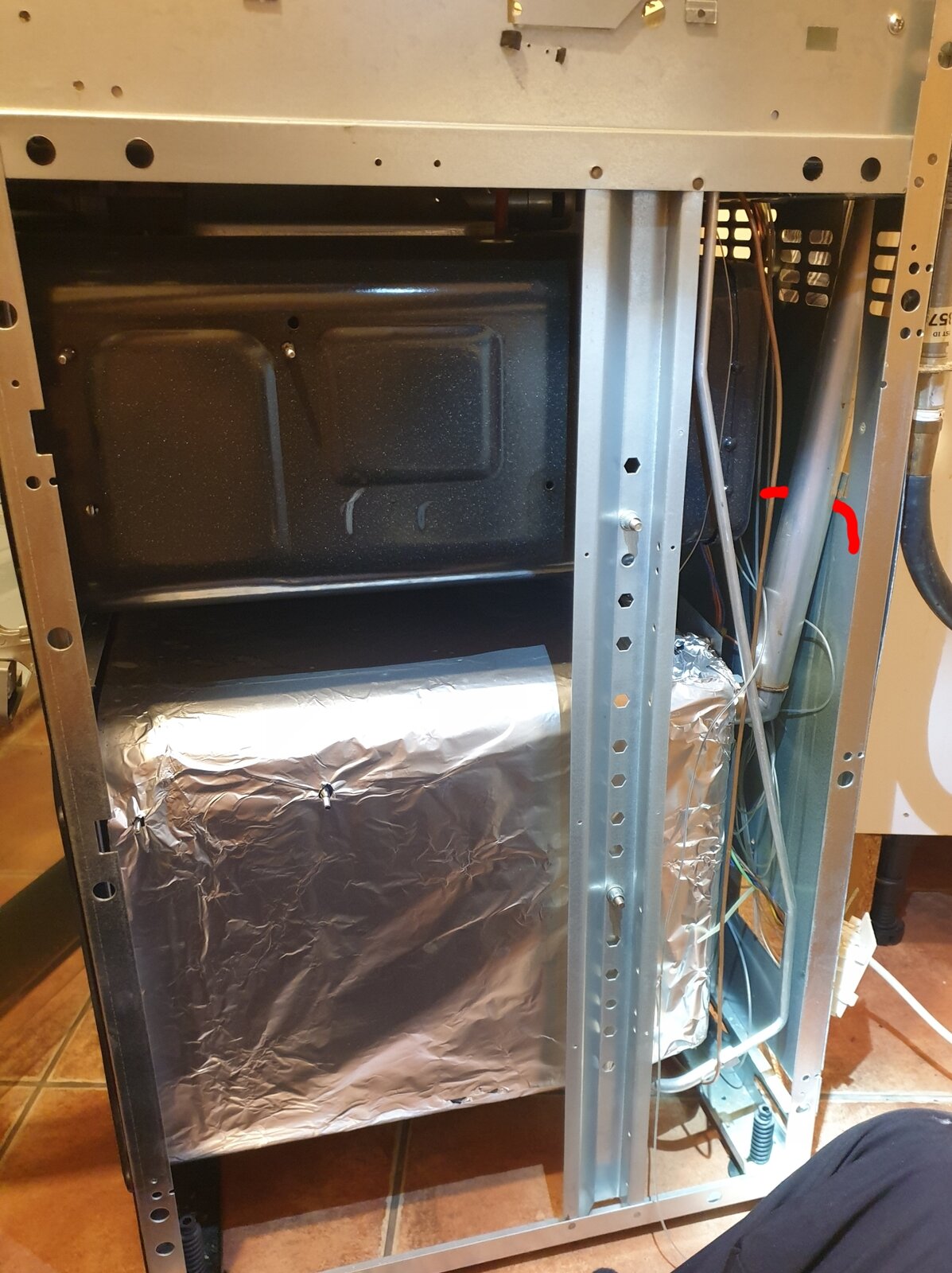

I don't know if I've broken the forum record here for how long I've taken to fix something... But over 7 years after my original post above, I've finally made the effort to fix the broken hob...

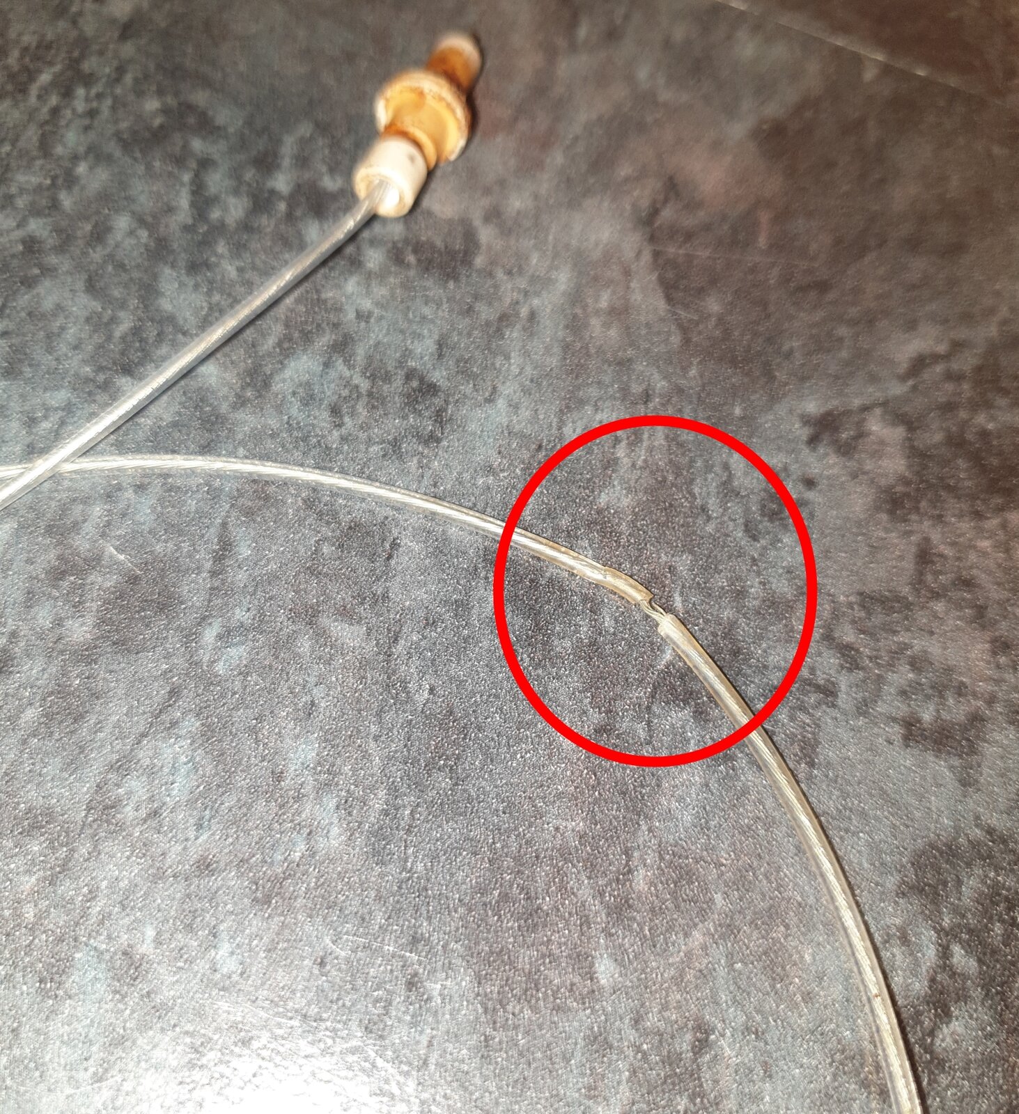

Turns out it wasn't me/water that broke it at all, the wire going to the sparker was tightly trapped between the cooker's back metal cover and one of the exhaust pipes (don't know if that's what they are really called). And it must have melted through the wire and broke the connection.
I had to flex the back cover away with some force to free the broken wire.
I bought a replacement sparker thing directly from Newworld, which came with the wire and I've routed it all correctly and now the cooker is fine.

Photos attached of the wire and the rust.
Look for the red drawn on bits.
Posting here for anyone that finds themself in a similar situation, obviously I'm not saying take your cooker apart but it could be that a wire has melted.
