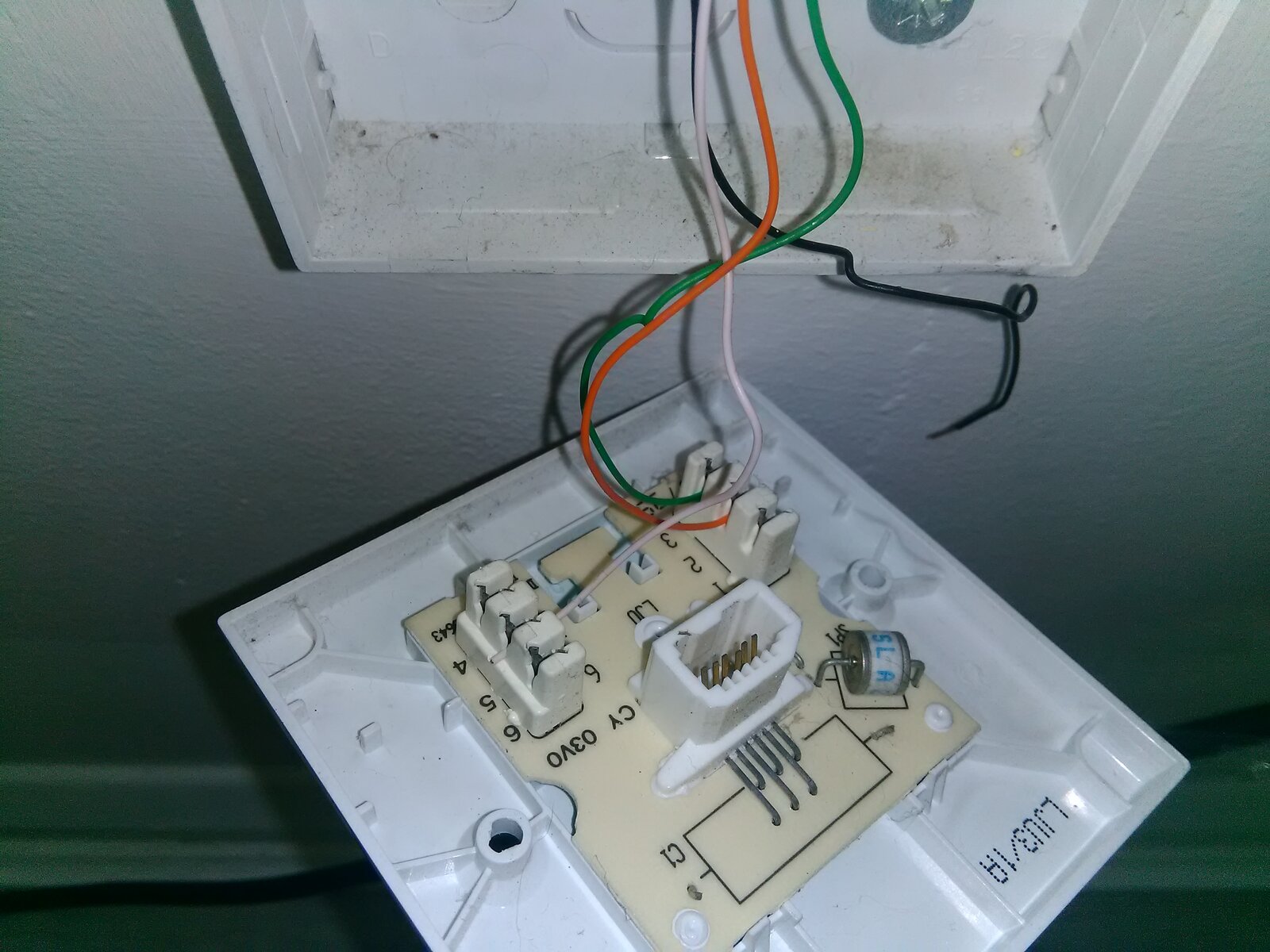

Hi i have an telephone extension upstairs, and i wanted to connect a talktalk hub there instead of downstairs in the hall but it doesn't work,i don't need it for telephone or anything else, i have opened the box and and there is orange 2 green 3 and white 5 and black not connected but i don't have blue.
any help would be much appreciated thank you in anticipation

Had to get my old notes out... Those cable colours are for external (Underground) cable; has a black sheath. If the other, upstairs, box has different colours then you have another box somewhere.
Internal cable is either Blue/Orange/Green/Brown (old type), or Blue-white/White-blue, Orange-White/White-Orange twisted in pairs, could also have Green-White/White-Green in off-white sheath.

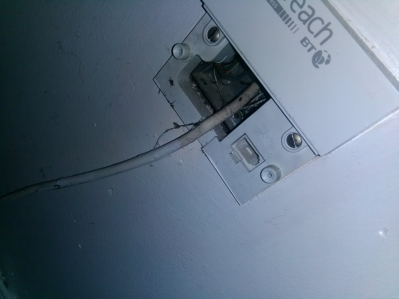

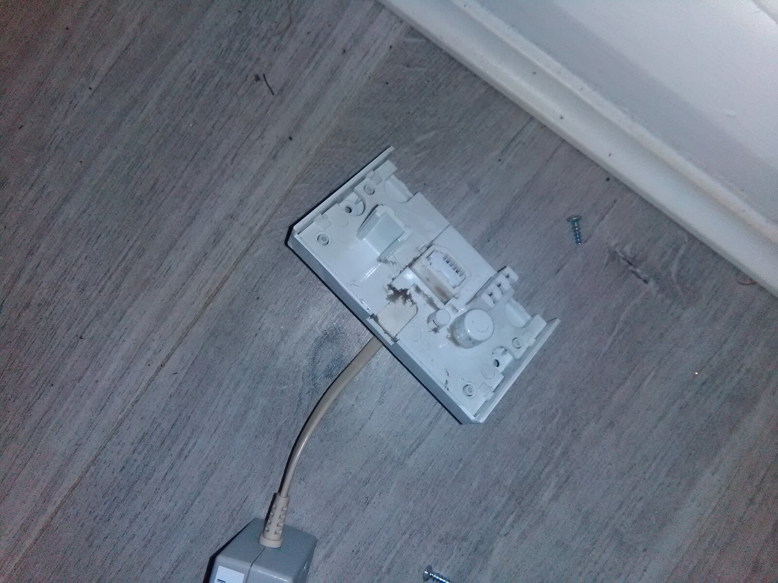

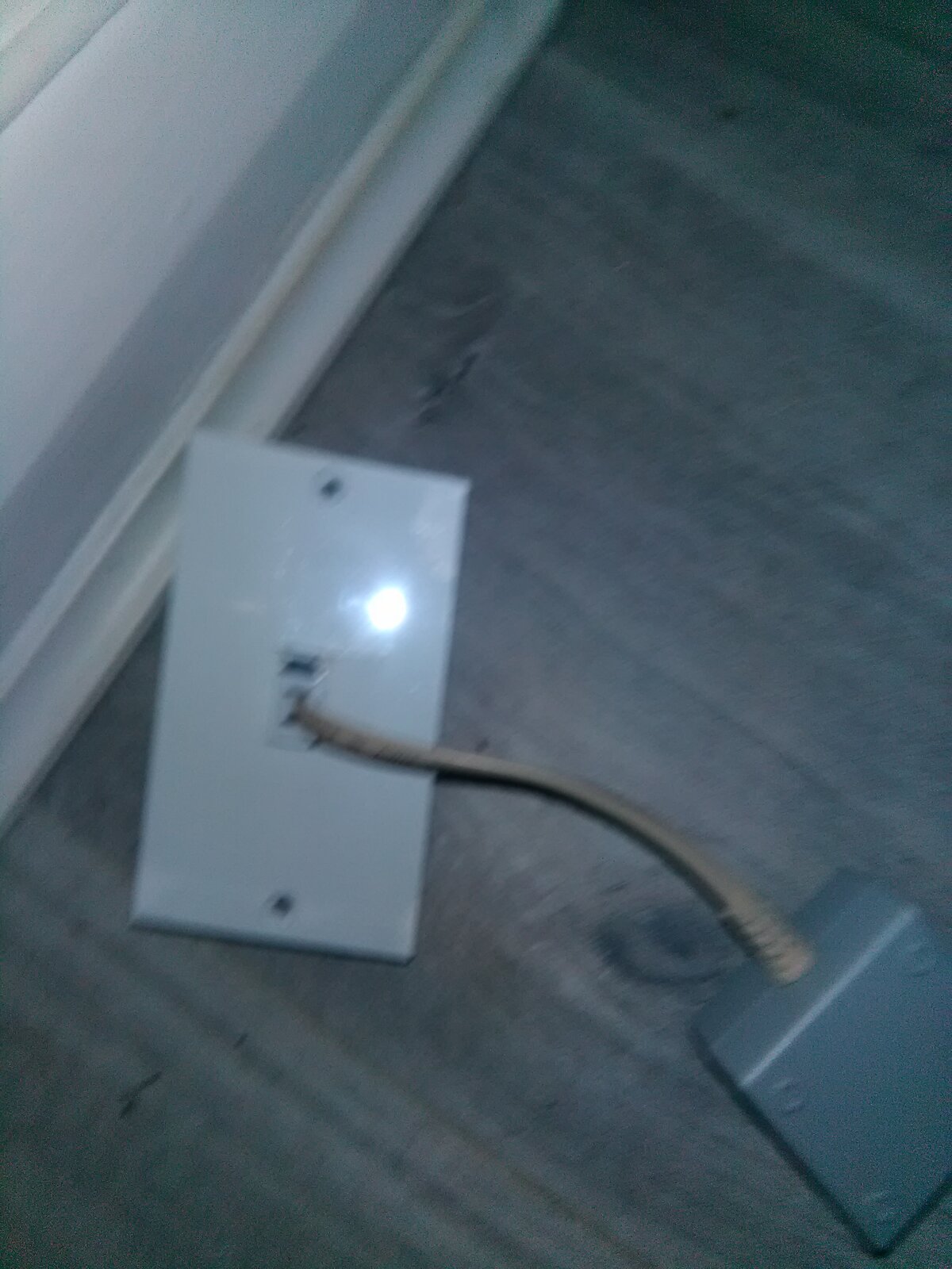

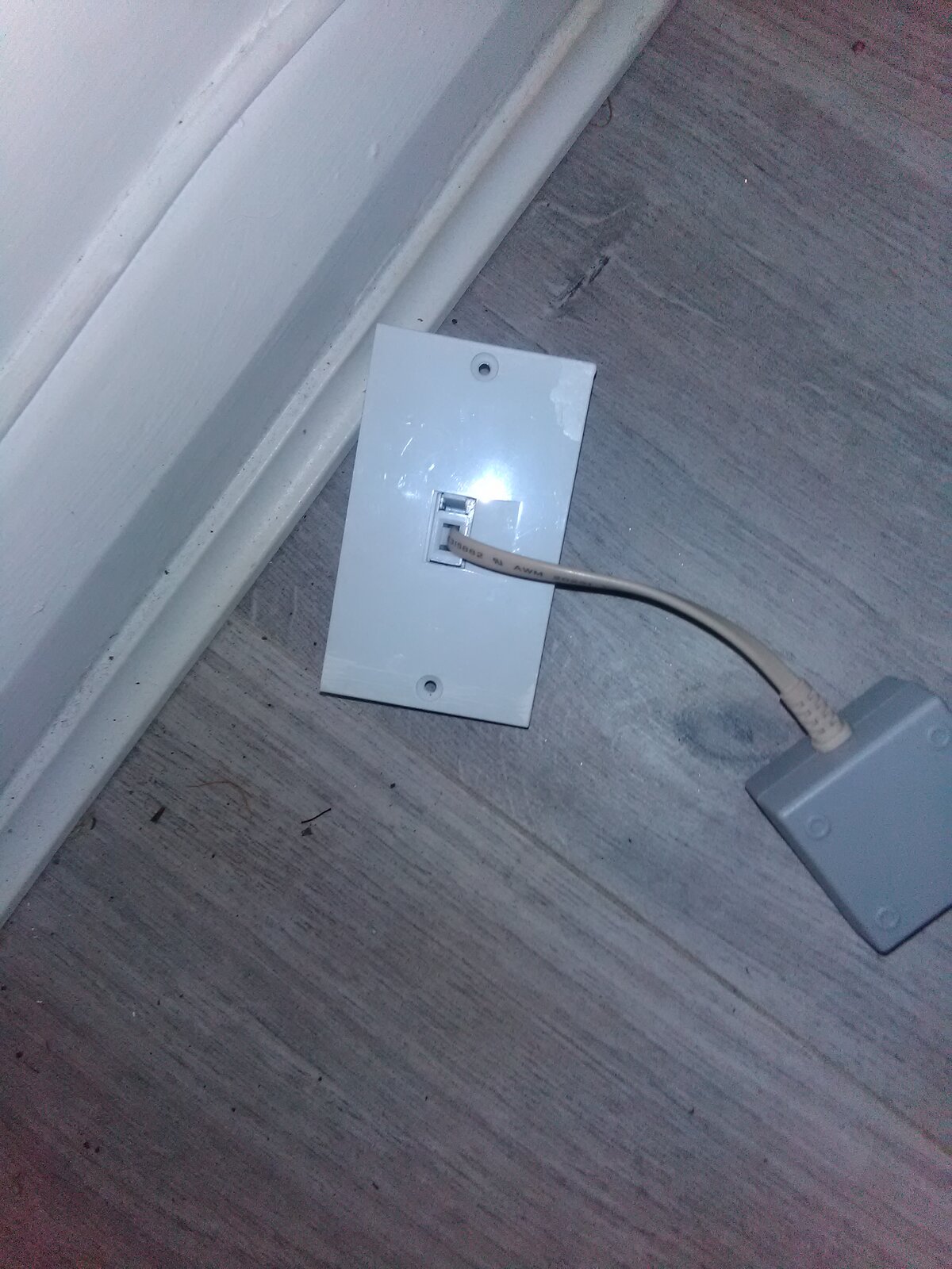

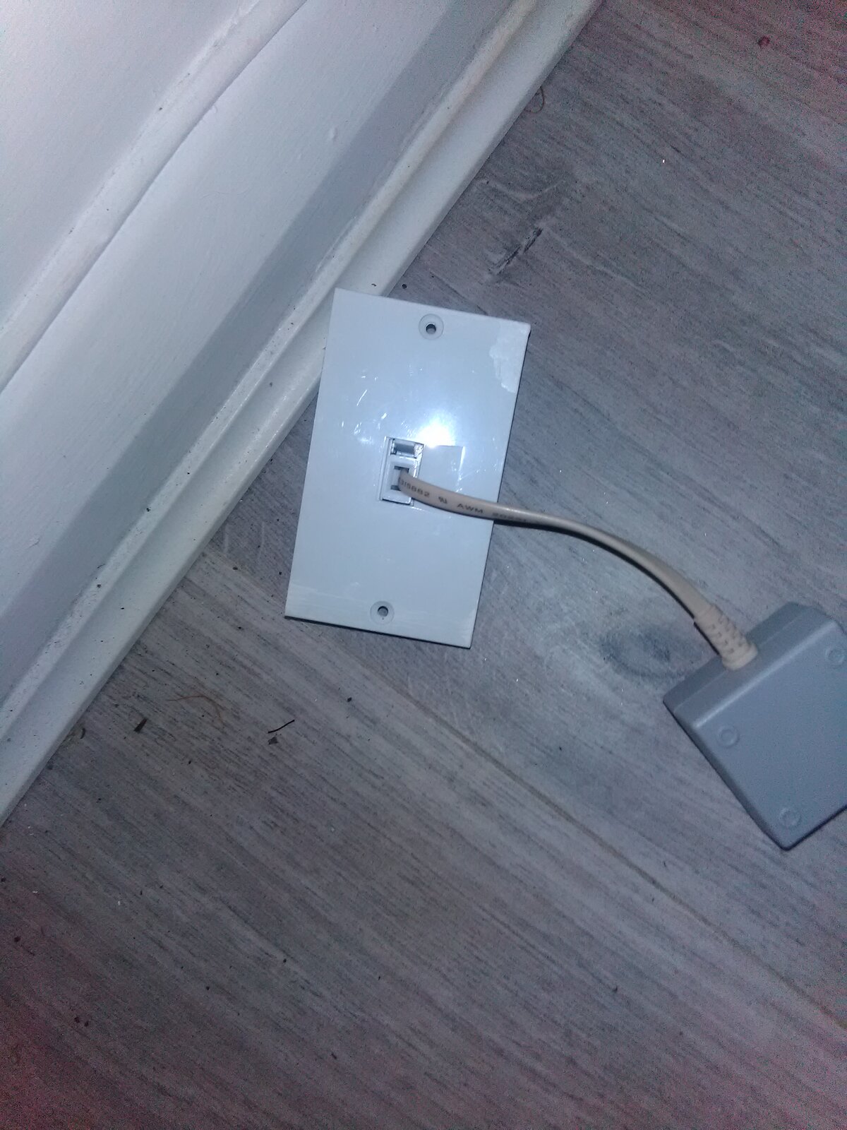

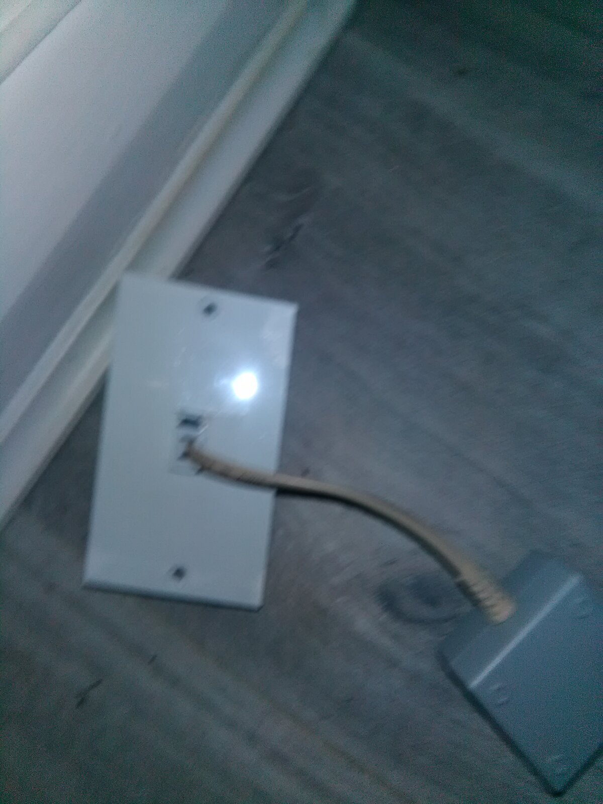

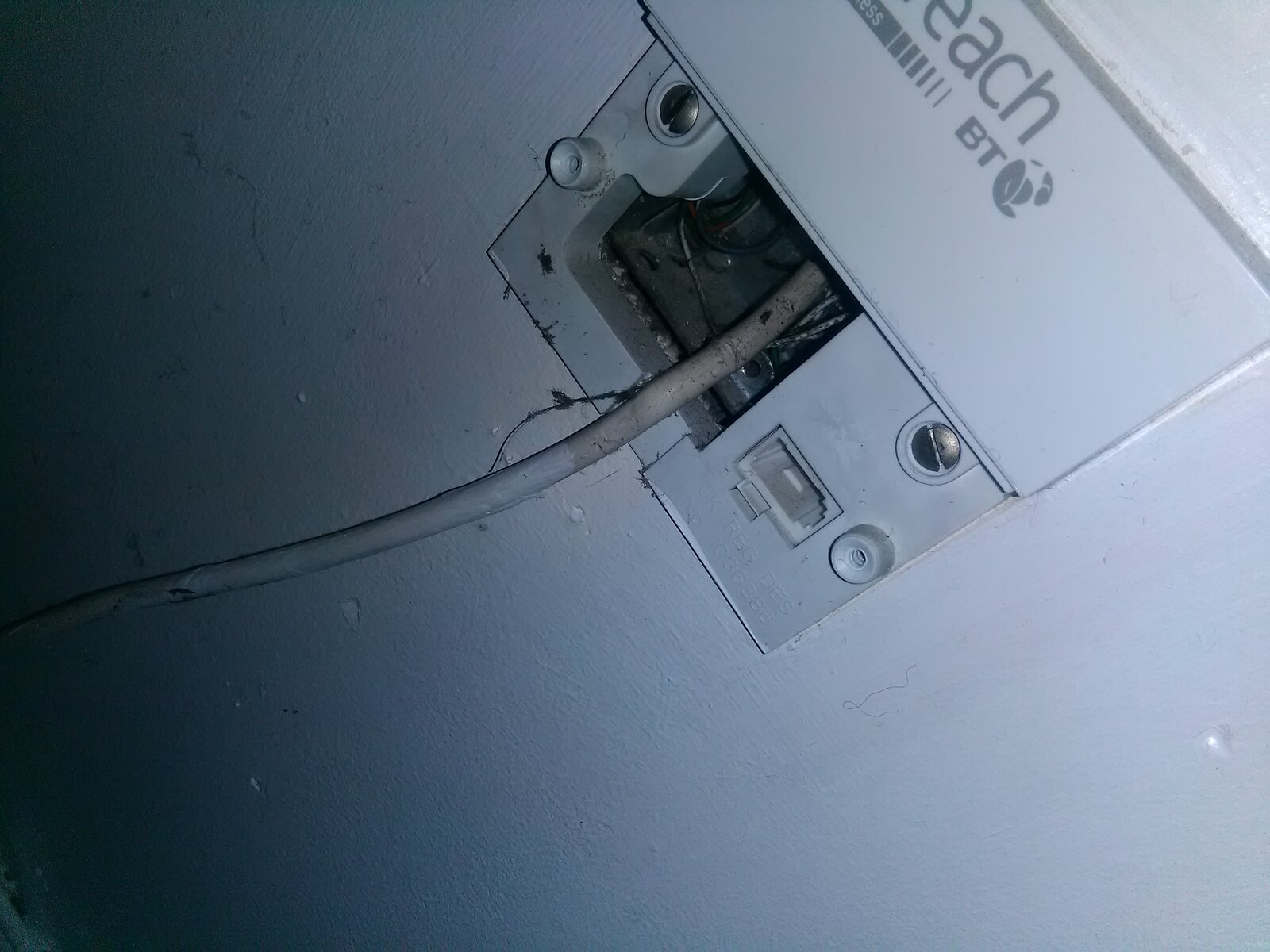

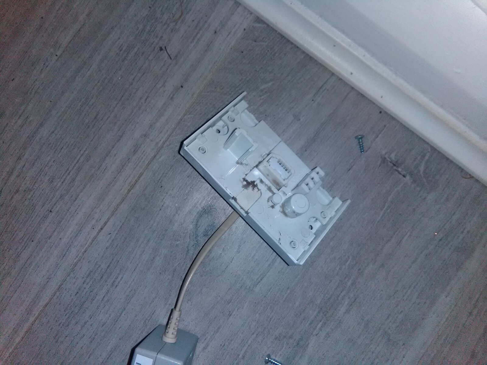

here are some photos of downstairs and up

So extension socket is wired with external cable.
The Master socket extension connections are ǹot connected.
Master socket looks to have filters but faceplate does not have RJ45 socket.
what colour wires are in the white cable going into master socket? Are such wires connected anywhere? Which colours?
To be honest - the wiring looks to be a total bodge.
