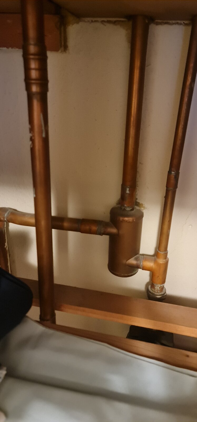

I looked in the cupboard where the immersion heater is (first floor).
The left hand side of the air separator is hot, as is the pipe coming out of the top. The pipe to the right runs down to the Grundfos pump and then (I assume) acts as the return from the two rads on the floor above. Next to the air separator, it is warm, but as you go up the pipe, it becomes colder.

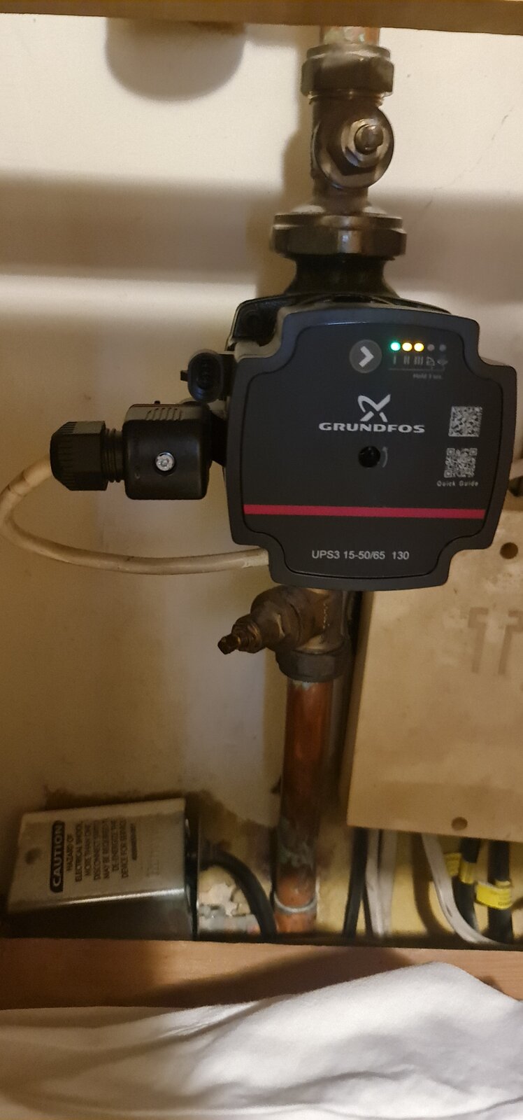

The next image is from below the Grundfos.
Any suggestions with regards to sorting this out? My experience of radiators is limited to combi systems.
