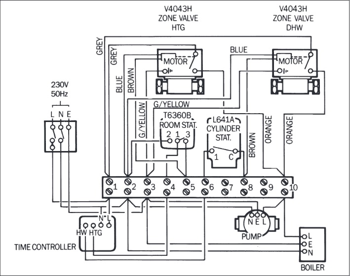

The C plan changed through the years, C-Plan_old2.jpg the original had no motorised valves, C-Plan.jpg and as time went on a tank thermostat and motorised valve was added, often as an after thought, and not always following a plan, S plan normally had two x two port valves, but my own central heating has motorised valve to stop central heating working but nothing on the domestic hot water because without the motorised valve in the summer it thermo syphons to up stairs rooms.
The early programmers were called 10/16 programs, and they had both a physical stop and an electric switch to set between the two modes, the way they counted 16 programs was a bit suspect 4 times 2 options both CH and DHW is how it was counted I would have counted that as 4.
It is not as bad as it first seems, as if the DHW is hot then thermo syphon is naturally reduced so it does not waste much energy really, at least in winter, the problem is in summer deciding how long to run the boiler for if there is not cylinder thermostat. C-Plan_old.jpg This was designed to allow you to leave heating on, and it would only fire up when required, the idea was without the pump running the central heating would not work, however in both first house and this house it did.

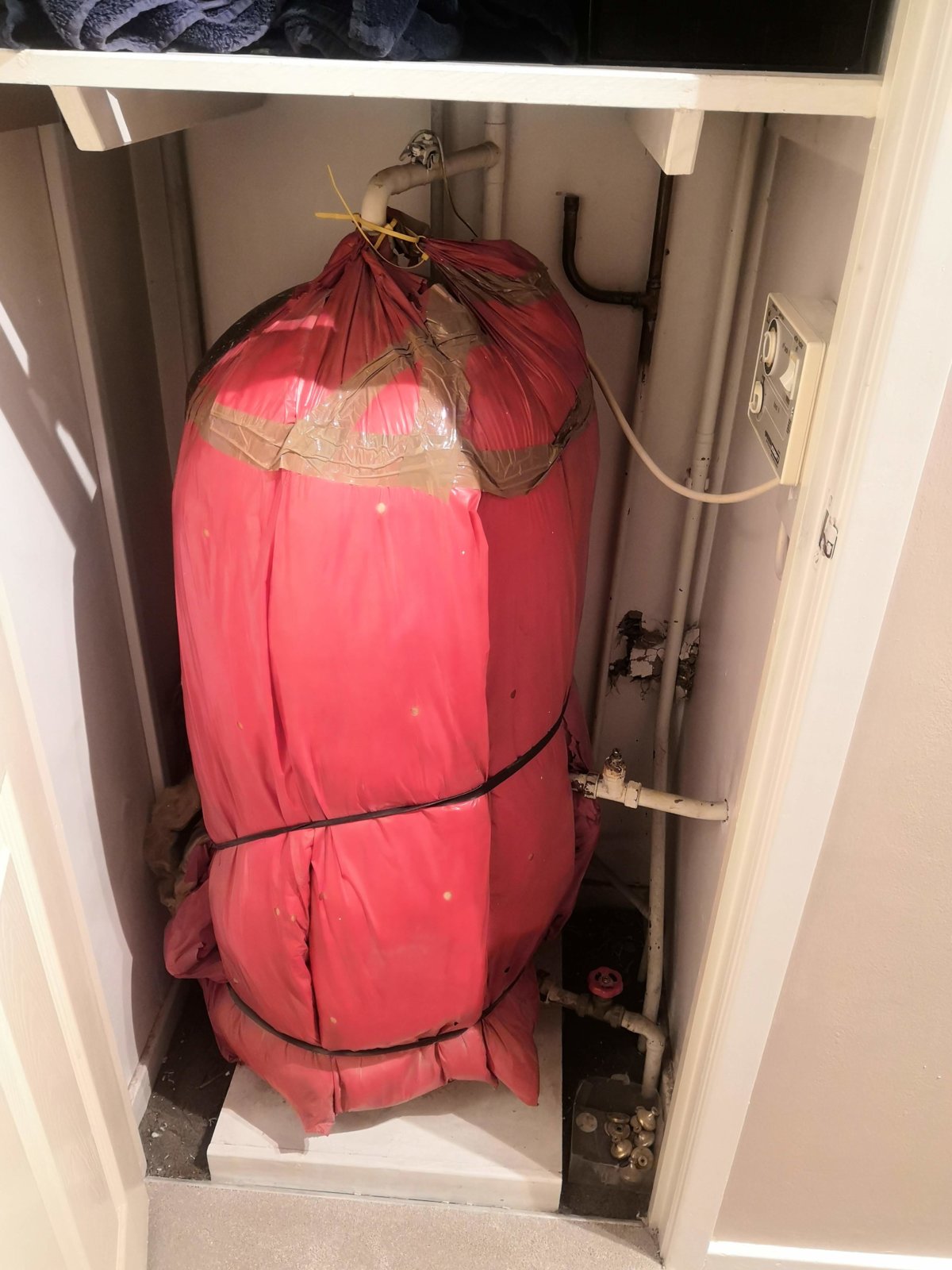

Here is a photo of my cylinder:

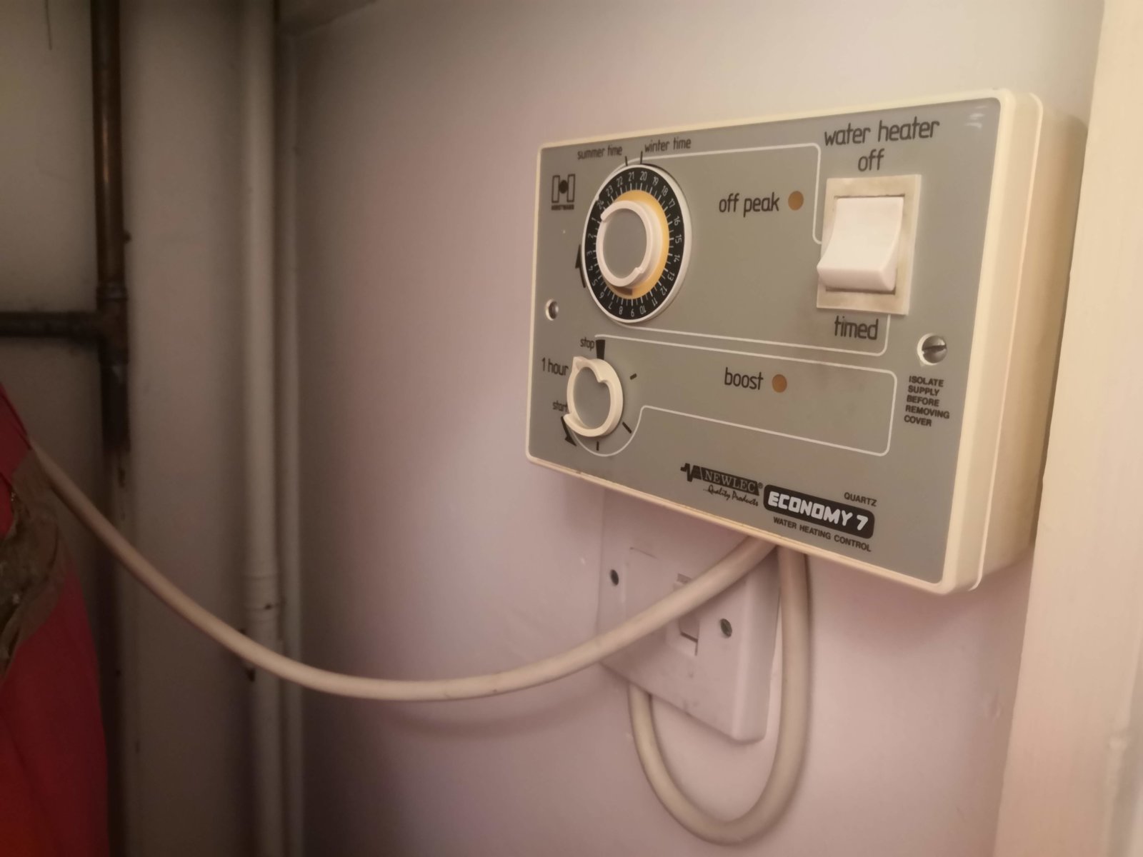

And there is a timer near it, i guess for an immersion heater?

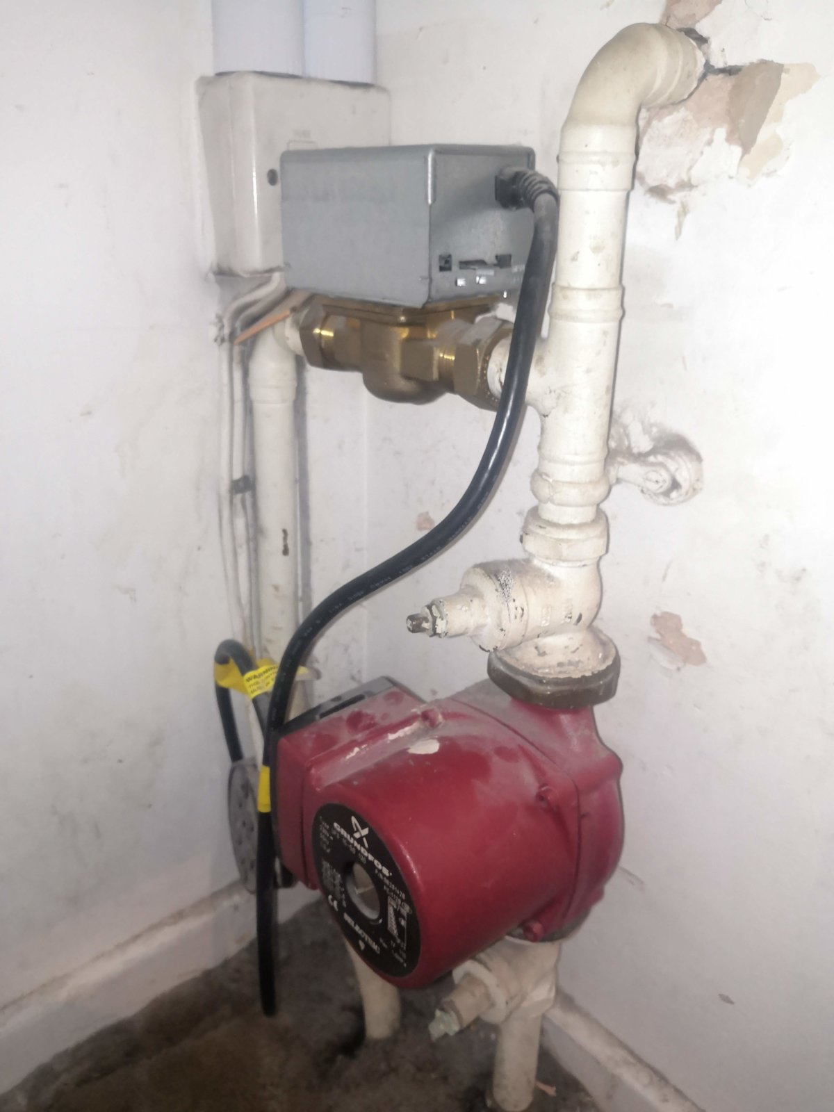

On the other side of the wall, there is another cupboard in the bathroom, which contains the following pump and motorized valve:
Yes timer is for immersion heater, and looking at the cylinder I see no thermostat, so like mine it seems you can only adjust DWH by controlling the time it runs for.
As to valve not sure what it does, it seems both DHW and CH is pumped but only one has any valve on it.
If you look at a standard S Plan S-Plan.jpg then the motorised valve works both as a valve and a relay, the orange wire from the valve powers the boiler and pump and also stops any back feed, but even if you fit a second motorised valve, the problem is getting the cables to the cylinder and adding a thermostat.

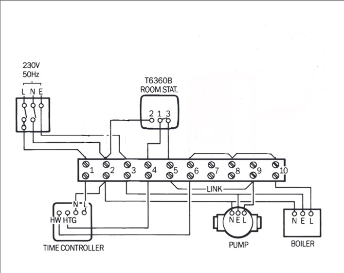

You don't have a C Plan, because:
1) The feed to the hot water cylinder would not go via the pump
2) The motorised valve would be in the branch feeding the hot water cylinder
3) A C-Plan would allow you to have independent control of the heating and hot water
It's difficult to be 100% certain when only part of the system is visible, but from your photos it would appear to me that the arrangement you have is this:

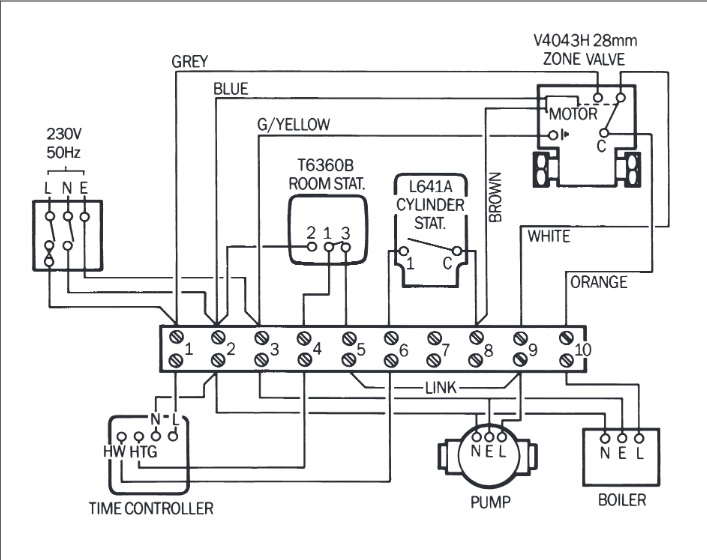

In which case @ericmark is quite correct there isn't a motorised valve to restrict flow to the hot water cylinder, and the single motorised valve is there to stop the radiators heating up when just the hot water is required. To get independent control of the heating and hot water a second motorised valve would be required, this would create what is known as a 'S-Plan' as below....

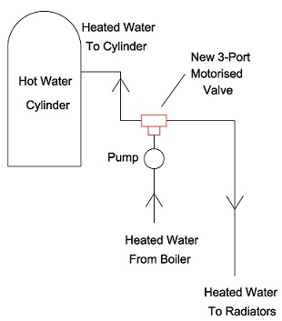

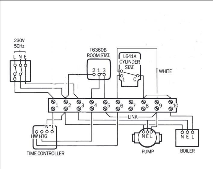

...or alternatively replace the existing 2-Port valve with a 3-Port one as below. This would create a 'Y-Plan'
That's the easy bit. Unfortunately then the system would then need to be rewired from scratch as below. The wiring of the two systems are similar, but there are subtle differences.
Thanks for all the useful info, I guess I have a "no-plan" system :D
It looks like as suspected, its just a limitation of the current plumbing, from thinking further about it and looking at Stem's diagrams, the motorized valve just stops the radiators from heating up when the programmer doesn't ask for it, but i'd need a valve on the other "side" (or a 3-port valve) in order to prevent the hot water cylinder from heating up.
