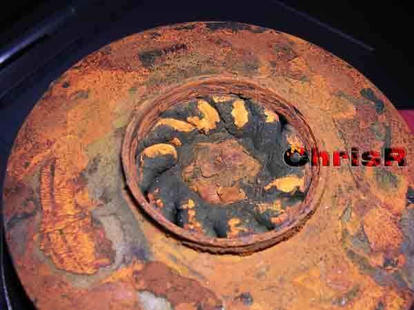

Pumps don't really suck or push , they develop a pressure between the ends...
When you disturb an old system they're often reluctant go as well as before. Air in the pipes is often the reason, but pumps can be only-just working and you may hardly notice it. They lose torque over time, and block up if the system's dirty.
This pump was taken out because its bearings were knackered,
whereas this one wasn't very old, was spinning at full speed, quietly, doing very little
