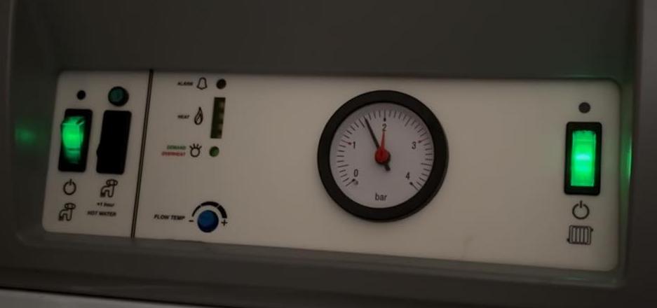

Pressure on gauge doesn't show its low.

From memory she would switched something on that boiler panel on etc & things would work but nothing this time.
Am I correct in that the controller on the wall is just for heating, if so then that's no reason why no hot water ?

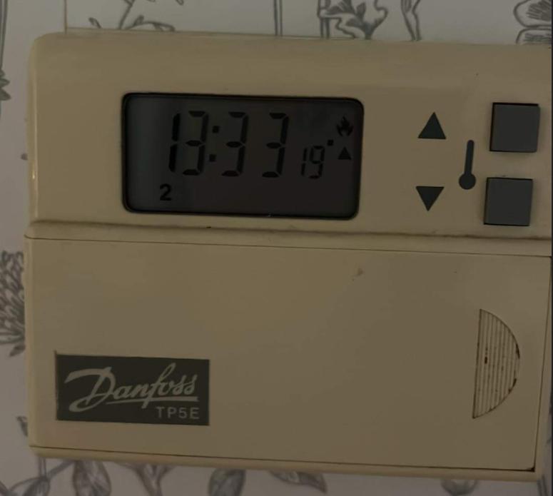

Some photos attached of what ive been sent.

Thermostat on wall is just an on off switch.
It's not my area of knowledge but it sounds like it could be a fault.
I think she needs to check thermostat is turned up as picture is showing 19c. Maybe 19c is the cut off so radiators won't warm up. It's been warm lately.

Thermostat in photo is just advising the type fitted. That photo was what she sent me last year & im using it to advise people what is fitted.
Either way that doesn’t answer why no hit water as I’m sure it’s only for heating.
Engineer wasn’t sure how the boiler worked & don’t think he looked at stat as that doesn’t do hot water.

Unfortunately old boilers don't have the ability to throw error codes
So confirm this.
Is that item on the wall for heating only & has nothing to do with hot water ?
Yes that’s just a thermostat for the heating. What is the make and model of the boiler?
Looking at it there could be a few faults. It’s coming up as a combined boiler and direct unvented cylinder. Seems the immersion elements may need checking, but it’s also designed to heat off peak with an optional boost facility. Regards the heating, check the pump. Bearing in mind, if this is in the U.K. then it needs to be a G3 registered engineer for the hot water side.
