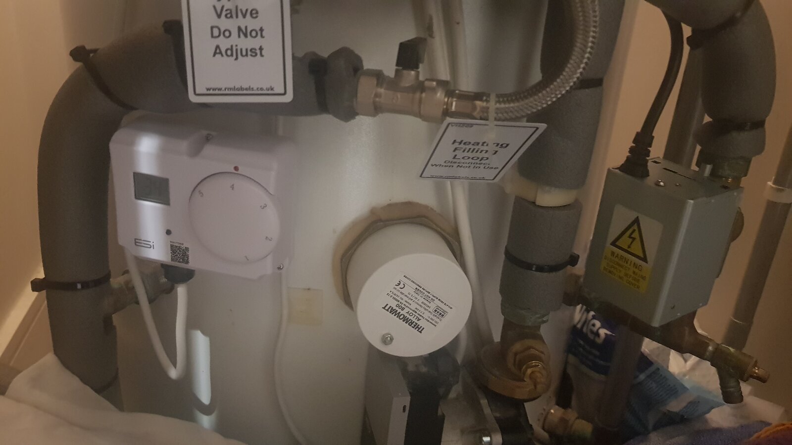

We are in a new build. Boiler 2 5 years old. We have gone through x3 zone controller valves and 2 thernostats. Our boiler is serviced annually- 2 months ago.
We have no hot water - thermostat on megaflow gets to 29 degrees and continues to click despite thermostat being set to 55 degrees. Esi thermostat and valve. Zone valve isnt moving- faulty?
Have we been unlucky with the valves or is there some other issue?
Any ideas on what this issue is - advice greatly received & appreciated!

It could be that you are unlucky, and I’d expect the valves to last at least 1/2 years, but some don’t. Might be worth getting them swapped for a decent brand.
Thanks for your advice. Is it easy to change to a different manufacturer? The plumber we had last time seemed unkeen to do this. Thanks!
It’s not uneasy, but not a 10 minute job either. It’s relatively easy for a G3 plumber.
I am wondering if our zone valves have been miss wired? I think the last plumber copied the previous wiring.
What would be a better replacement brand - honeywell?
Thanks for advice!
That looks like Honeywell, when the valve is not actuated, you should feel a fairly stiff resistance when you pull the manual lever across to latch the valve manually open, if the valve is already programmed open then you will feel no lever resistance.
1. Without a dimple on the cover, I suspect that is not a Honeywell valve but a "cheapo" look-alike.
2. I'd suggest getting it changed to a genuine Honeywell V4043 22mm compression valve. E.g. Screwfix 31480.
3. It's not a DIY job, and requires someone with a current membership of a recognised G3 accreditation body, such as Gas Safe or NAPIT.
4. It will require draining the boiler's primary circuit, which includes the central heating, unless the system can be "bunged" or frozen. Likely to be between 1 and 3 hours depending largely on accessibility.
It is an Esi zone valve not Honeywell, usually quite reliable to be honest.
OP what do you mean by cylinder thermostat "Clicking" do you mean it clicks when the temp is switching on and off, or clicking all the time ?

1. Its a two port valve, not a three port.
2. The advantage of a spring return valve is that it fails to closed.
3. An unvented hot water system requires a valve that fails closed.
