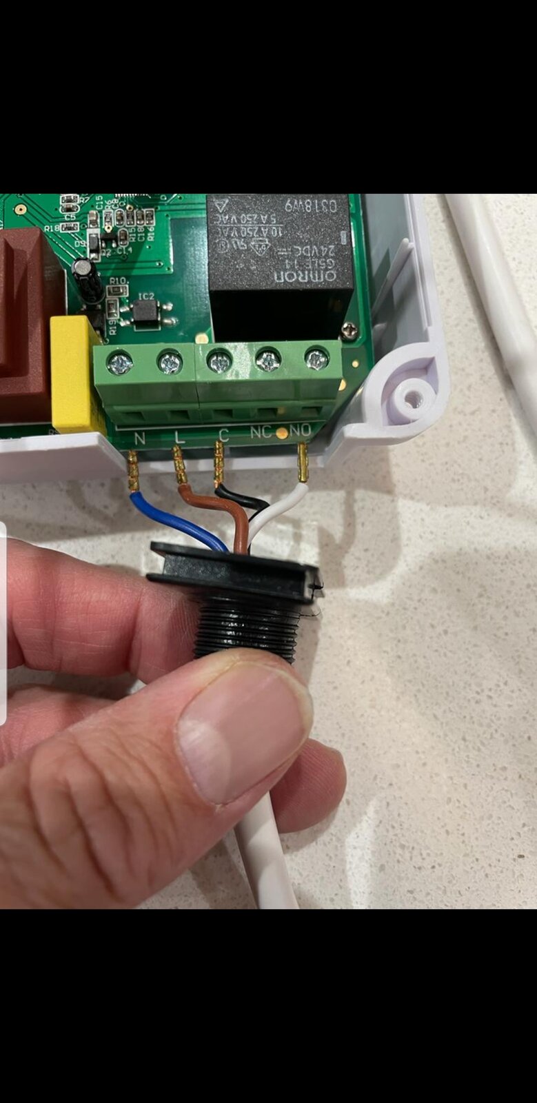

We've bought a Honeywell thermostat but are confused about how to wire this. The ESI thermostat cable connection has 4 wires but the Honeywell controller is designed to take 3.
I've attached a pic. Can anyone help with this? Thank you v much

It would help if you said which Honeywell thermostat you’re trying to install.
I haven’t worked on unvented cylinders before so there’s none I can recommend, but do an internet search for unvented cylinder thermostat and see the results. I’m not au fait with the rules, but some work on unvented cylinders must be performed by a G3 registered engineer.
