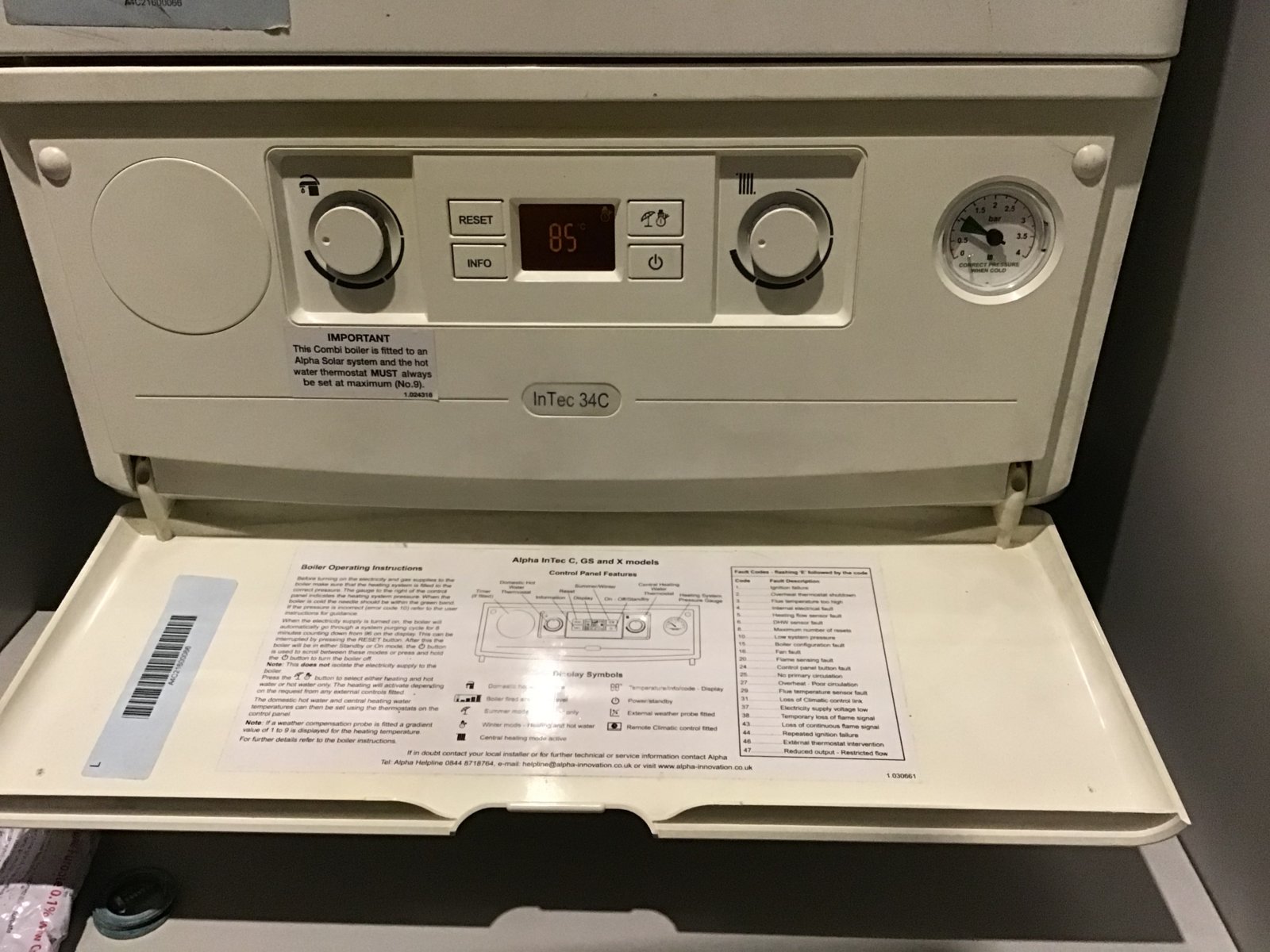

If you are happy to wait 11 days to resolve this then no worries but if you wish to get some hot water upstairs in the meantime, you presumably have a programmer of some sort with hot water & heating settings.
Put the hot water to constant and heating off. What does boiler do now?
It has a summer (water only) , winter setting (water and heating) these are on the boiler. The heating has two remote thermostats. One upstairs one downstairs. Not sure how to set the water to constant on it. It triggers as u turn on the tap. Or it’s supposed to but isn’t.

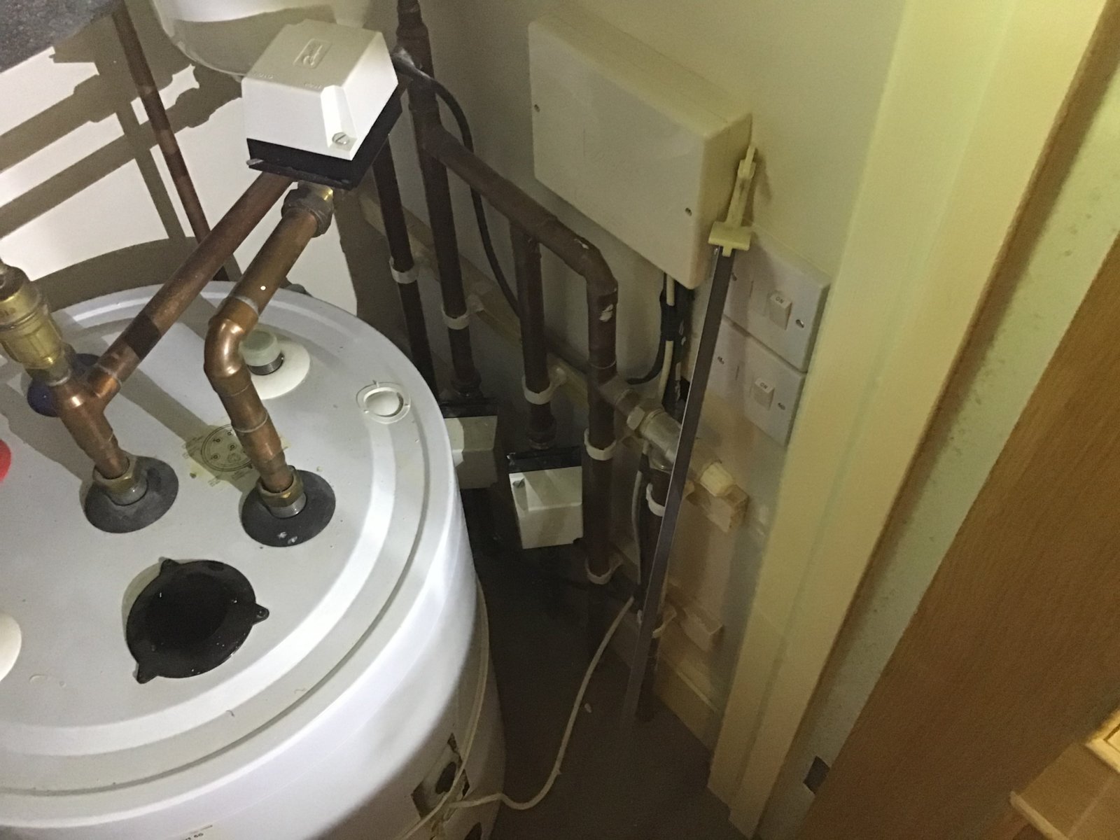

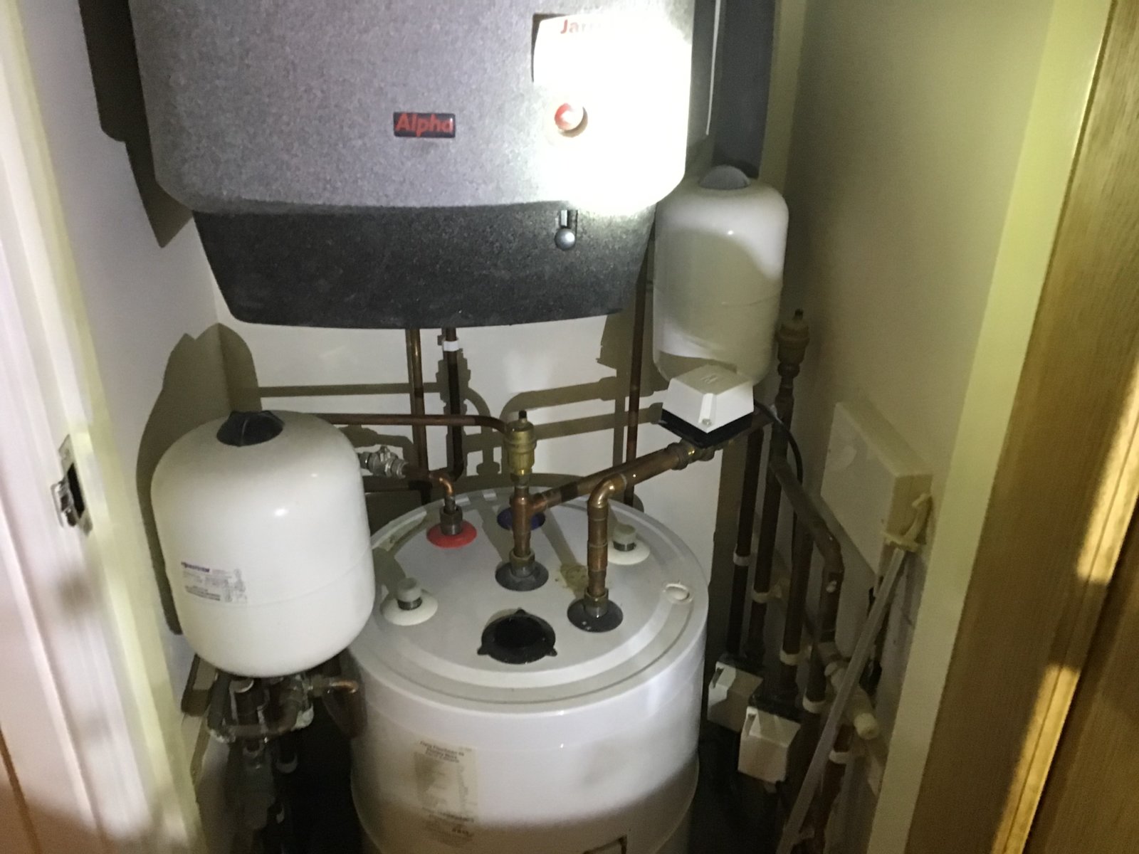

See if you can upload a photo of cylinder cupboard including the zone valves.
Here are two of the cylinder cupboard and one of boiler display. Cheers

So it appears you have a zone valve for the hot water, which should be connected to the programmer, find this, and you should be able to get hot water
There are 3 valves if I’m looking at the right things. How would I know which is the right one? The one on the cylinder? As the others are on the 22mm heating pipes?
The programmer? They connect into the box on the wall which I have maybe wrongly assumed is the point of supply. The water and heating is run from the main display I have pictured. The heating has two programmable thermostats. Nothing to programme water. Sorry to sound thick. But not sure how to do what u have suggested.
No you don’t sound thick. The box on the wall is a wiring centre, where all the wires connect. The one on the cylinder should be for the hot water, but will only come on with a programmer or thermostat (if heating).
The water only comes on when it’s called for by put in a tap or shower. There is no way to programme the water. Unlike the heating. I will mention what unsuggest it could be to the Jarrett heating engineer as it may save time though. Cheers.
If you manually open the valve on top of the cylinder using the little lever on the end, now put heating on, the 2 pipes on top of the cylinder should now get hot & your cylinder begin to heat up. This should allow you to get hot water upstairs for the time being. What do your 2 room thermostats look like?
Yes. The 2 pipes were hot last night as the heating was on.
I’ll try when I get in. Move the lever from left to right. I take it this should allow the valve to open to let the hot water in? So it’s likely that it’s this motorised valve that’s failed? Got to be worth a go. Thanks.
