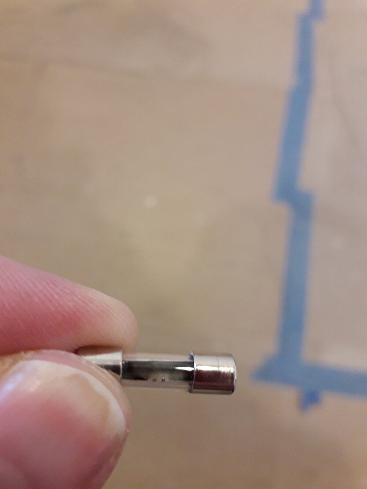

It's a long time but I have what appears to be the same problem with the same boiler.
It was working, now no lights showing. The clock appears briefly when I cycle the power.
No water flowing from hit taps.
Check power supply and there is electricity.
Did you resolve your problem? Any diagnosis?

I am not a plumber.
https://www.ferroli.com/media/1506956360.pdf
scroll through to the fault finding section.
I think there is a 2 amp internal fuse on the PCB (I briefly scanned the PDF). In my limited experience, they will blow if something like the pump/etc develops a fault. Years ago my fuse blew. I went to Halfords to buy a hand full of the small glass fuses. I disconnected a number of potential possible faulty components one at a time. I would then put a new fuse in, turn on the combi and see if the internal fuse blew again. In my case, the only time the fuse didn't blow was when the grunfloss pump was removed. I replaced the pump, fitted a new fuse and the boiler worked. I didn't have access to the fault finding diagram in those days.
Best of luck.
While you were answering, thank you for that, I was checking that. See pictures on original post.
Yes, the small 3A onboard fuse has gone.
When I replaced it I am getting the right hand side power/pressure light on green. No response to on/off or reset.
There is no water from hot tap. If you leave it off, it slowly fills so there appears to be some when you open it.
There is another thread that suggests shorting out the timer to bypass the timer relay. I'm not particularly keen on that.
Is really want to see if I can find what is causing the fuse to blow to asses if it's a repair or replace job.
