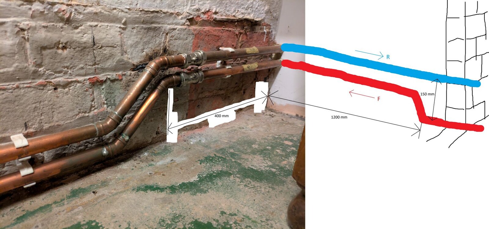

About this time last year, I installed some lovely new cast iron rads, replacing the previous old skool skirting heating. The strange piping takes some explaining so bear with.
The original pipes come out of a wall sketched on the right hand side of the pic. I needed to run new pipes behind plasterboard to get the wall plastered and do the rads later, and so guessed (wrongly) their position by bringing the flow up to meet the return and temporarily terminating with ball valves* so I could re-prime the system. When the rads arrived, I realised they needed to be much lower, so I rerouted both down. This means that the for aound 1.6 m, the flow pipe is elevated from the rest of the circuit by 150 mm. Short of cutting open the newly finished wall, there's not a lot I could do about this. So I thought I would just suck it and see.
The noise I get is a kind of clicking, tapping, dripping noise (no gurgling) which occurs about 20 mins after turning on the CH. I have balanced the rads and turned the pump down to minimum flow as I understand old pumps can let in air. The rads heat up evenly and quickly and, most importantly, they do not let out any air when bled!
Do we think I have air trapped in this raised section and is there anything that can be done that doesn't involve cutting into the wall? Surely once the system is primed, no new air should be let in?
or do I need to rebalance my rads properly?

*I have kept the ball valves as I will need to drain this heating circuit again to fit rads into the last room. This will allow me to do this without draining the whole house. Once it is all complete, I will probably remove them.
