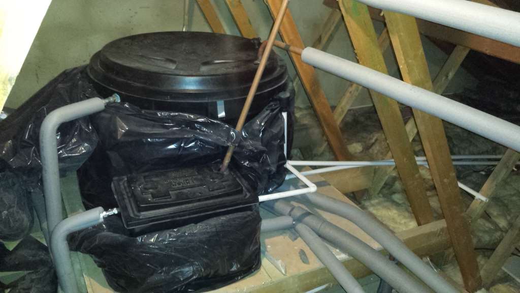

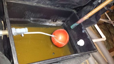

If you sit next to the small loft tank when the boiler is turned on and off and on, what happens? How deep is the water in it, and what happens when you press down the orange float?

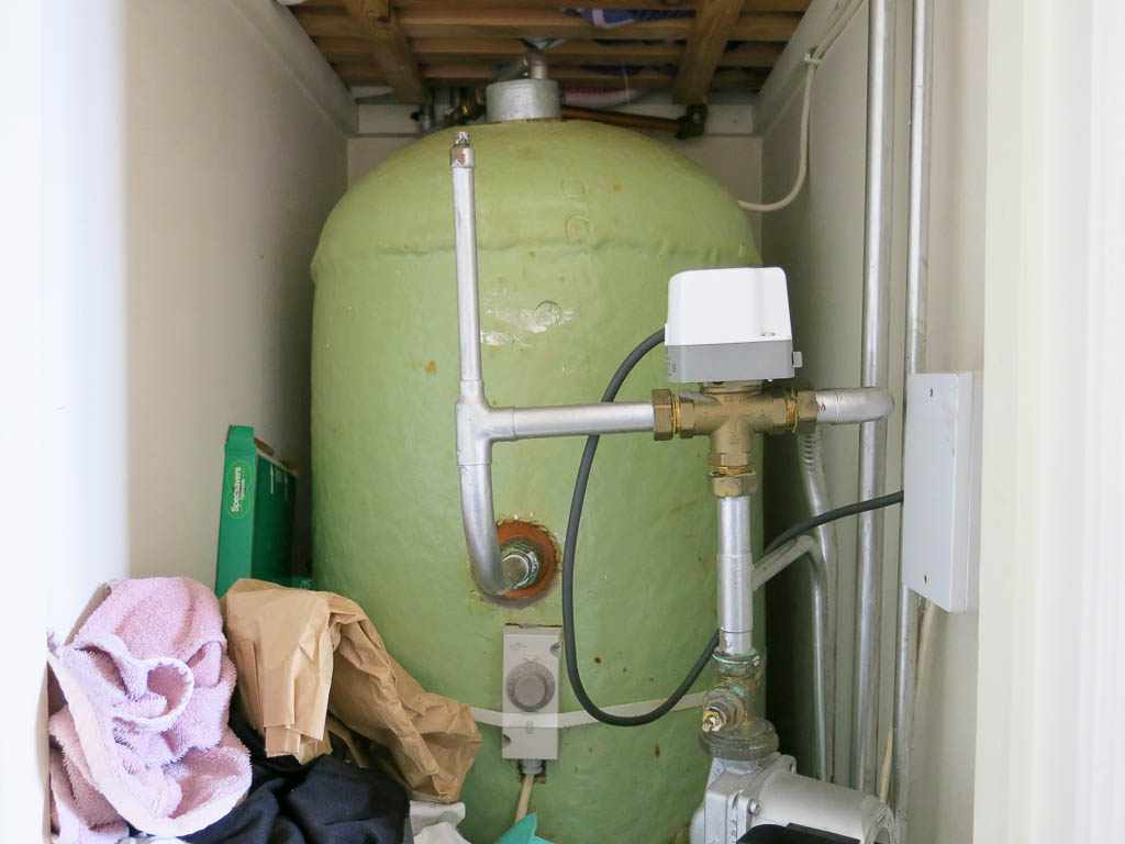

Some further checks to make...
There is a bypass branch between the pump and 3 port valve, locate a valve on this pipe and check if it is open or closed.
This valve must be set for a minimum water flow of 9 litres/min through the boiler ideally via 4 metres of 22mm pipe between flow and return boiler connections.
This bypass valve setting can greatly affect the water flow noise level especially if set too far open.
Check also that the pump is wired directly to the boiler terminal block.
Another component to check is the 3port valve to make sure it is functioning properly - could be that flow to CH is not being shut off fully when there is no demand for it!
looking at the F and E tank water looks very dirty/brownish colour and looks low to me .

If you sit next to the small loft tank when the boiler is turned on and off and on, what happens? How deep is the water in it, Will check tomorrow. and what happens when you press down the orange float? Water comes out the valve outlet as it should, stops when the float is released.

Check also that the pump is wired directly to the boiler terminal block. Pump, 3-way valve and hot water tank thermostat all go to the junction box on the wall, terminal block inside.
sorry had another look ,looks like loads of sediment in tank.Is there ? Water is clean but yes there is some sediment in the tank.

For this to occur at the time of year when demand for central heating lessens, I would start with the 3 port valve. Isolate the electrics, remove the head and manually manipulate the valve pin (it has very little oscillation but should be easily moveable by forefinger and thumb), lubricate as necessary. Then move on to the (actuator) electrical head and check that is operating as designed - you can google how to prove this, if not - replace the head.
Check this first to eliminate it from further enquires - as they say on crime watch :sneaky:
