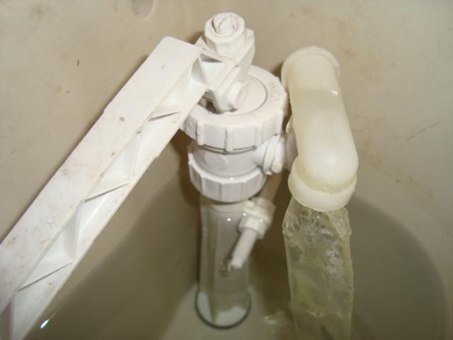

Noisy toilet valve - is it the diaphragm?
12 Jun 2009
2
London
The flush works fine and there is no leaking but after refilling there is usually (75% of the time) a terrible juddering noise from the valve which causes vibrations throughout the pipes. A plumber replaced the diaphragm six months ago and for a couple of months it was ok. Should I just replace the diaphragm again or get a new valve such as the Fluidmaster Bottom Entry Fill Valve? Is it easy for a DIYer to do? This is a new-build flat on the 11th floor.
Picture of valve:
You turn off the water supply to it grip the body and undo the large fluted ring. change the diaphragm, put it back together tight, re-establish water supply and test.
If it leaks turn off water and have another go.
If it continues to leak obtain a new bottom entry valve.
If it continues to leak call a plumber and flush what you do with a bucket of water while you wait.
Thanks very much, I'll start by replacing the diaphragm. Do you know if it's common for them to 'fail' like this after only a few months?

Try a Torbeck type float valve. Will be a much quieter operation and more reliable as your not solely relying on a rubber washer to seal but also the water pressure at that level.
